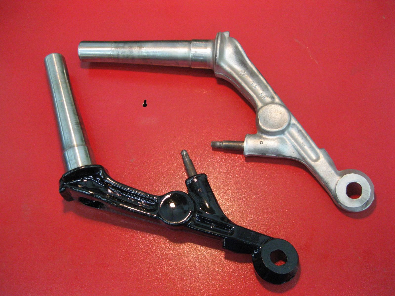

So two additional beams were sourced, disassembled, and using the best parts, every thing was cleaned, repainted, restored:
(using a handy tool to reconnect the refurbished spindles)

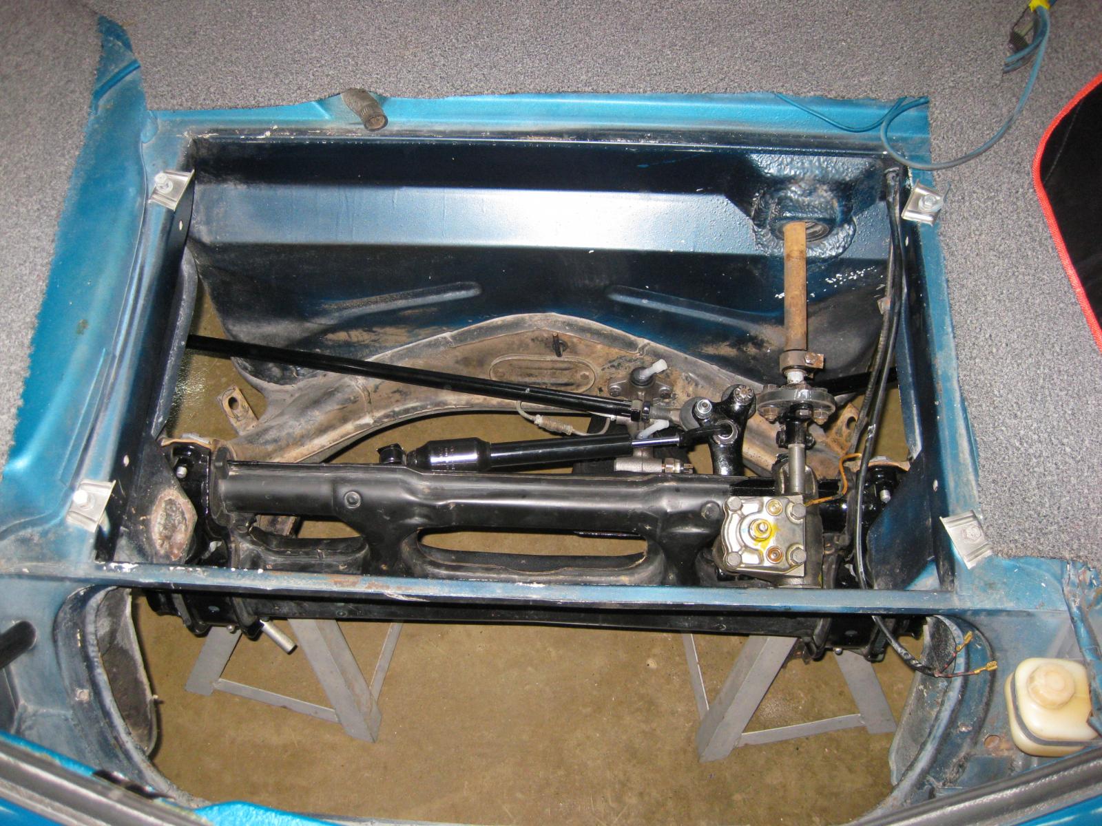

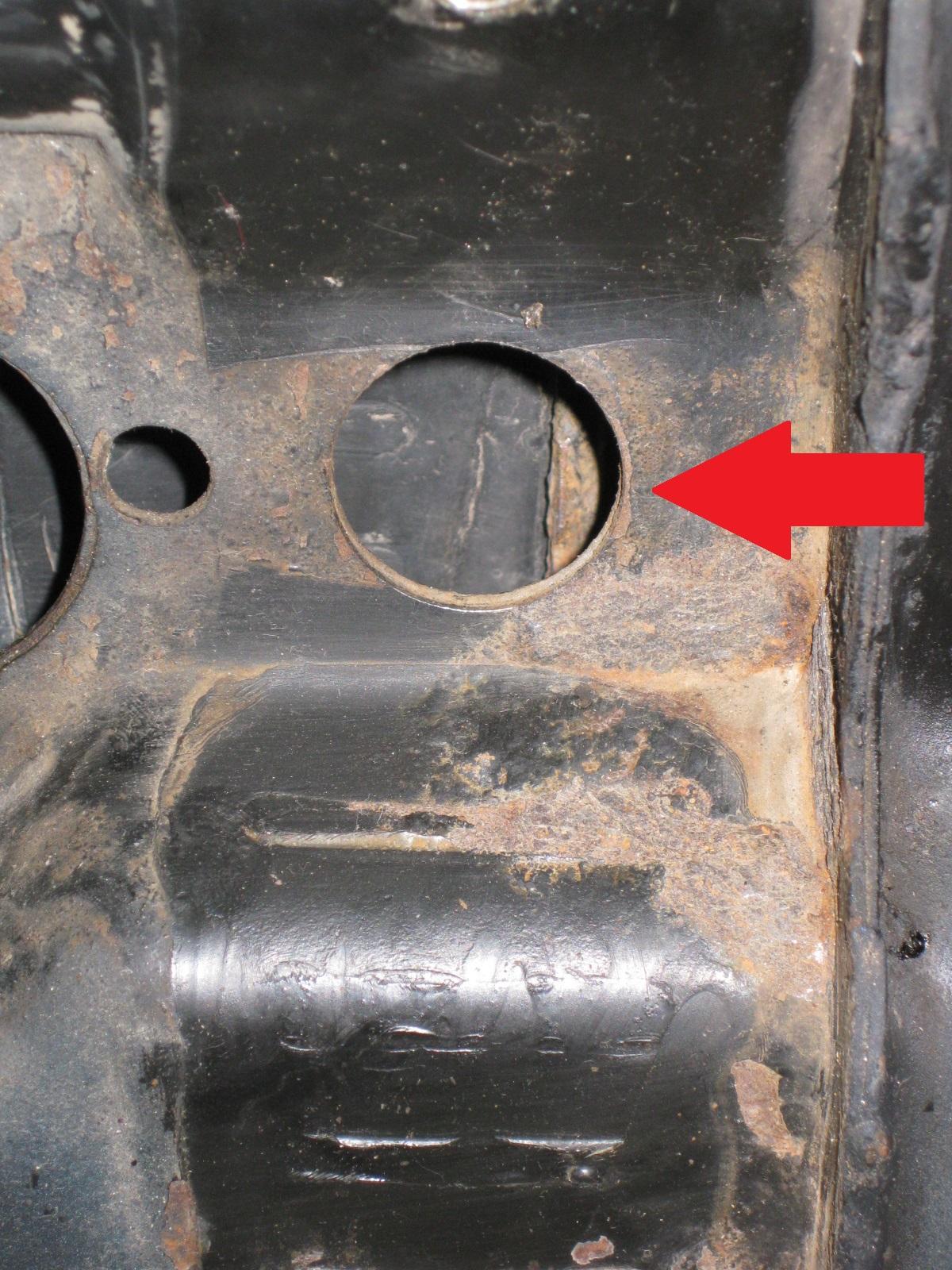

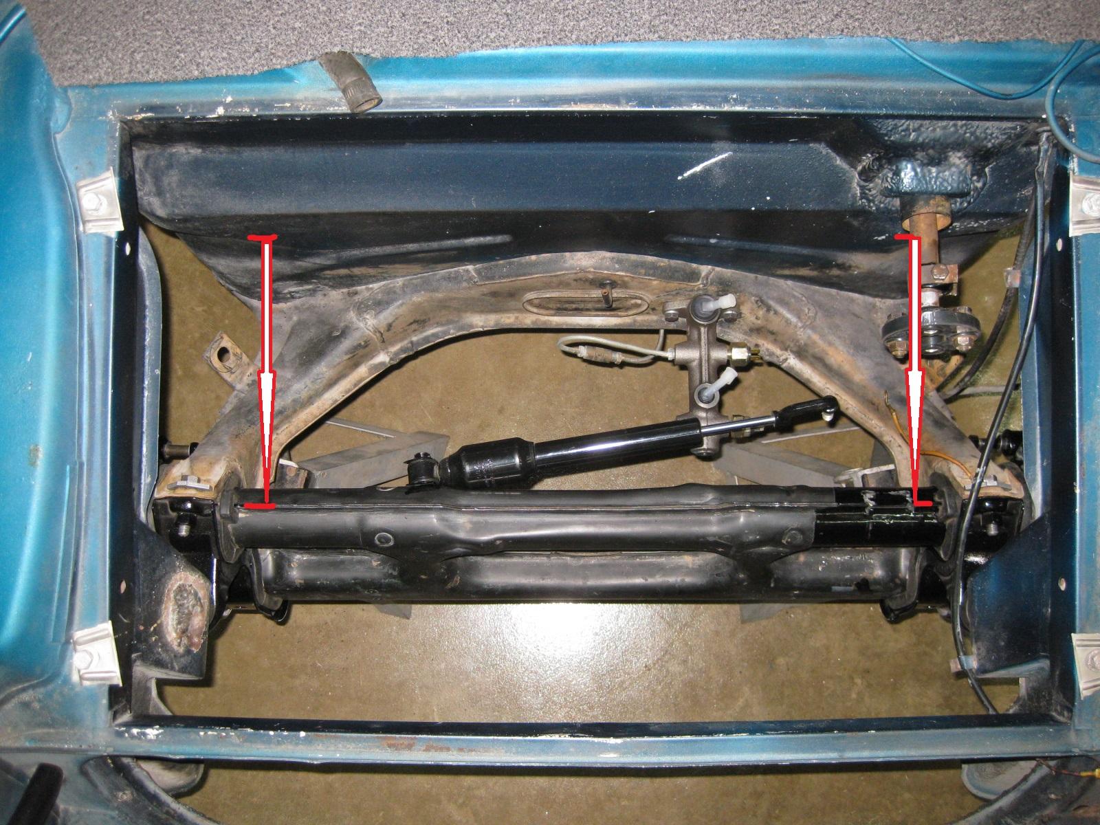

So, at the point of connecting the steering shaft to the steering gear; the coupling disc was definitely deformed. Everything does not line up.
In these pictures I've pulled the steering column assembly apart and verified that the steering column shaft is not bent.
I'm looking for advice on where to go from here to solve this issue.

See if the steering box can be loosened and moved to the left. If not, loosen the whole beam and see if you can move it to the left.

This is a 1966 T34, so it doesn't have the eccentric like the later model T3s have. I can understand why VW added it. The steering column is very fixed as to it's location with regard to the dashboard and hole through the firewall.
The steering box is moved as far left in the beam notch as is allowed. I'll work on loosening the whole beam tomorrow to see if the beam can be shifted and will check the collars in that process. I had cleaned & treated the existing collars but didn't really inspect or contrast them to others I have in the "parts to be cleaned box".

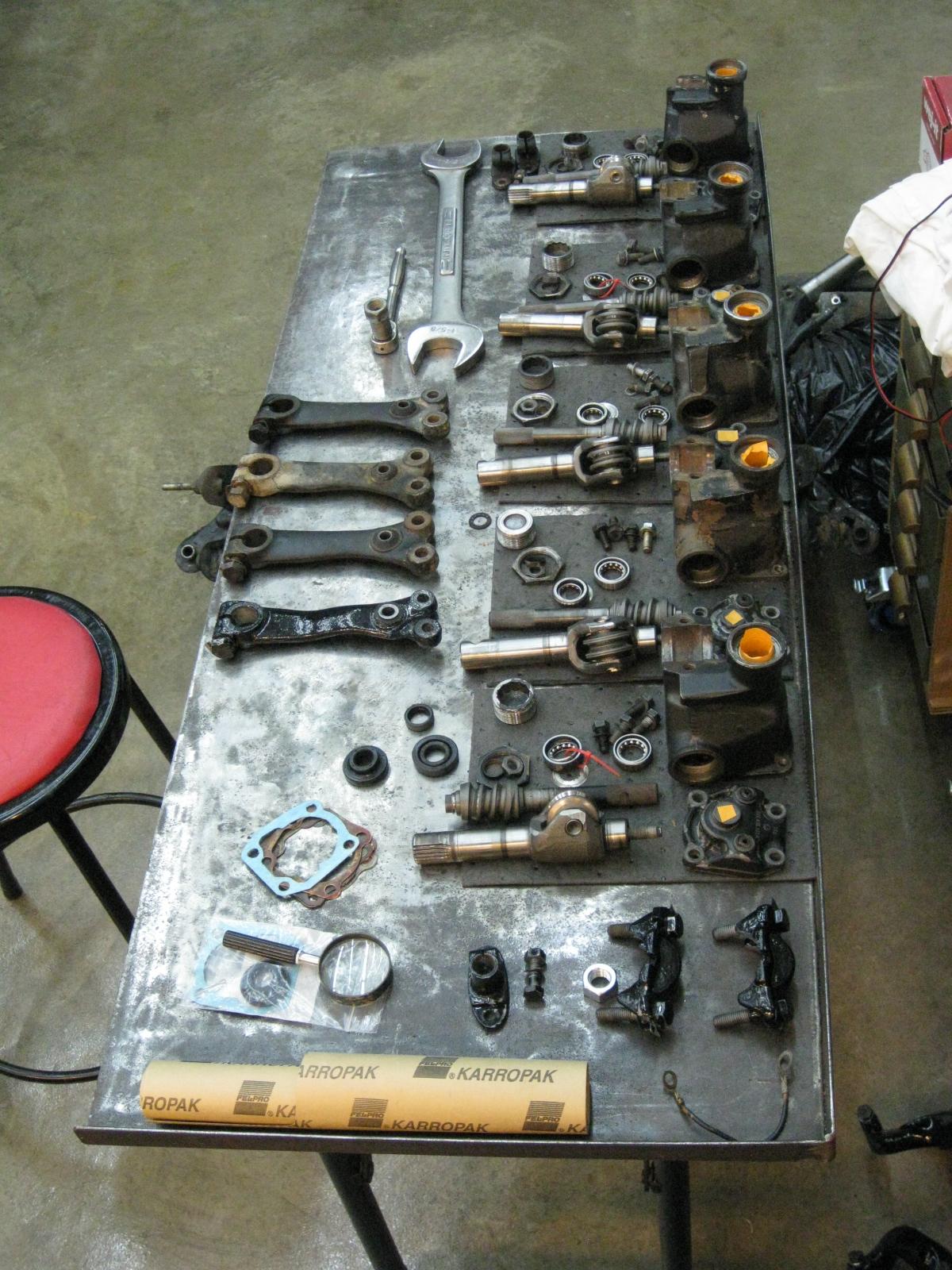

SO....I need a steering box. That leads to cleaning up the messy pile of steering boxes I have accumulated in an attempt to rebuild a working VW unit.
And so that process is underway. I'll post that exercise in a different thread.

OK. The beam was removed to check the collars and to make sure that the beam was seated/installed properly. Here are the collars that I was using. They are the correct collars for a '66 chassis. The only fault I can find with them is that the lowers are a mismatched set. I.E. they are not a set made at the same time by the same manufacturer. I say that since they have different locations on the flange for where the VW logo and part number are located. It is very very subtle, but there is a variation in the thickness of the flanges on the lower collars.
Here they are laid out as looking from the front of the car:
And then flipped to show them from the inside of the beam looking out.
Just to be sure, I used a slightly better set I have for the reinstall, that have matching number stamps:
In the reinstall, I verified that the positioning hole in the beam and in the brackets was centered over the center posts on the frame head.
So I am confident that the beam is centered on the frame head.
In addition I used a steel ruler, held horizontally, to measure from the firewall to the center seam of the beam. Measurement from the drivers side to the passenger side were identical.
So it is back to rebuilding the steering boxes.
