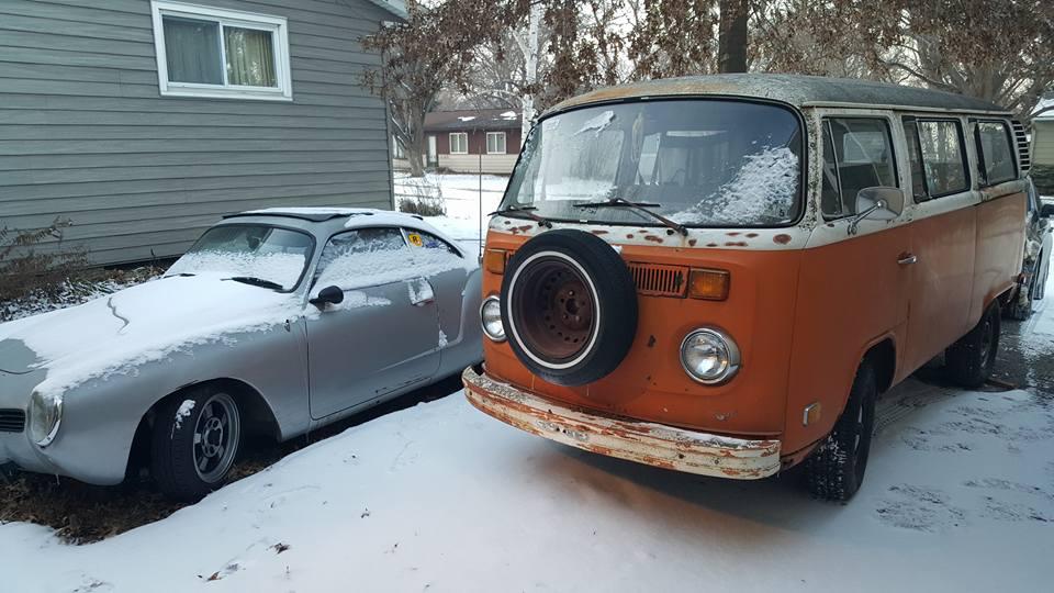

The place down the street said they can get me Pinkerton Glass in about a week, but now my windshield is out and I have NO GARAGE.
I know people talk about glass problems, but gasket problems? This is a German made bus. 1973
Heres my garage:
Any insight?

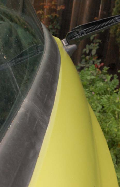

Suggestion...it is likely that the seal on the bottom is not squished down as much as it should be...
It should look more like this.....or more so.

I went and picked it up just now with the old glass in as far as they could get it. I pushed on the bottom of the seal, and it could see it moved about 1/4" down - I think they are just incompetent with older vehicles. There is some wrestling do be done and they just were not up to the task.
I am at work now - I'll give it a go when I get home. From what I have read Pinkerton glass should be a direct fit and it should be here Thursday.

If you can lay the seal out in the hot Iowa sunshine until it is about 25% melted, it should squish down on the bottom lip quite well. that will alow it to fit up at the top easier.
It is still a pretty tight fit and requires some working the inside (of the car) lip of the metal lip to seal it well. Sometimes they sand the new windshield very carefully.
