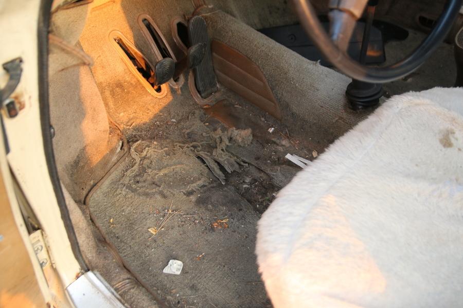

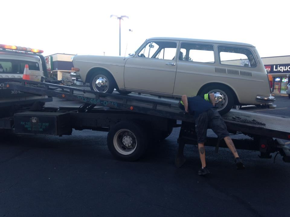

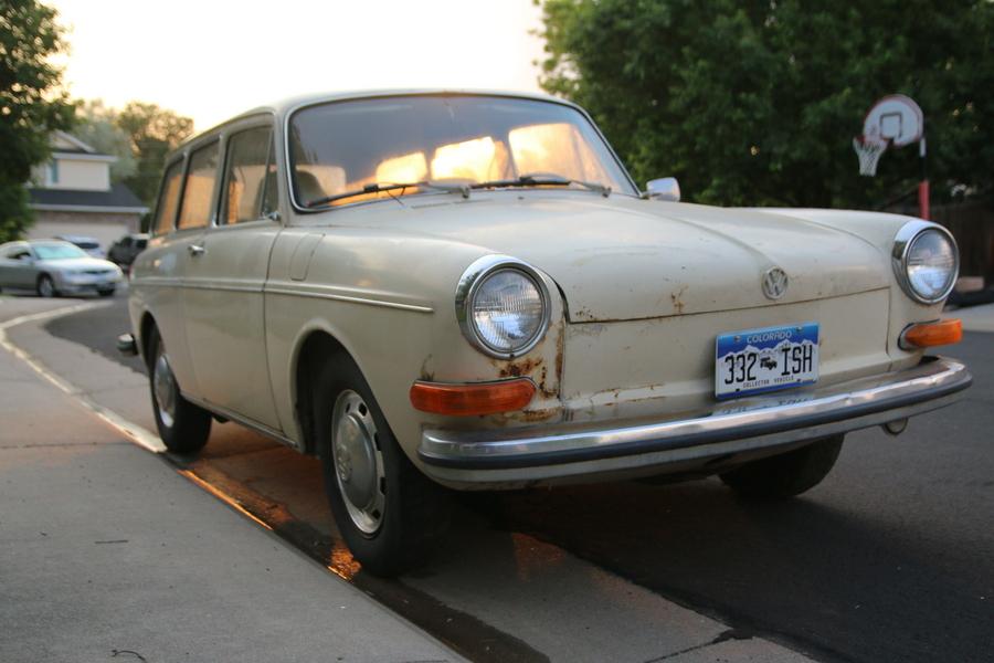

Here are a few more photos of when i pushed her from my neighbors side of the street to my side of the street.

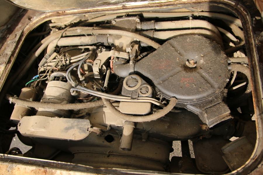

Here is what the power plant looked like.

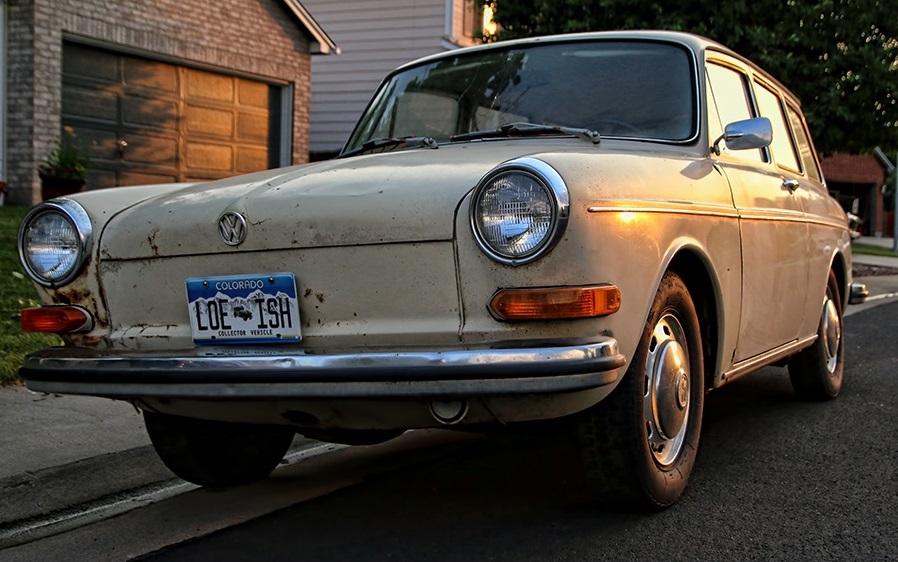

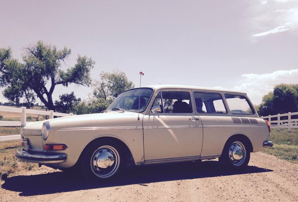

I learned to drive with a ’72 Squareback. My parents had one when I was in high school and I was surprised by the sentimental connection when I actually sat in this one some 30+ years removed. The first car I bought was a ’63 Bug, then a ’72 Super Beetle, then a ’67 Ghia. Always had a deep affection for the air-cooled V-Dubs.
So, I’ve actually had this ’72 Square for a couple months now and have been able to get quite a bit done.
Drained and cleaned fuel tank
Replaced bad fuel lines
Removed EFI and replaced with dual carbs. Kept all the EFI parts; it may go back at some point, but in order to maintain a happy household this needs to run “now” as I already have a ’65 Ghia occupying garage space, and old school carburation was in my current wheelhouse.
New battery
Oil change and tranny check
Replaced rear brake cylinders
Replaced front and rear brake lines
New 4-1/2” stock rims w/Wolfsburg chrome caps
New 155/60R15 front shoes and 185/65R15s in the rear.
Checked all electrical, few gauge issues, but all lights are working. Need to replace the turn signal switch.
This is how she currently looks. She runs and stops well.

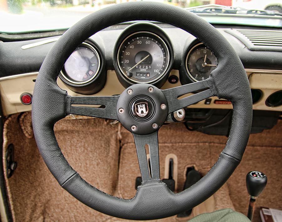

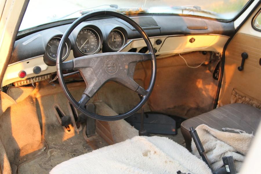

Working on an old car always has it's challenges. I had to replace the turn signal switch so I figured I'd replace the cracked brittle ugly steering as well. The wiper switch on the opposite side worked fine. With new wheel turn switch in hand. a quick change was in order. as I went to remove the switches the wiper switch, brittle for decades of sitting, broke apart upon removal.
Not having one on hand (because it worked) I had to search for one. After finding a new one and getting it shipped, everything went back together like a charm.

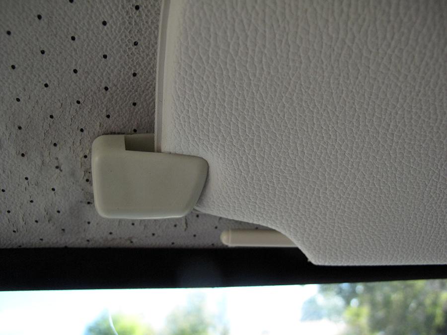

OK,
Need the experts. Anyone have a clue which visor i need to order to get the correct length?

Bobnotch
Joined: July 06, 2003
Posts: 23342
Location: Kimball, Mi
Bobnotch is offline
PostPosted: Wed Sep 07, 2016 7:55 pm    Post subject: Re: Cory's 72 Squareback Reply with quote
corythosaurus wrote:
OK,
Try adjusting it first. By that I mean pull the rods out of both ends unti you get it to fit. The hinge/pivot end should be the end to start with first. The sellers really need to include instructions with these things (you're not the first with this problem).
