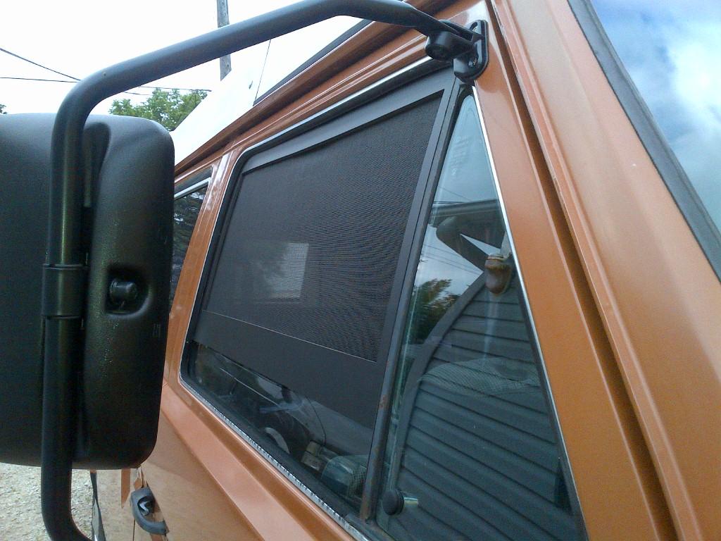

Heres a slip in window screen I built that fits either a westy or a tintop. It goes along with my extremely popular skylight screens and also my newest rear slider screen to fully ventilate your vanagon when camping. It slips into the window track and is held in place with a gentle pressure from the window glass.

Looks great! I had a fabric set that I made, but they've already scratched my paint. Not too pleased about that!
Inside pictures? And, where do you suggest storing them? I'm worried they'd get bent/broken.

I keep mine behind the rear seat but they could also be placed on the top bunk before the top is closed. No inside pics posted but I will try to take a few later and post. The nature of the PVC frame is that it is quite flexible so should be tough in use and I use that fact to advantage as they are flexed to fit into place. The screen is a fine No See-UM insect resistant type but of course you can poke holes in it if not careful like any screen.

Any pics of the inside? How does the screen attach to the frame?

Screens flex and slip into the window track all around and at the bottom they have a slot that fit over the glass.
Heres what the bottom profile of the screen looks like. The window glass slips into this slot to hold the screen up into place. The square edge is the inside. I hope to post a quick youtube video in the next few days to show how they install.

I like what you are doing, I'm a bit anal at times, but how about the upper left corner having a radius to match the door's original widow opening? CNC, it is just a small program update

Yes that is on my list of design changes for the final production version.
