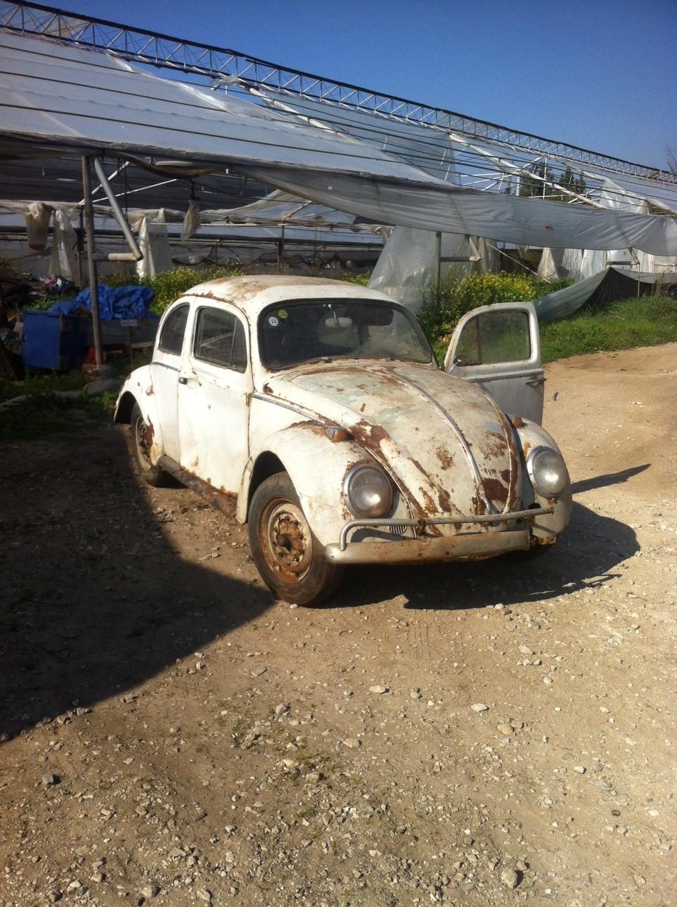

Decided to share this restoration projact, bought this beauty three years ago.
1959 vw bug in rough condition. last driven in back 1994. all floor pans are rusted, heat channels too, doors are danted, engine and gear condition is unknown . but I love it.

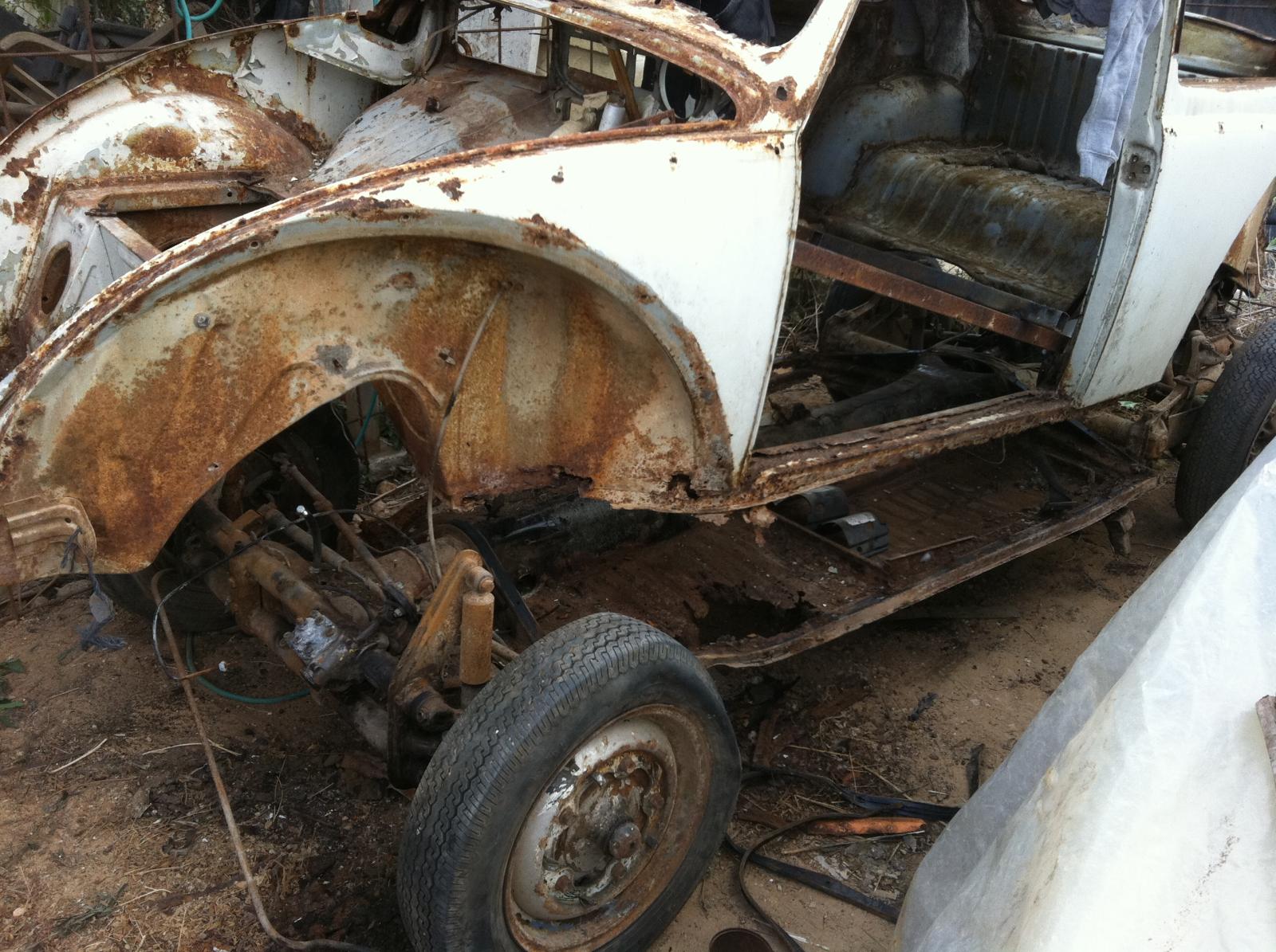

PostPosted: Wed Nov 16, 2016 9:52 am    Post subject: Re: 1959 vw bug restoration Reply with quote
After removing most of the interior, glasses, fenders and taking the bug apart, today I took the shell off the pan in order to start replacing the floor pans , having the brakes fixed, replacing bushing and every thing that will need replacing . the goal is the have it mechanic fixed before the shell will be put back.
going airborne..
rust every where

It appears to be a lot of work due to corrosion issues. Do you plan on doing a VW showroom restoration? If so, expect to spend spend more than you think if that's your goal. Every system (paint, metal work, suspension, drivetrain, interior, trim, etc.) will need attention.
The 1st thing I would do is have the body shell media blasted and then sealed to prevent rust. This way you know exactly what your dealing with and there will be no surprises.

Wow, that bug was rode hard and put up wet! Why all the rust on it? Is it humid there or was it by the ocean salt air? Seems like a lot of salt type rust damage.
Good luck with your project. You've got LOTS of work ahead of you but it's so worth it when you're driving it down the road when it's done.

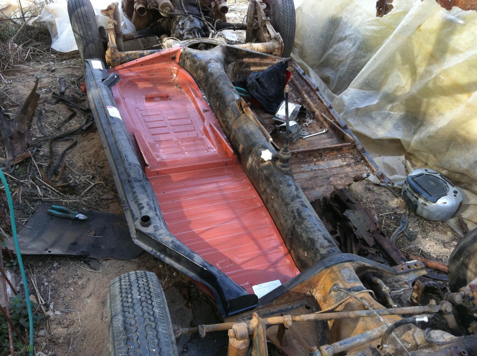

PostPosted: Sat Nov 26, 2016 11:23 am    Post subject: Re: 1959 vw bug restoration Reply with quote
Removing the rusted floors and fixing new ones.

PostPosted: Sat Nov 26, 2016 11:27 am    Post subject: Re: 1959 vw bug restoration Reply with quote
Noooooooo! Orange pans Shocked Confused Your gonna have to move the seat tracks and those things are like paper. You should have taken my advice...
Anyway, it's good to see you are jumping right in with the floors and not trying to make patches everywhere.

PostPosted: Sat Nov 26, 2016 12:48 pm    Post subject: Re: 1959 vw bug restoration Reply with quote
I bought this pans almost a year ago, before your advice.. from CSP that was the thicker one they had
Why will I need to move the tracks??

PostPosted: Sat Nov 26, 2016 1:03 pm    Post subject: Re: 1959 vw bug restoration Reply with quote
From what I understand of the orange pans, the tracks are angled toward the tunnel if you look at the head on.
