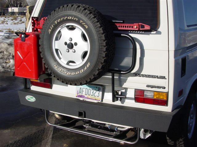

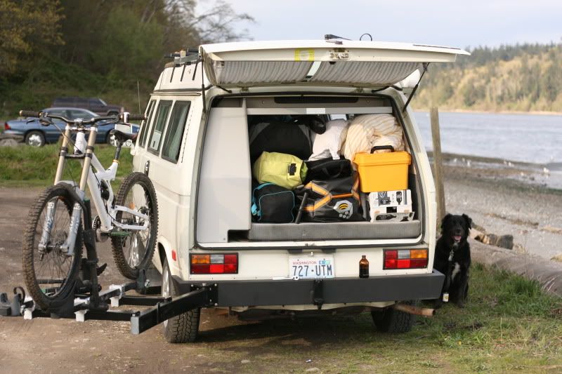

I have the GW bumpers and have used my T2 rack on it a lot. They are very strong. The receiver is boxed into the bumper and the frame attachment spars. Very stiff, even with the huge cantilevered forces of a bike rack with DH bikes.
I built my own rack attachment as adding swingouts was an issue. You couldn't swing them out without removing the rack which meant the back of the van was pretty much unusable. I built my bike rack into swingout, which has turned out great.

I should have mentioned that I already have the Go Westy plate steel bumpers with the integrated hitch installed on my syncro.
Alaric, I'm asking for feed back on this carrier http://www.gowesty.com/ec_view_details.php?id=4251
(Please excuse the iPhone screen shot. It's the only quick way I could think of to get the image from the GW website.)
Specifically if anyone has used it with a bike rack or towed a trailer with it.
buildyourown, I checked out your swingout bike holder, it's really great. I'm pretty happy with my Thule T2 but I was hoping someone has direct experience with using a 4 bike rack like a T2 with the Go Westy swing out carrier.

I get it. I was just saying that the GW swingout will hit the T2 rack when mounted to their bumpers. My rack started out as a can/grill carrier and then I realized it would hit my bike rack so it evolved.
I'm sure you can measure for yourself, but there is plenty of room between the bikes and the van with the T2. I have my grill and gas cans wedged in there.
If you can find a fabricator, I will share my rack design. I had access to lots of silly tools, but it could be simplified for a fab shop. (ie, no CNC machining)
The swing out is a much better design for a hatchback vehicle vs the stock T2. Much easier to get access to the rear.

buildyourown - when you don't have bikes on your carrier does your rack swing up or come off? How does it look when it's empty. I can tell your priority is to have the best bike carrier. In a perfect world I would only be driving my van with bikes on it, to or from the trail head. But since it's my only vehicle I need my rack to fold up out of the way so I can park in a regular space. I also tow a boat sometimes. Your rack looks like the sturdiest way to carry bikes on a vanagon ever built, especially several DH bikes. My T2 wiggles around a lot with 3 or 4 big bikes on it. I bet yours is rock solid.
I could have easily designed in a pivot to make the rack fold up. I didn't because it would add weight, time, and one more joint to wiggle. I decided it wasn't worth it.
The bike portion can be removed with 6 bolts. The whole rack can be removed by pulling the clevis pins. You need 2 people and a dead blow hammer, but it takes about 5 min to pull it off and store it in my garage.
I was initially worried about the length when empty. However, it's not any longer than my Toyota Tacoma and it's higher than a regular T2 so it's easier to see. I'm adding lights so should get even better. But yeah, it's not my daily driver.
It does kill the ability to use the hitch at the same time, but bike racks are the only reason I got a hitch.
The GW is too low to work with a T2. You asked about compatibilty, and mine mounts the same way, and it doesn't work.
