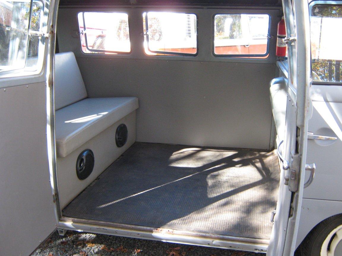

Interior...
I had a couple of hours to work on the bus today...
- adjusted the link pins. Greased link pins, king pins and beam.
- cleaned and repacked front wheel bearings. I was pleased to find the later style clamp nut rather than the annoying two lock nut set-up.
- inspected and adjusted front brakes.
- removed all the locking handles to get the key code. They all matched! I ordered two keys from gabvwkey.com.
- I'm gonna get a lot of people asking WHY for this one... I removed the steering dampener. I run all my VWs without them. I like the feel of the steering better without them. I also find the new ones sold are way too stiff.
- whacked my head several times getting into the bus... still getting used to it being so low.

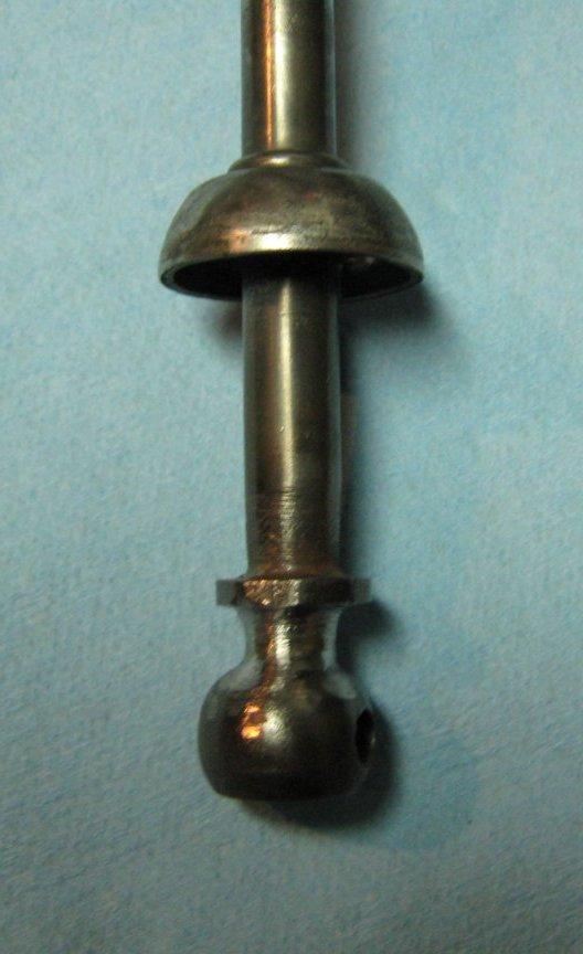

Here's the '66-67 shifter modified to fit my '60 bus...
It was a pain to make sure I had it properly aligned before welding it back together... it's not perfect but real darn close. It works and I now have the lock out for reverse.

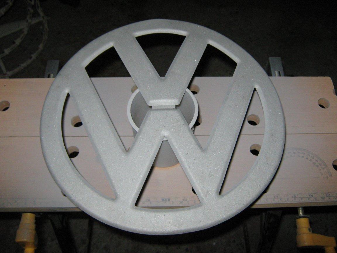

I sand blasted the turn signal housings and VW emblem. I painted the emblem white and the turn signal housings just got primered.
The bus is crammed in my garage along with my '74 bus and '56 Beetle and probably won't see the light of day until next April.
Next up is to rebuild the engine...

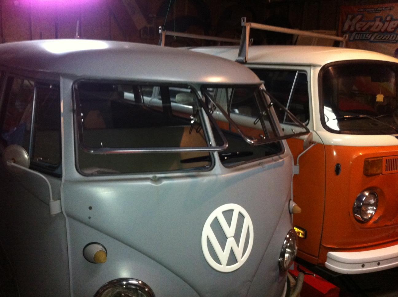

Installed some CE Safari Windows...
Not sure if they will stay or not. I find the window slides make the interior too busy and can get in the way.
