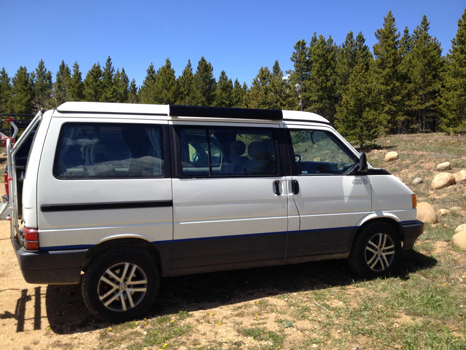

Mine are 16-inch alloy MK5 2006 VW Jetta wheels, 7.5" wide, 5x112 with a 57.1mm center bore, ET50.

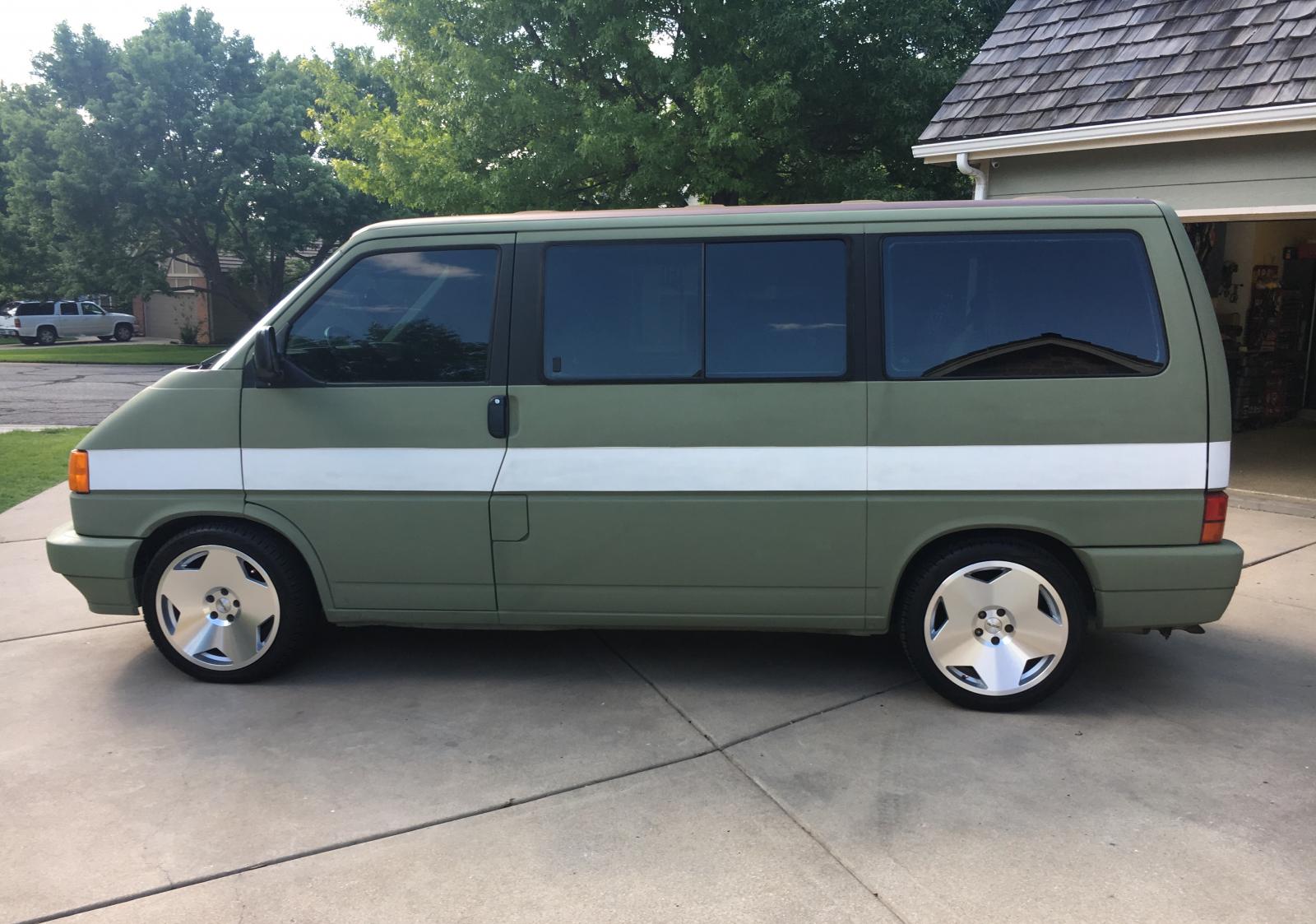

18x8.5 et35 Alzor style 081.. yokohama 245/40/18 tires
fit like a glove with no rubbing at all.. a little stiff due to the sidewall though
they are now flat green though Smile
17x7 et43 OEM Beetle Heritage wheels.. Hankook 215/55/17 tires
THESE ARE AN ABSOLUTELY PERFECT FIT AND RIDE

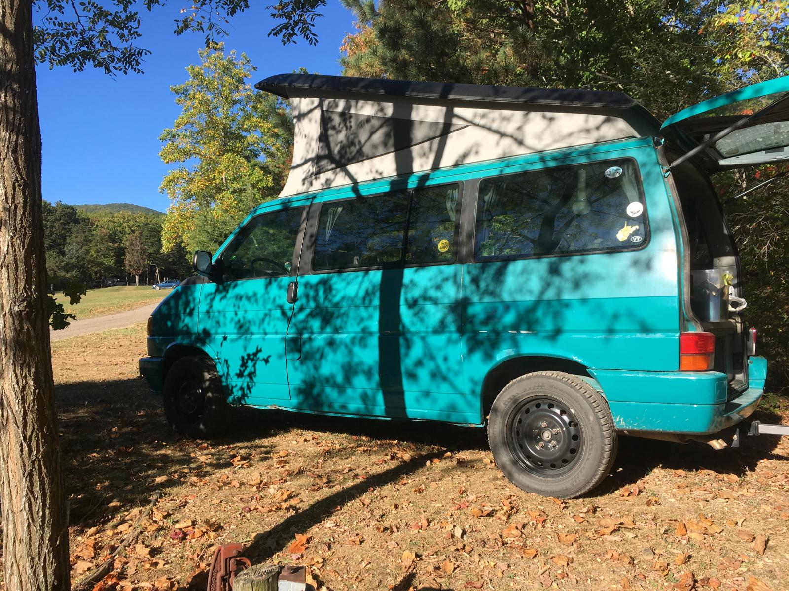

16x6.5" et42 steel wheels - same vw steel wheels that others have gotten from Tire Rack, though I got these used.
225/60/16 - Nokian entyre 2.0

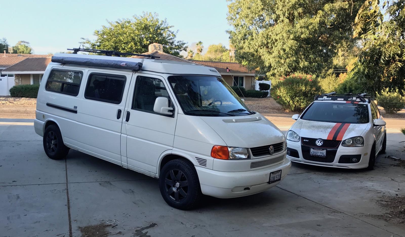

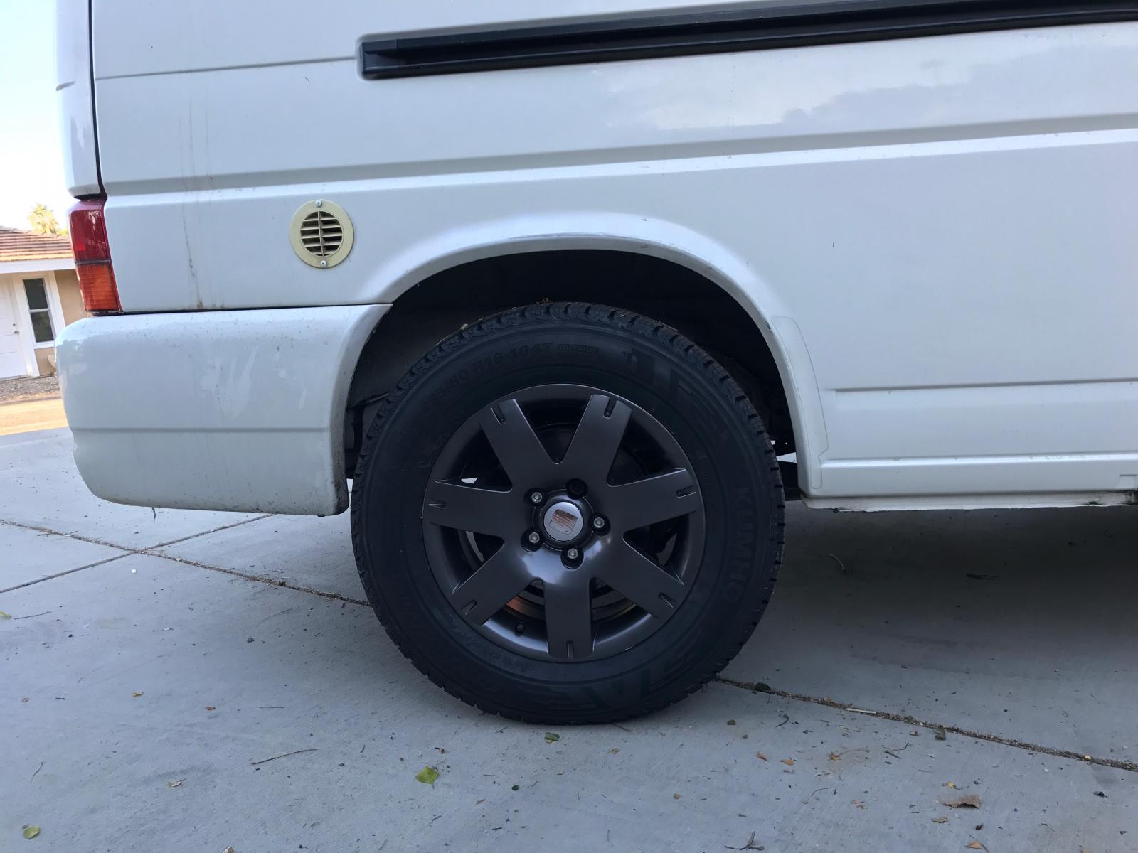

Here is our 99 EVC on some B5 Passat "Sport Alloy" wheels (VW used to really lack creativity when naming wheels) wrapped in 235/60/16 Kuhmo Crugen HT51s. The suspension is still stock height (for now). Seat center caps added for the super OEM+ look.
