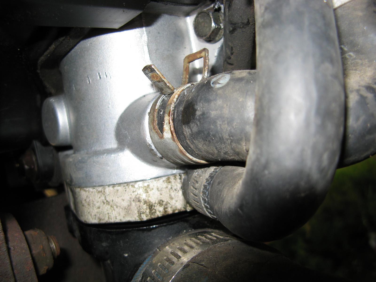

Hey Guys, Early 2000's SOHC EJ25 motor in a Vanagon with a EMS instead of OBD. Had the motor rebuilt and installed in the spring. About a month after install, it boiled over on me while driving at a moderate speed on the freeway. I pulled over immediately before there was any serious damage. Took it to a shop where we replaced what looked like a faulty thermostat, you could see on the thermostat where it looked like it was rubbing and sticking. Replaced it with a aftermarket one from Autozone, installed it, pressure bled the coolant at a shop, and drove it home. Next day, same issue. I removed the thermostat and ran it since then without one with no cooling issues. I've deferred this long enough and am going to try to tackle this again tomorrow and see if I can figure out what's going on. This time i'm going to go to a Subaru dealer and get a OEM thermostat and try that as someone had recommended that could be a possible issue. I was just under the van taking a look at things before I try to tackle the job tomorrow and saw this blue bolt, it looks like it's an adjustment for something on the thermostat housing. Does anyone know what it is and used for? Any guesses what could be the issue if I reinstall the OEM thermostat tomorrow and it boils over again? To recap, doesn't overheat without thermostat, overheats with thermostat.

I removed the jiggle pin and drill out the hole a little bit 1/8" or 3/16". Seems to flow just a bit more coolant than it would otherwise. Mine have never boiled over though. Having it out also helps a lot for it to self bleed during cool down cycles.
What size hose to you have as a bipass to the thermostat housing? Is it using the rear heater loop as a bipass, if so that needs to be left open.
I think that blue plug is just a plug maybe it went to an oil cooler. Some of the engines come with an oil cooler housing that sticks down and may not have been used on your conversion, like mine. Mine just has the hose cut and plugged.
BTW, everyone says use OE thermostat but I doubt the aftermarket one was bad out of the box. I think they are just way cheaper made but should still work initially. You could put it in a pot of water on the stove and test it. So you will probably need to figure out why you're not getting coolant through your bipass to tell the thermostat to open.

Is that a stock thermostat housing/water pump? Where is the heater return line? What was there before the blue plug - a nipple? What kind of temp feedback loop do you have plumbed to the thermostat? For example this is my 02 Impreza thermostat with a feedback loop from the coolant manifold to a sandwich adapter between the WP and thermostat housing.

Aftermarket thermostat issues for subarus are well documented in many enthusiast groups. Undersized, doesn't open all the way, poor flow etc are the usual complaints.
For example
That blue allen head plug in the thermostat housing likely doesn't effect anything as the spring side of the thermostat is on the water pump side not the cap side.

The Subaru thermostat with the jiggle pin is recommended and I believe the position of the jiggle pin appears to make a difference having it face forward (in the Subaru) so facing to the rear in the Vanagon.
