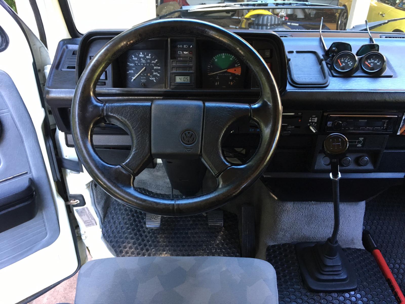

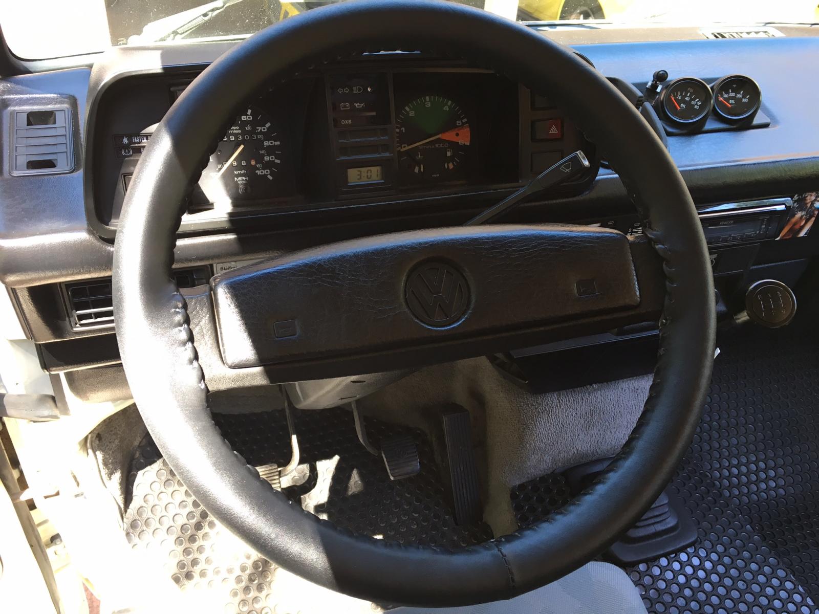

Today i'm polling myself as to which one to stay with...
1 - My stock wheel that I double wrapped in leather. A very comfortable and thick grip this way. Feels great, looks nice and gives you the benefits, and drawbacks, of the stock wheel.
2 - I also installed this VW MK1 "GTI" wheel (1985-1988 version) in order to try out an alternative steering wheel. It is a direct, simple bolt on replacement. No mods needed with this wheel. Smaller in diameter by a little. It does block a small portion of the upper corners of your speedo and tach. But my seats (Recaros) sit pretty low so not an issue for me. I'm gonna give it a week or so to see how I like it. A thought is to also "wheelskins" wrap this one, tho it is leather from the factory.

Good point. My van is equipped with power steering so going to the smaller wheel is not such an issue. Iv'e read that yes, going to a smaller wheel is tough if you don't have ps. I can tell you that it is very nice to have the extra room with the smaller wheel. getting in and out of the van is much easier, tons more legroom.
I may go back to my stock wheel as having it double wrapped is very nice. While I test out the smaller GTI wheel its sitting on a counter in my garage but I keep picking it up and it feels really, really good. Double wrapping with leather is a common Porsche thing, (maybe others too?). I used 2 "Wheelskins."

I'm also happy with my stock wheel - after adding a leather wrap. I like the way the old school style matches the vehicle but the extra girth and softness of the wrap is much appreciated.
