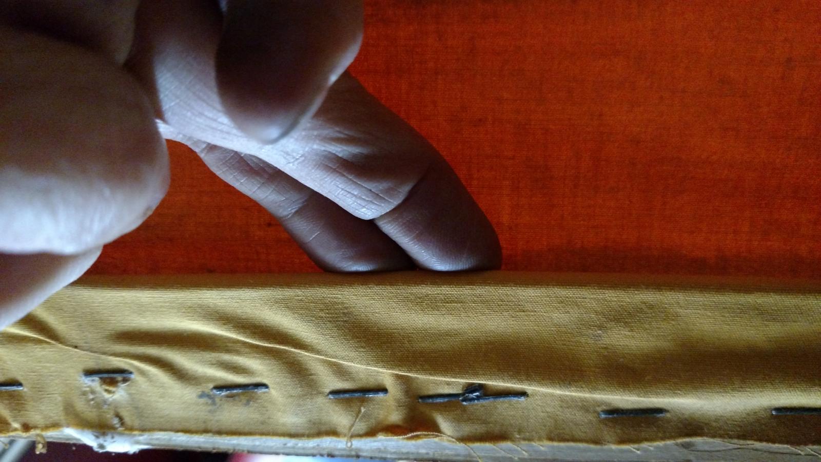

Next I used a small screw driver and side cutter to remove the 500+ staples that held the lower canvas to the wood in the roof of the bus.

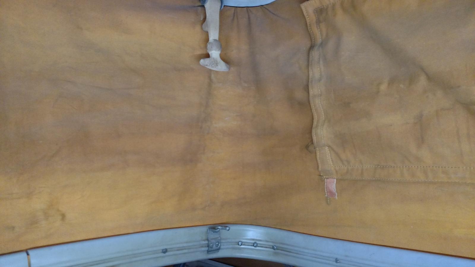

Here you can see how the slack of the canvas is covered by the gray trim piece.

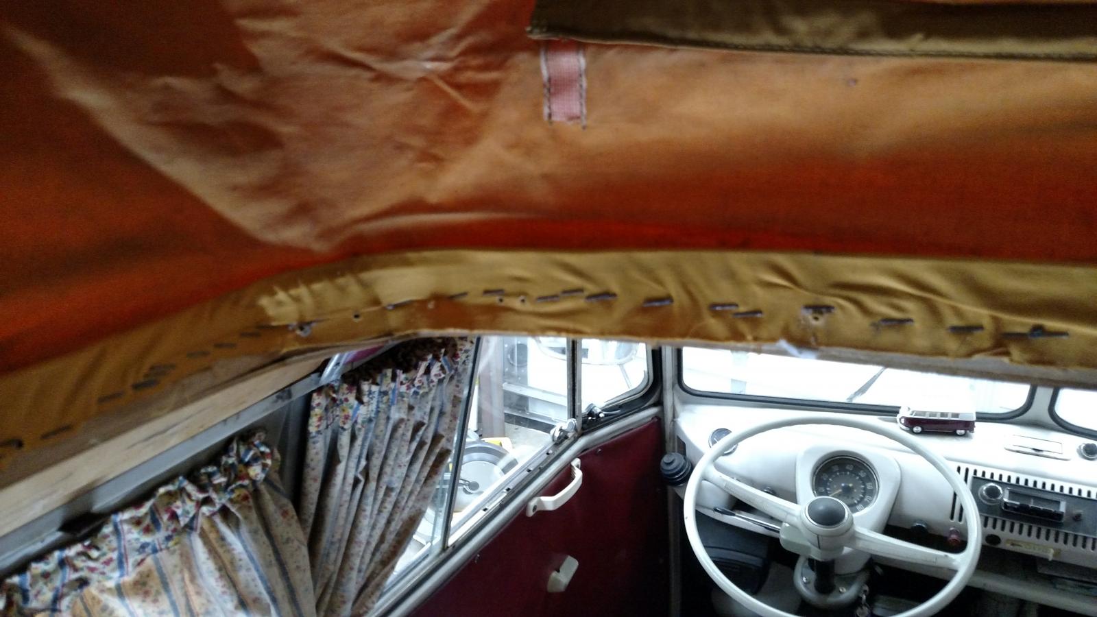

Now that the canvas was loose all the way around the bottom, I rolled up all four sides towards the inside of the roof. It took a couple of times to go around rolling up, but it stayed there with no tape. I guess some masking tape to attach the rolled up canvas to the poptop roof might help if your canvas is not old and stiff.

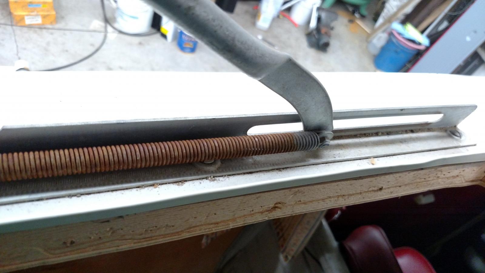

I lowered the poptop until it was easy to reach the tops of each crossed arm where they connected to the poptop rail. I used a pair of vice grips on each of the three bottom rails to keep them from moving while I removed the screws, rollers and washers.

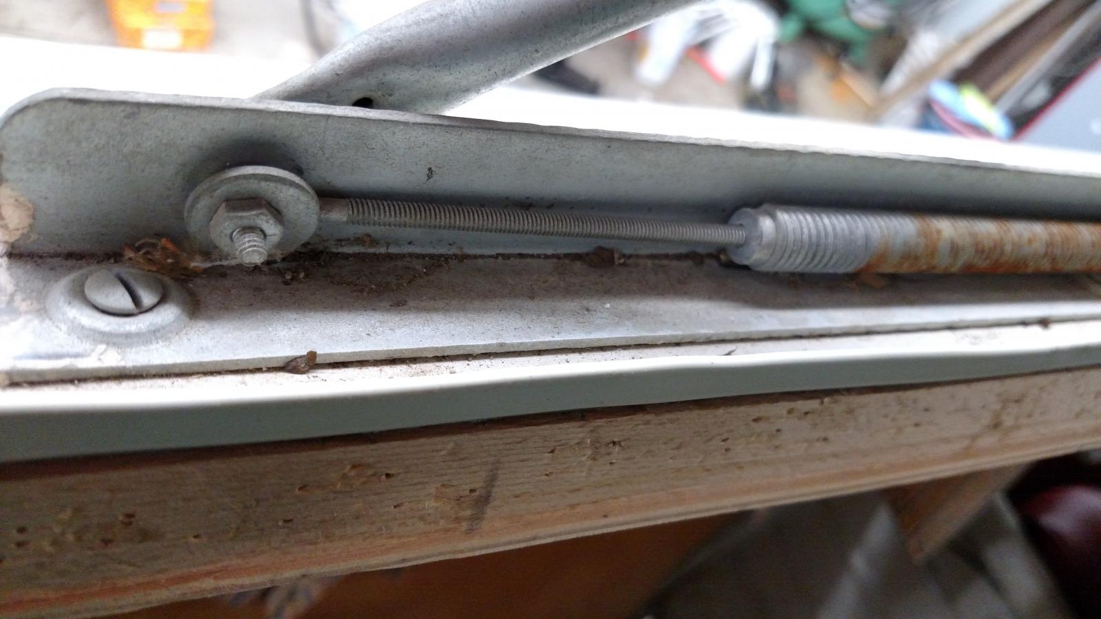

Here is where you can tension the spring on the mechanism.
There are three combinations of bolt, washer, brass roller, washer and nylon locknut where the slots in the rails are, and just a bolt, washer and nylon lock nut on the other pivot points. I opted to remove the six top connections rather than anything that connected to wood so as to preserve the strength of that joint. The bolts have an 8mm head and nut.

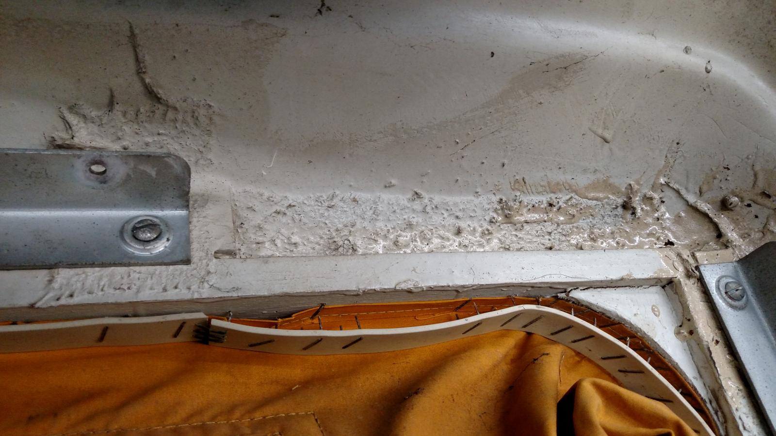

This view gave me a great look at how the original canvas was attached with another 500+ staples. The original plastic strip was also pulling out from the corners and had cracked in several places so it was easy to remove with the staples still in place.
You can see how I rolled up the canvas to take it off.
Once the narrow plastic piece was removed, I worked my way around the canvas with a small screwdriver and side cutter to remove all those staples. Staple removal probably used up half the total install time.

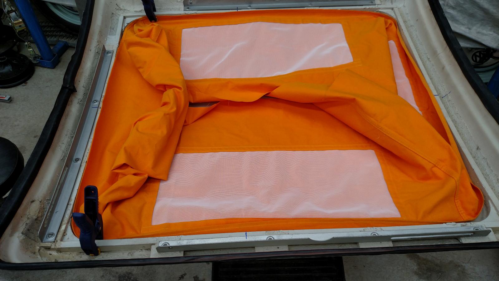

With the top laying upside down, I folded the canvas so the bottom outsides of the windows were facing up and towards the center. I got the front window (middle window ) generally centered first, then I measured between the back edges of the side windows to determine the center of the back. I also measured to find the center of the back on the wood and lined both points up so the center of each was known.
Next, I pulled about 1" of the canvas up against the wood and used a pneumatic staple gun to put one staple through the canvas only into the wood to keep that center piece lined up.
I then worked my way to the left and right of that center staple towards each of the back corners, I pulled the canvas up an inch and put a staple in every 5 inches or so. The staples are going through the outside side of the canvas into the wood.
I kept the tension even as I worked my way around each rear corner and down the sides. I did some on the left side and then switched to the right side until I got to about the middle of the sides.
At this point I rechecked to see that there would be no big bunch in a spot nor a tight corner. If there was, I would have pulled staples to back track until I gained or lost what was needed.
Since all looked good, I kept going until I had stapled it into the wood all the way around. I went back and added staples to the corners about a half inch apart, and two more between each of the first batch all the way around.

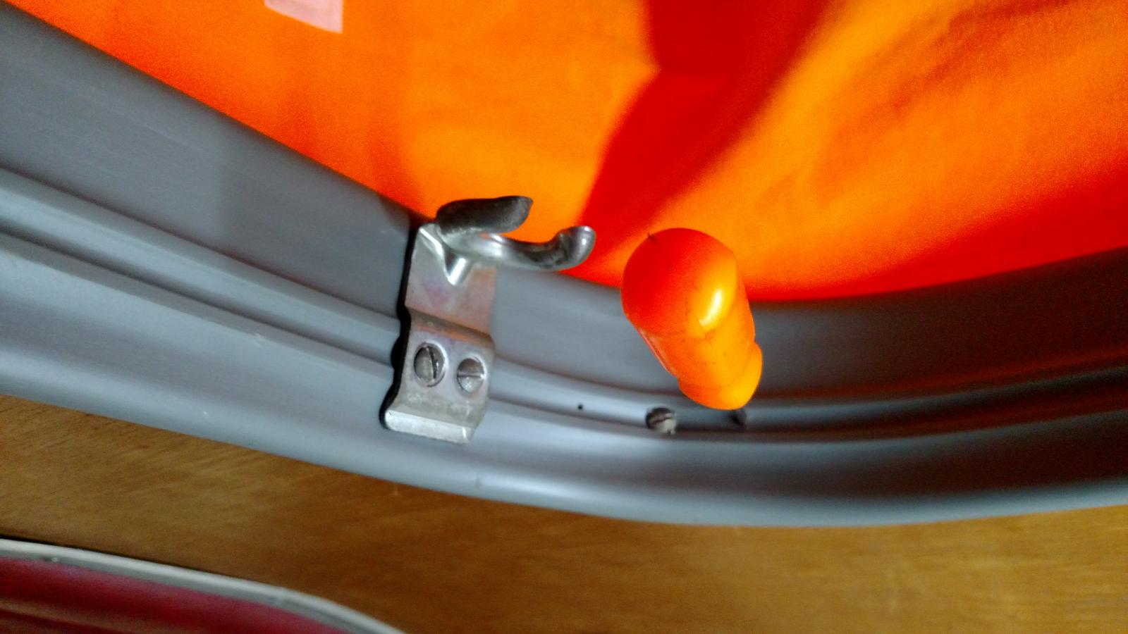

The last piece to go on is the wide gray trim piece. This gets screwed into the wood and hooks onto the metal lip of the bus roof on top and the wood ceiling panels on the bottom. I placed the seam in the center of the back so I started there and worked in to the corner. This trim is very stiff and may benefit from unrolling and warming a bit prior to installation.
Also, if your canvas is too tight in the corner, it is a difficult to get the seal hooked on the edge all the way around the corner. if it is too tight, you may benefit by having someone on the outside of the bus pulling the seal over the edge while you push from the inside. You must get it completely hooked over the edge for the canvas to be pulled tight and sealed. Once you think you have it, step outside and have a look at all four corners to be sure.
Once the trim is in place, install the four metal hold downs first. These get two screws. All screws go in the middle rib of the trim. I used a sharp awl to poke a starter hole for each screw
Next do the corners. Each corner gets three screws.
Lastly do the sides with the remaining 16 screws. I chose to measure each side and evenly divide them. For the back seam, I trimmed the extra off and put the last two screws on either side of the seam.

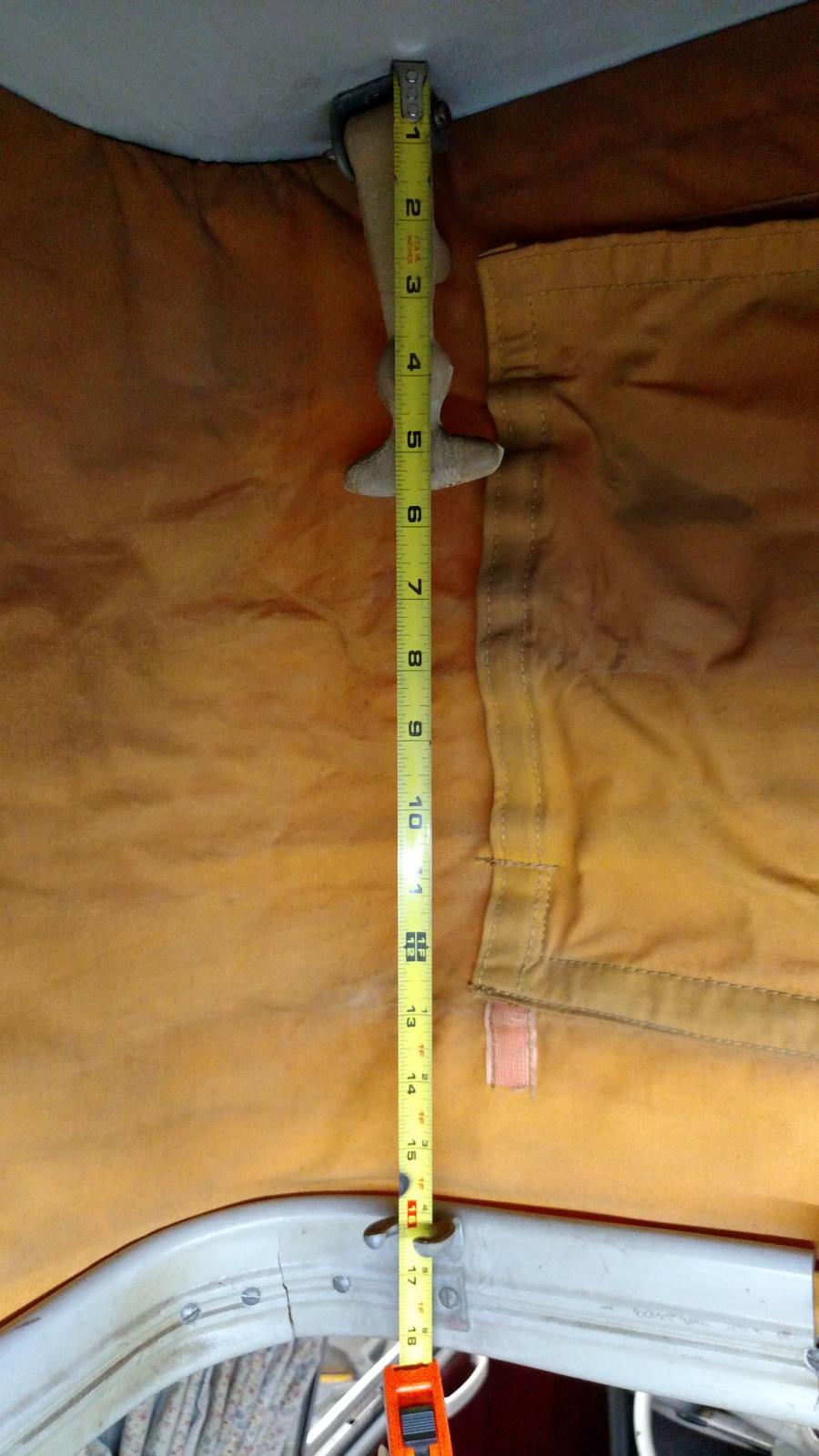

Here's a comparison of a scrap of the fabric on my new pop top to that of the faded old one, and the original color I found inside some of the folded up areas of the original one.
srfndoc
Joined: August 21, 2010
Posts: 3392
Location: SoCal
srfndoc is offline
PostPosted: Fri Jan 13, 2017 10:07 am    Post subject: Re: SO42/SO44 poptop canvas replacement how-to Reply with quote
Color is definitely off a bit but still the best repro out there. You should send that piece of un-faded canvas to Helmut, maybe he can find a closer match.

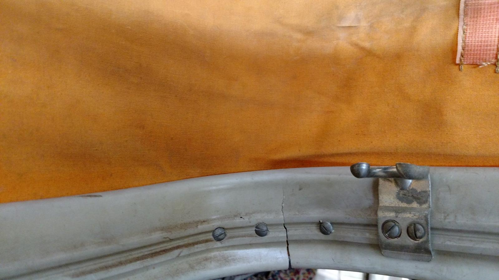

Just wanted to add one small tip for anyone having trouble fitting the grey trim at the end: a heat-gun is a really good way of making it easier to work with when needed - you can just point it at the bits you're working with and heat them up as needed to make the trim more flexible / pliable for the hard parts (like the corners).

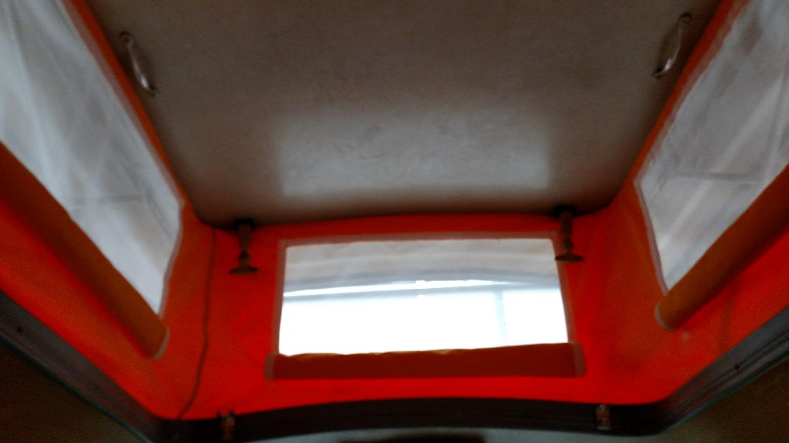

PostPosted: Mon Feb 12, 2018 2:52 pm    Post subject: Re: SO42/SO44 poptop canvas replacement how-to Reply with quote
Another Helmut canvas installed:
A couple things I noted when installing this canvas:
1. It needs to be stretched quite a bit to get it stapled in the top
2. Be sure when you staple the tack strip it is touching the top of the poptop (I used the Go Westy strip which is a bit wider than the OG strip)

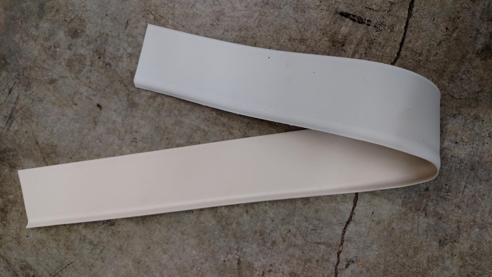

3. Definitely use heat to soften the grey trim strip before trying to get it on the corners (as Jamiekp mentions)
4. Mine does not have an adjustment spring, not sure if mine was replaced or if yours was a dealer replacement

Thank you for this thread ...I had a quick question ... did you use the upper white tack strip on your pop top? Doesn’t look like Go Westy has it anymore and the detailed description says it was used for 68+ ... I have a 67... thanks again for the detailed install info . Yes
On my pop-top install I bought a new roll from Wolfsburg West of the plastic tack strip that you staple through to help support and attach the tent material to the pop-top. We carefully pried each staple out of the original plastic tack strip while removing the old tent material which surprisingly was still soft and pliable, so we elected to re-use the original as once installed on the Camper it is covered by tent material and not seen. The WW product would work fine and had no staple holes in it, but it was slightly narrower in width, so since we had a good used one in our hands, and trying to be as accurate as possible, we re-used my original. I still have the WW repro here in the bag if anyone needs one cheap.
