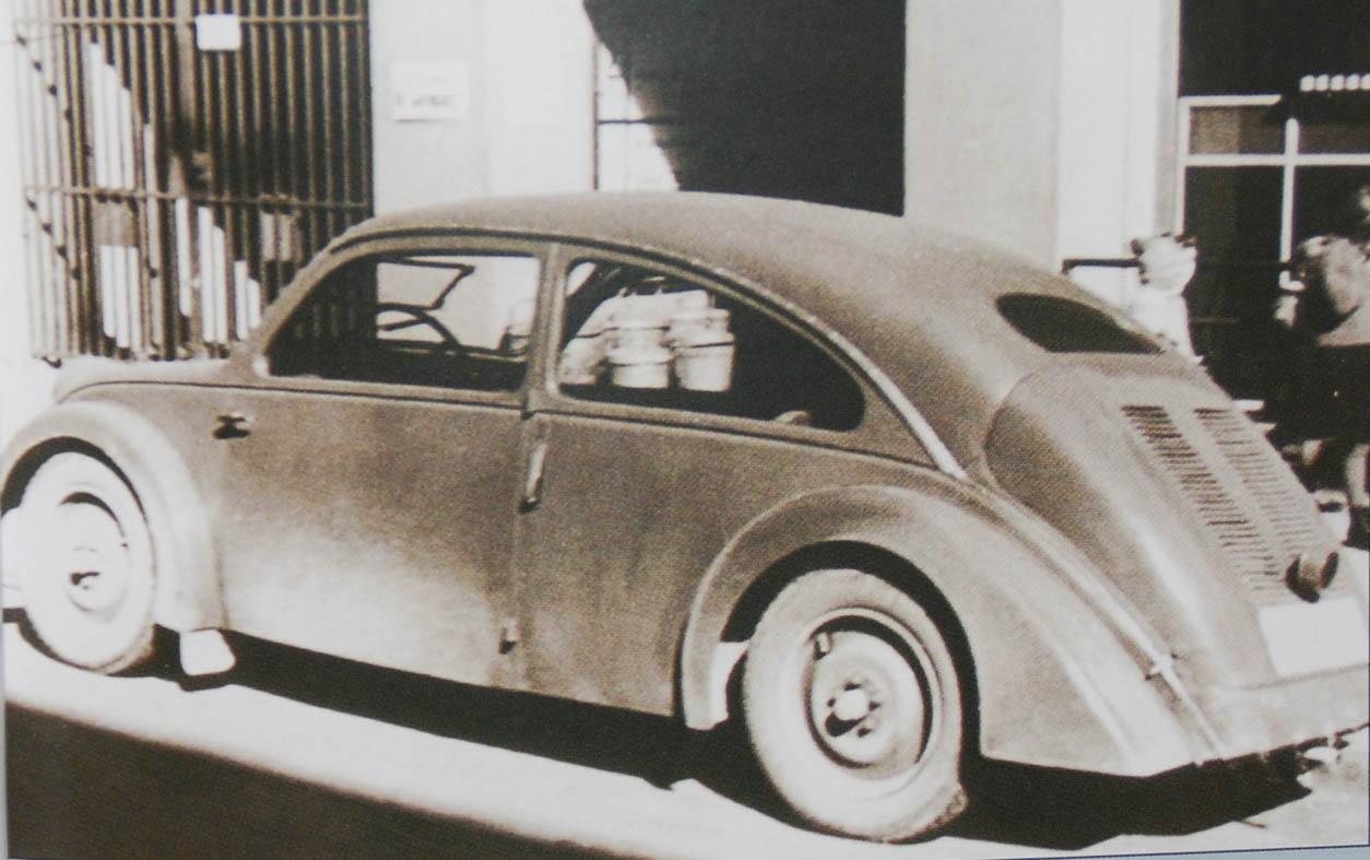

Most Beetle books have these two cars shown as the precursors of the beetle, and most claim they are both Porsche Type 32. I find that inplausible. The cars are not the same at all, they show very little common design treats. The blue car is made from steel, it has grilles behind the rear quarterlights, the fenders are much more curvy. The dark one has a much sleeker body, which looks to be made in DKW fasion, from wood with artificial leather as outer finish coating. It has no grilles behind the rear side windows, and the front fenders are much simpler and elegant.
I do not believe that Porsche had two so dissimilar cars made to the same type number specification. Does anyone have any reliable information on this?
This car exists today and is in in the VW museum as a NSU Porsche typ 32
One of the Porsche drawings, obviously depicting a car similar to the dark car in the black and white photo.
This car is only known from this photo, as far as I know. Is it an NSU Type 32, or maybe not? Maybe it is the only one which is a type 32?

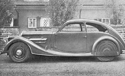

For reference, here is the Porsche type 12, the Zundapp.
Just for fun, here is the Porsche type 7, the Wanderer prototype of 1930. Only one made on an expensive 6-cylinder chassis, and kept as Ferdinands personal car for years. No attempt on a people's car.

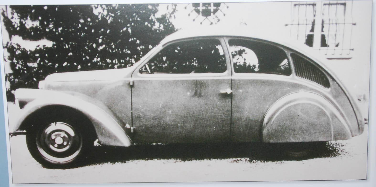

He who seeks, shall find! In my tiny book from the Porsche museum, "Ferdinand Porsche und der / and the Volkswagen" the all-metal NSU type 32 is shown in all its pre-modification glory. My advise to the VW museum is to get rid of the butt-ugly integrated headlights and install a correct set of vintage MB 170H headlights!
Next to the NSU, we see Ferdinands wonderful personal prototype fastback Wanderer.
For all my searching, no other photos can be found of the wood and fabric NSUs, than the one of the dirty car by the curb. I agree it is quite similar to the drawings in the Porsche archives, but where are the drawings of the all-metal car?

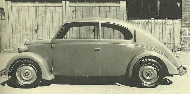

Could this be the third car?
Comparing to the NSU all-steel car, this looks much more similar in my view. I found it on a page that discussed the origins without offering too much new info except this picture.
The fenders look much more consistent to the blue NSU prototype, the rear sides have no air inlets (but semaphores instead). If anyone knows any detail, please chime in!

Yes, this is the "less well known" Type 32 prototype I was referring to. Here another view of this car, taken outside the Drauz karosseriewerke.
As for the faux leather / wood construction prototype, there is a photo showing the front with the car parked in the same position (in front of the Porsche Buro).

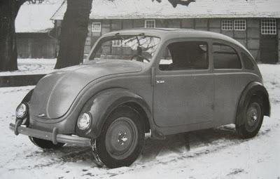

Are you kidding? This is gold! What book is this?
This picture is of the steel NSU 32, before the front was modernized with the ugly small fixed units. Compare to the pic from Porsches Yard, no bulges in the fenders there. It would be interesting to know when the modification was done!
Note also that the big custom Wanderer has the same headlight treatment as the Zundapp 12! So the NSU 32 and the V1 V2 and V3/1 were actually retrograde in design development with their separate headlights, for cost considerations, no doubt! This type of integrated headlight fixture was otherwise a hallmark of the Pierce-Arrow, a luxury car from USA.

PostPosted: Sun Jan 08, 2017 4:07 pm    Post subject: Re: Which one is the proper NSU type 32? Reply with quote
Blue Baron wrote:
Another interesting fact, as shown in Dan Post's book, is that the steel N.S.U. originally had much larger external headlights, and the small, flush-mounted lights were added after the war.
BlueBaron, do you know when they actually were added? Now that we know how they looked, it would be interesting to know if it was done after a man traded the car for a brand new beetle in the fifties!
In Norway we have a quite strong museum law, written or unwritten, regarding ships, houses and other technical items. If the item has been modified for use, it should be kept in the modified condition to preserve the history of the item. In this case it is a question whether it was done by a private owner or the VW museum. My guess is that the modification was made when the car was prepared for the VW museum, no doubt to make a point for the continous line of the beetle design. History falsification, I would call it. If the car was driven by a private owner with those new lights for some time, OK. If the car had the front changed and then put in the museum, it should be reversed.
Not that I am expecting the mighty VAG to follow my advice.
