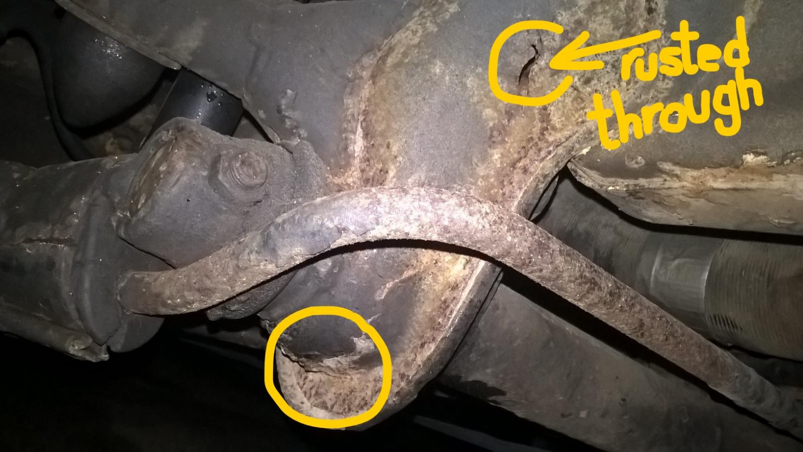

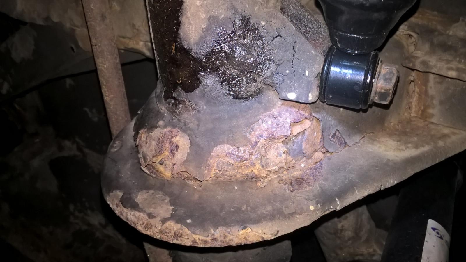

How much rust is too much? Should I replace the beam? Weld that completely rusted through hole? The other areas are flaking. I drove it like this for about 1k miles. Thank you

That beam is shot! You need another one. Lets just say you can weld up the holes. There is far more rust on the inside you can not see that is ready to complicate matters more. Please be safe and get another beam.
X2
I would NOT drive that bus with that beam. There's still lots of good, non-rusted ones out there for sale in the dry SW USA.

Yeah , it's done. The problem is it has to come off to be de rusted and evaluated and once it's off, it's cheaper to put a dry one on.
Have a good look at the attachment for the swing lever. If that goes, your steering goes INOP.
It's dangerously rusted. Remove from service.

That beam is totally shot. You need to find one covered in oil or one from a wrecked Bus. Do not waste your time on that beam. It's toast and will cost you or someone else their life WHEN it fails.

You need to call Busted Bus, Avery's or some other southwest or west coast wrecking yard and order yourself a replacement beam.

That beam is toast. Better call Chuck and see what is in his yard with a good beam.
