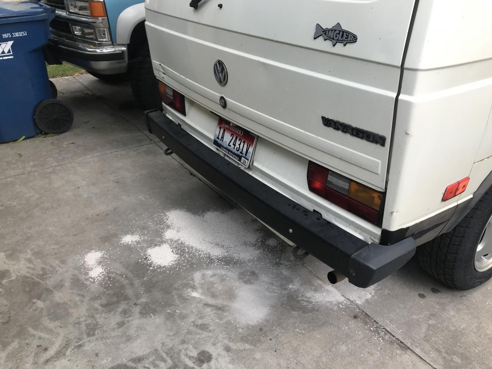

Finally going to put the rear rubber strip back on after getting a new bumper (was rear ended).
I searched, I looked in the Bentley, and I could probably do an educated guess, but if anybody knows the hole diameter used for the press-in clips I’d appreciate it.
Also I assume these holes are centered (between bumper top and bottom) on an imaginary line between the bolts that hold the bumper to the brackets?
Thanks for any info!
-Rob

I went for it and just kept leveling up bit diameters until it fit right. 5/16" is the ticket for future reference. And the holes all do share the same center diameter as the bracket bolt holes.

At time of purchase I did not see an option for a pre-drilled bumper from GoWesty, Van Cafe, or BusLab. Most sold (for around $100) are of a thin steel gauge. I ordered the Heavy Duty version ($165), which is actually the same thickness as factory, so I could comfortably stand on it without worrying about warpage among other concerns.
It is notable that during drilling I measured (with dial caliper) the distance between the pre-drilled bracket bolt hole centers and top of the bumper and found they were off from each-other by about 2mm, and the bottom bracket bolt holes were off by about 4mm. That explains why I gave up on inserting the bottom bolts when I first installed it. I used a Dremel to get the holes where they should be and all 4 bracket-to-bumper bolts are installed now.
