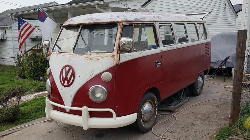

my first split. 1967 13 window deluxe
74volksrodwv
Joined: September 02, 2014
Posts: 68
Location: Nitro, WV
74volksrodwv is offline

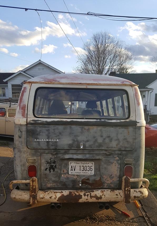

PostPosted: Mon Feb 27, 2017 4:55 am    Post subject: my first split. 1967 13 window deluxe Reply with quote
Im very new to the split world, only reading through these pages drooling over everyones great buses. Well I fell into my opportunity last week. A friend of mine was trying to talk me into his 71 westy and jokingly I said im done buying VWs for a while(I already have 4 at the moment) unless I happen across a split. He pulls out his phone and says well I found this one and they would sell it. Fast forward a couple days, I go out there, knock on the door, no answer. neighbors said theyre at church but I can see it out back just sitting there where it had been for 2 years. Wait and wait but no one comes home. Finally I left them a note with my name and number asking them to call me when they get in. We went out the next morning and talked to them and looked it over. They bought it in Arizona and drove it home to WV then took it back to Arizona for a vacation. They also had the original 1500 rebuilt as a 1641 with dual port heads the year before they parked it. I offered them the cash I had in my pocket and we made a deal. Went back out this past Saturday to pull it out since we were trying to give his yard a day or two to dry up so we wouldn't destroy it. I took my bag of tools, battery, new fuel line and a can of gas. It fired up on the third crank and I actually drove it out! it had no brakes at all so when I got to the street I was working the emergency brake. being from out west its really dry and very little rust. Theres bondo in a couple places but after knocking it out it appears to be from body work that didn't straighten it out enough instead of hiding rust holes.. Theres a couple places that need addressed and some surface rust that I will clean up. The biggest irritation is all those popouts were sealed up with silicone. Ordered all new seals for everything except the windshield which had been replaced and were still very good. We even found some buses by the bridge windshield stickers on it once we cleaned them up from around 2004 and 2005. I decided to try and get the faded black spray paint off of it and get to the titian red underneath and underneath the black was more black with green ferns stenciled across the whole thing. why, just why.... But its under there, I can see it starting to come through as I take this new layer of strange paint off of it. Overall it needs some love but Im still beyond excited and cant wait to start enjoying it.

PostPosted: Mon Feb 27, 2017 7:28 am    Post subject: Re: my first split. 1967 13 window deluxe Reply with quote
Nice pull...
The silicone seems ugly and inconvenient now... but up to this point... think of it as having helped avoid more rust.

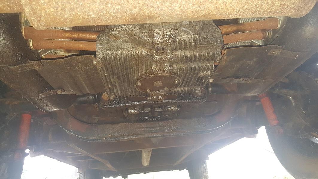

Welcome to the Club! Buy and correctly install all new brake components before anything else. It's got to STOP well before it can GO anywhere. Think of you family's safety and the others around you before you work on anything else. Read up a lot on this forum, tons of good info, buy a Bentley Workshop Service Manual for your Bus, it's the best! Have fun, fix/repair one thing at a time and pretty soon you'll have a nice, safe and collectible "runner".

PostPosted: Mon Feb 27, 2017 6:12 pm    Post subject: Re: my first split. 1967 13 window deluxe Reply with quote
I choked up a bit seeing that roof vent but lets face it - the person who put that it also took good care of that Bus, so they redeemed themselves..
Nice find and good luck with it!!

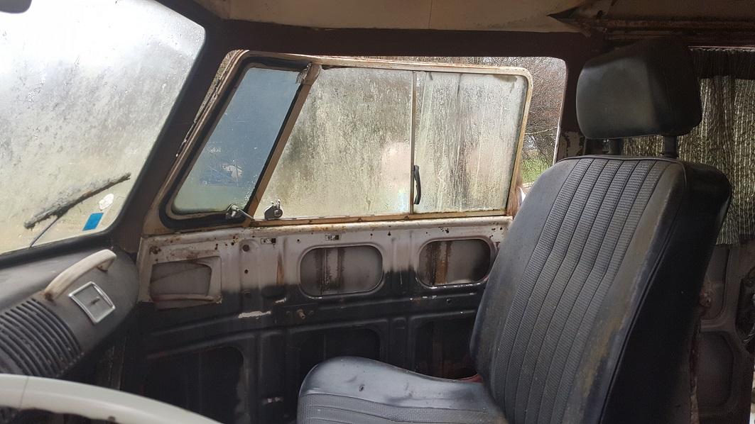

Well it doesn't feel like its been less than three weeks but we're moving along. mostly small stuff just cleaning up here and there changing out connectors and bulbs. I still have to go through my headlights to find where my problem is so they will come on. Also discovered that unless you hold the turn signal just right the passenger side rear signal/brake light wont work. So that's going to come apart to get cleaned and probably connections soldered. Other than that everything is pretty good. We ordered a bunch of seals for the doors and all the pop outs.
I did discover that the bottoms of most of the pop outs aren't rotted away but they were rusted just enough that the bottom of the outer frame seal wont stay in the frame when you pull it shut so I'm not sure where to go on that one yet. may end up getting new ones or trying to reuse these somehow. These windows probably hadn't been opened in over 9 years.
Talked a bit to Sehilliard1 and he came down to swap some parts. I now have a killer rear and middle seat and rear bumper.
Not long after he left I got a text from the previous owner saying they had a couple boxes of parts in the garage I could have if I wanted to come down and get them. I was beyond pleasantly surprised to see my nose emblem, original seat hardware, pop out latches, dwell meter, timing light and other goodies.

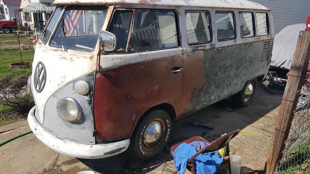

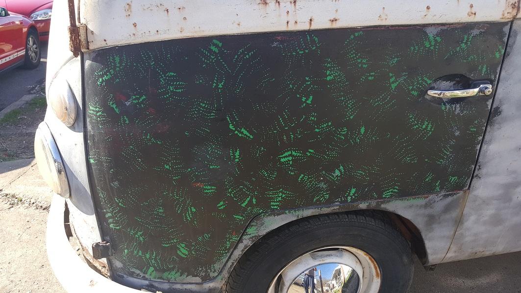

We knocked out all the bondo of the nose and its not perfect but its really not bad at all in comparison to some others I've seen. Sprayed some rust mort to kill anything trying to start and hit it with some primer for now. Ordered the clips I needed and got my emblem and rear script clipped on and it just looks so much better now.

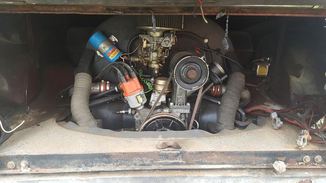

I pulled my engine this past weekend to rebuild my carb, replace the throwout bearing clips and trans mounts. found the manufacture date on my transmission which I thought was pretty cool.
Everything is rolling along at a pretty good pace now. the back seats still need to come back out so I can kock out that surface rust and treat it then get some paint on it before the cargo floor mat goes down. I have fought that black and green paint with no luck until Saturday night. We took some of the suggestions I found here on the samba and decided to try Goof Off graffiti remover and wow, it made short work of it. before ya know it that OG titian red will be back. I'll worry about blending in the nose and rear drivers corner once its all stripped down but I'm happy with the progress so far.

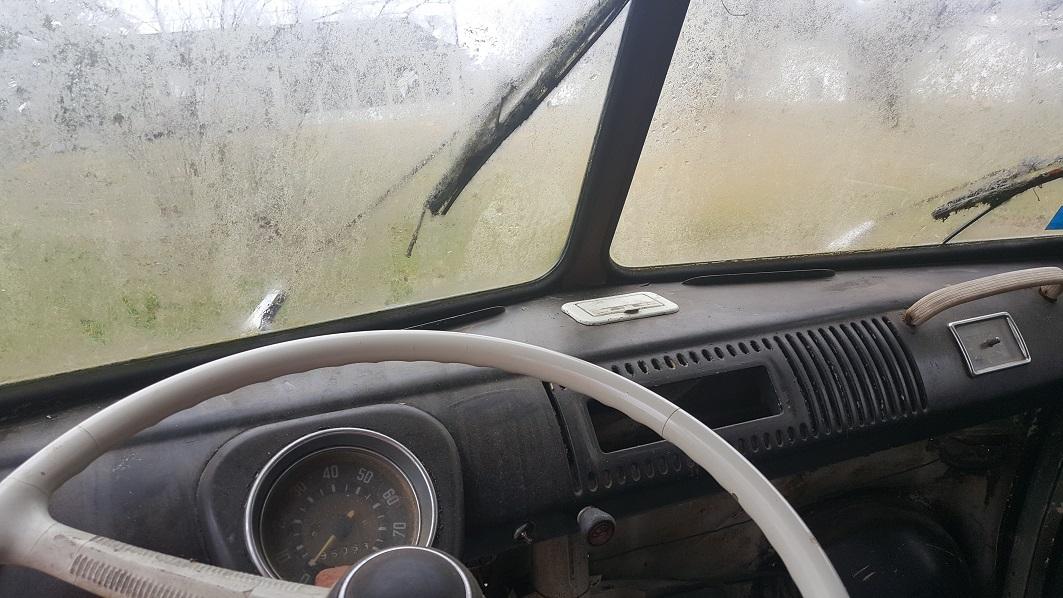

Still chipping away at it and making some good progress. Mechanical is lined out, brakes are working as they should, so now were moving on to some of the fun work.
took everything apart on the dash. We used jb weld steelstik on the steering wheel, sanded it and repainted it. I tried to strip the layers of paint off the dash but sadly when it was painted the first time they took it down to bare metal all across the grill so we just gave it a good coat of paint as well.

PostPosted: Sat Apr 01, 2017 5:02 pm    Post subject: Re: my first split. 1967 13 window deluxe Reply with quote
Actually yes i did. I packed the steelstik putty into the cracks as good as i could. once it dried i sanded it smooth, scuffed the whole wheel and gave it a couple coats of paint over a couple days
You can see some of the cracks in the wheel. some were pretty bad.
putty packed in waiting on it to dry
sanded down and wheel scuffed up
first coat of paint done drying overnight

PostPosted: Mon Apr 10, 2017 12:43 pm    Post subject: Re: my first split. 1967 13 window deluxe Reply with quote
Forgive me if I missed something, but why are you replacing the whole nose? What can be seen looks way nicer than most.

PostPosted: Wed Apr 12, 2017 4:10 am    Post subject: Re: my first split. 1967 13 window deluxe Reply with quote
It is very nice honestly. The nose has more bondo in it than I wanted to get it smoothed out. It looks like sometime in its past they hit something with just the towel bar judging by where the dent in the nose is. But they tried to pull it out and straighten as much as they could. I hammered and used the football trick to get it as best I could but it still has more bondo than it should. I may just throw my hands up and enjoy it for a while and replace it at some point down the road. Spending time working on these out in the driveway is my way of keeping sane in a house with three children but Im ready to get out to cruise ins and car shows.
But that god forsaken roof vent is still making me twitch. I hate it with a passion but I've been putting off messing with taking it out and putting new metal in. Mainly because it doesn't leak and my buses stay outside in my driveway due to my lack of garage.
