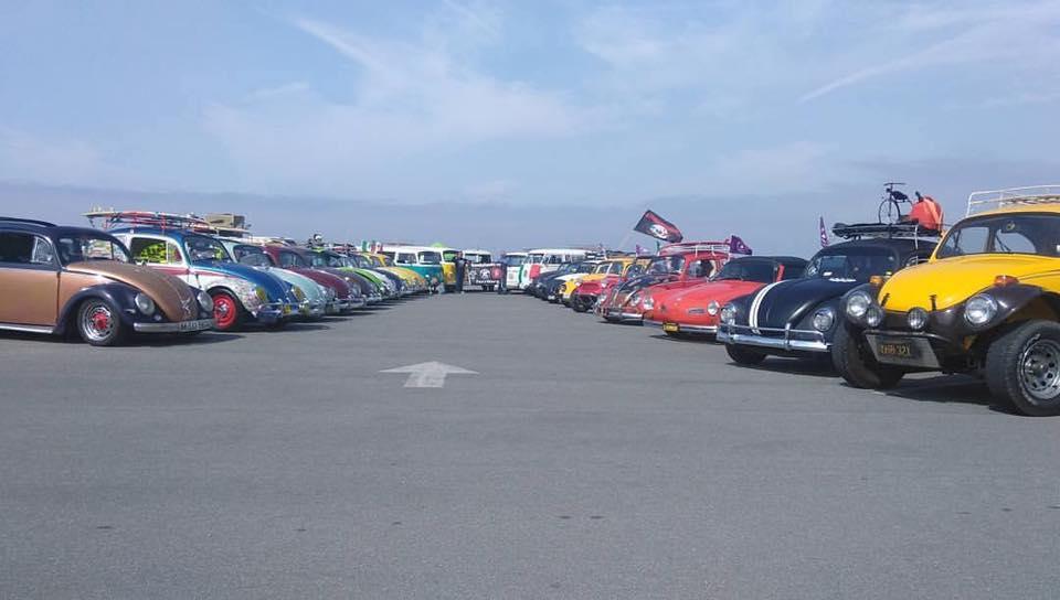

Ive done a few things Got a rack and changed the front shocks. Been driving it a lot. Weekend trips with the club.
This was our meetup last weekend at Half Moon Bay. Real nice drive from the east bay if you ever get a chance.

PostPosted: Tue Sep 19, 2017 10:27 pm    Post subject: Re: Introduction and 1971 super beetle resto Reply with quote
Love half moon bay! Like seeing all those vw sitting there. Need to drive up next time you guys are all going there!
Of course Jimbo
Next year mexican independence day we will be there. I will keep you posted when it rolls around again.
Next weekend is a show in Santa Cruz. My kids are super excited to go to the beach again.
