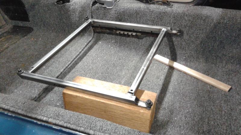

This is a thread about installing late model seats in a 1967 type-3 Fastback.

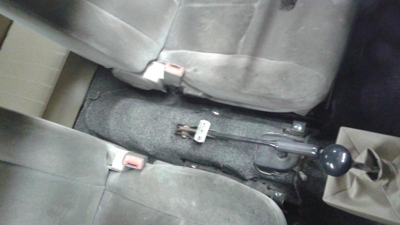

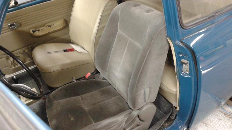

Here are the original seats, recovered by this cars PO and his son. Not too bad a job, but I need something a little more old-back friendly.

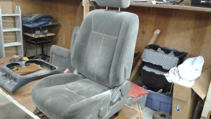

The new seats are from a 2004 Suzuki Verona. They will get recovered to match the rest of the interior.

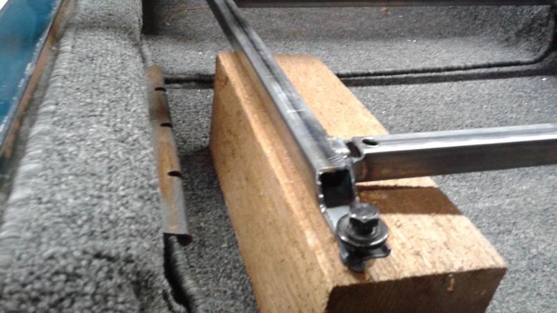

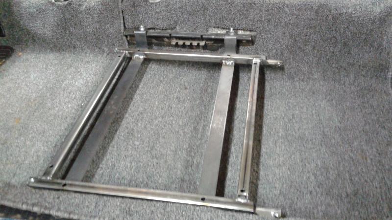

My first thought was to mate the Suzuki seat to the type-3 base using a little frame I fabbed up. But just putting it on the top of the seat base leaves the seat several inches too high.
My little frame will survive, but I may need to cut down the base somehow. Back to the drawing board. Wink

Thing is, I already have these seats and I like-em. Plus, any seat that fits in a beetle is too narrow for my type-3. Wink
New plan. Bolt the inboard side of my bracket to the rail and extend the outboard side to reach the lower rail.
Tomorrow, more welding.
Max

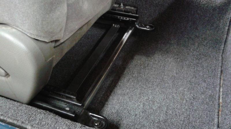

PostPosted: Sun Mar 12, 2017 11:03 am    Post subject: Re: Suzuki Seat in a type-3 Reply with quote
Success! My wife and I agree that this lower position is better than what I had been thinking. And I really like having the modern ball-bearing mewchanism to move the seat fore and aft.
Now I'm off to make the right side mount.

PostPosted: Sun Mar 12, 2017 4:22 pm    Post subject: Re: Suzuki Seat in a type-3 Reply with quote
Done. Well ... except for cleaning the seats. Wink
Plenty of room between the seats for me to make a nice console.
I totally understand about OEM seats, especially early ones. I did the 2006 Berg Cruise sitting on stock 63 Beetle seats and was all but crippled when I got home. 7110 miles in three weeks.
