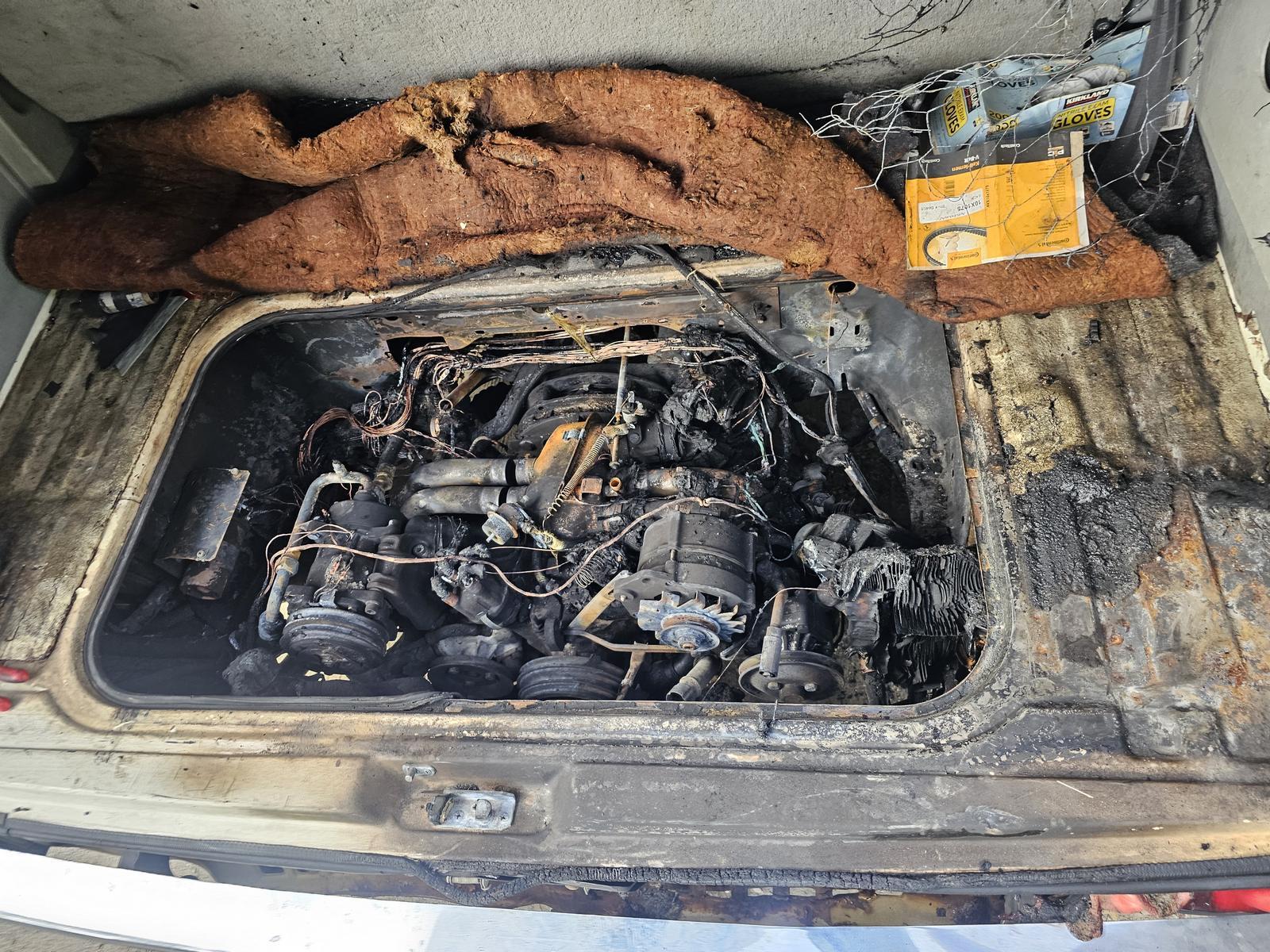

perhaps more than one, my wifes carat had a blazecut in it, the 12', if there'd been a longer one, l'd have had a longer one in there.
it might well had been enough apart from one issue, the wire from the alternator down to the starter, the fire had burned off the insulation, so there was a dead short, l believe it kept the fire alite.
the fire dept flooded it with water, TBH they did more damage to the body, than the fire did.
no attempt was made to locate the battery and cut a wire.

our fire l believe was caused by those plastic fuel injector rails.
as they were the ONLY un-upgraded part of the system.
l have a plan to solve the other issue, testing is required.
