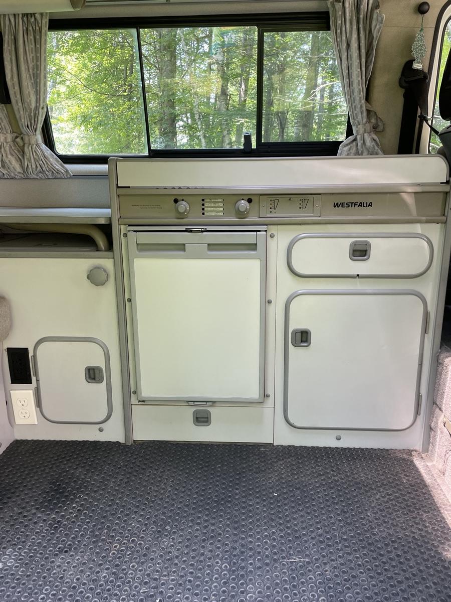

I’m very happy with the Dometic CX50. Uses about 25Ah per day, barely can hear it. And it is cold enough to keep ice cream frozen solid!
I really like having space below the fridge for more storage.
Bottom pic is with the almost completed vinyl floor.
