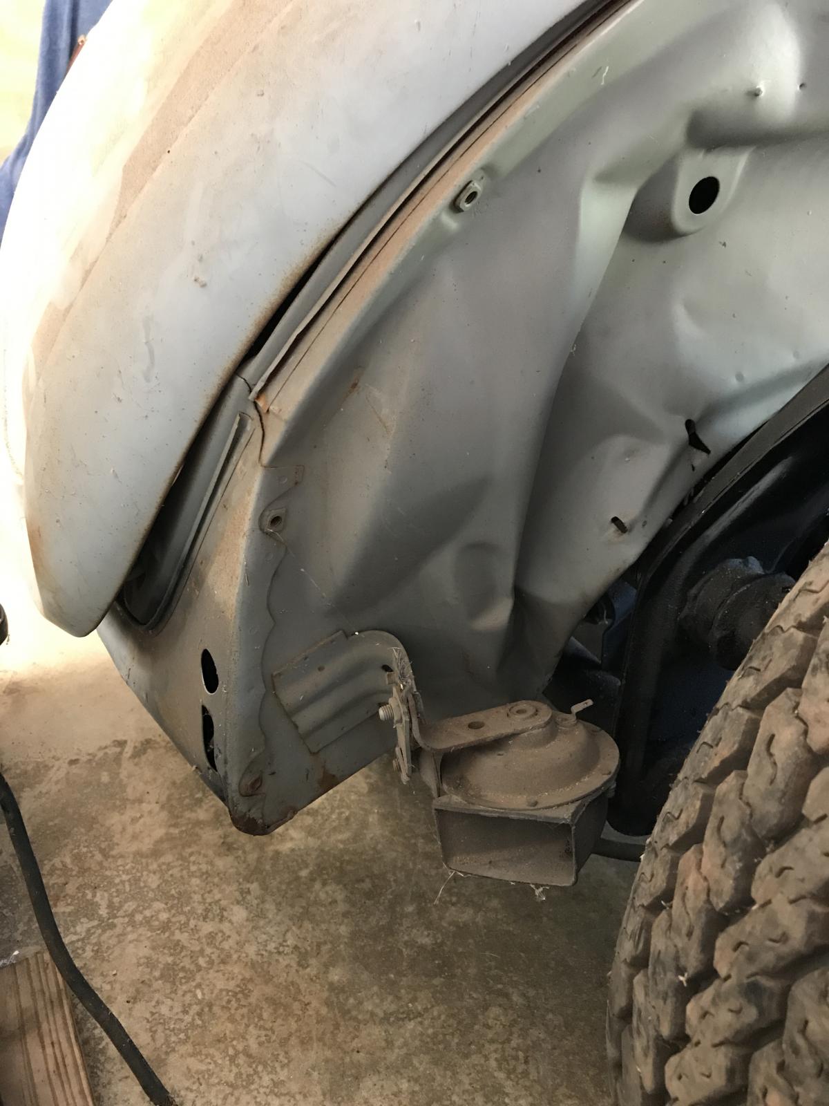

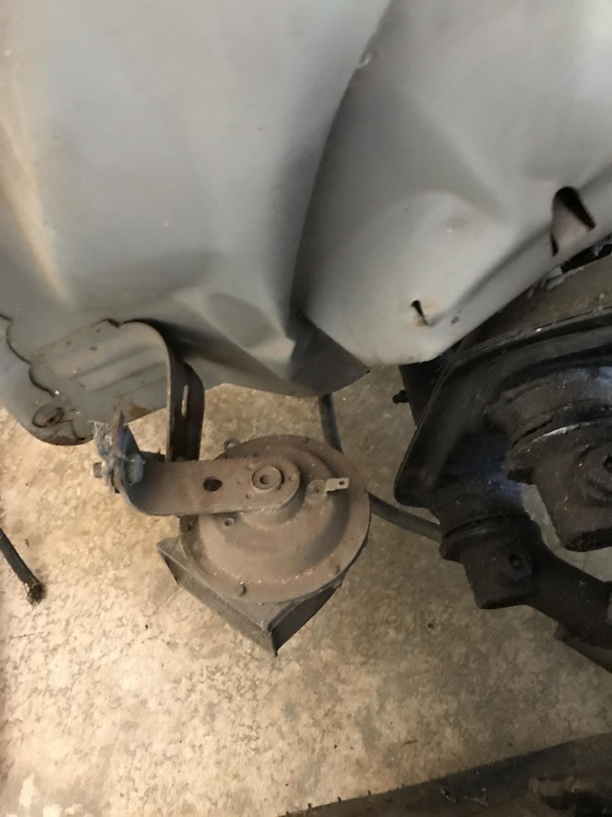

Located in South Carolina. Just needing the front clip/apron. Mine is damaged on the driver side into the wheel well. Found a clip on jbugs website for 189. Didn't know if anyone had used any of their stuff.

Ok. So from the damage I see on my car it appears that I could do an apron and the small portion of the inner wheel well from ww instead of the whole clip like I assumed I'd have to buy. In the parts diagram in ww it's number 25. Is there metal a better fit than the others?

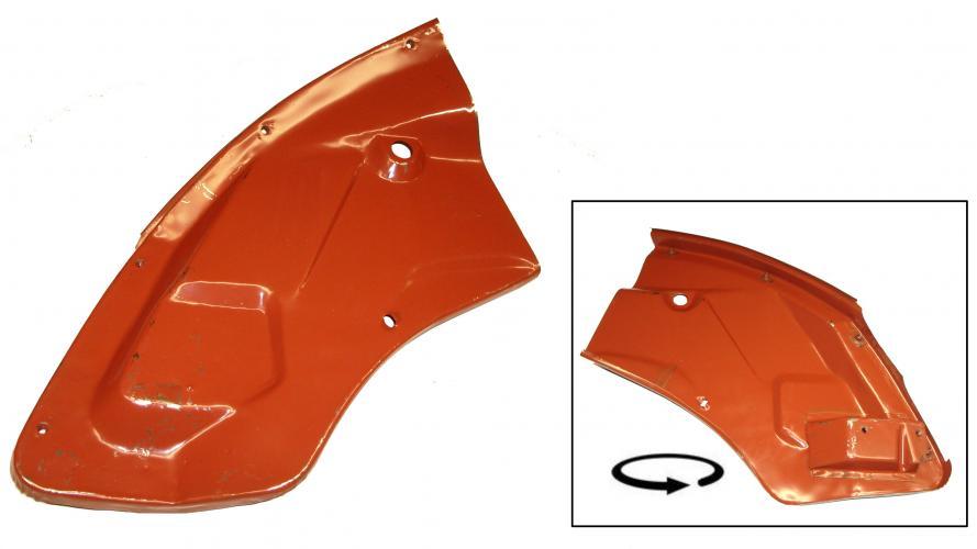

For instance , notice on the orange repair panel . . .
The "weld-nuts" for the fender bolts do not match what your car has!
Where's the "bulge" for the spar tire?
Is the repop bumper mount even close to looking like yours?

Here are some better pictures of the orange repair panels, to compare with your car:
https://www.vwheritage.com/113809111bq-inner-wing-repair-front-left-t1-beetle-1200-1973-red-hd
https://www.vwheritage.com/113809112bq-inner-wing-repair-front-right-t1-beetle-1200-1973-red-hd

I would personally not use the orange panels. I used a pass side A pillar and it was GARBAGE. did not fit at all, metal was super thin, and had to cut apart to reshape and fit to the 62 i was working on. for a cheaper way go with the black Klokkerholm metal, its not great but it is workable. if anything buy original metal. and what 57blitz said, fix it! i have fixed several like that with a frame machine or just a chain and a lift pole. get it nice and straight. i usually replace the apron skin. easier to replace than to fix.
