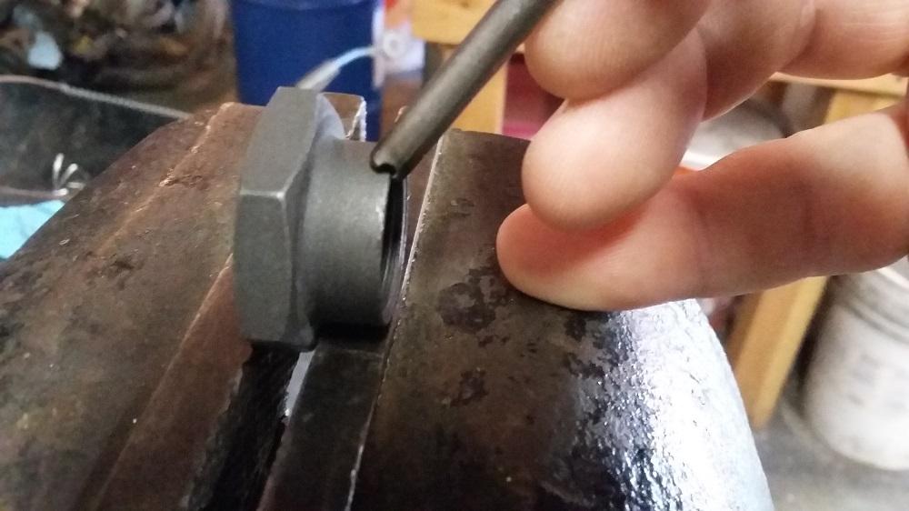

Here's a handy tool. It's a modified 5/32" punch. I simply took a 5/32" punch to the grinding wheel at a very aggressive angle to make this tool. Occasionally I dress it with a file or at the grinding wheel.
This tool is used to remove the front spindle nut. Simply tap it into where the nut is locked down and drive it down. The modified punch will follow the groove in the spindle and press out the lock cleanly to where you can unscrew the nut by hand. One should never remove these nuts with an impact gun or ratchet, doing so can damage the threads on the spindle and make the new nut difficult to put on. This modified punch makes the job super simple and it's incredibly easy to make.
5/32" modified punch profile:
Ready to work:
-Kevin

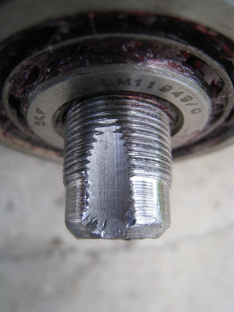

Nice piece of work! When I first started reading the post, I had already imagined what the picture would look like. Then I saw the image, and it struck me as an opportunity lost due to my idea that the process would put the nut back into round. In my head I had the flat side of the tool placed against the spindle, and letting the rounded side work the nut back out to round. Seems like the machining of the spindle has the flat edge built in.
EDIT:
Needs clarification. Found two images that now make me wonder if I was seeing things when I looked at my spindles... these images from other users seem to show two different kinds of machining on the spindle ends!
Rounded:
Flat:
61Scout
Joined: November 06, 2011
Posts: 1297
Location: Shoreline/Yakima WA
61Scout is offline
PostPosted: Wed Jun 21, 2017 9:07 am    Post subject: Re: Modified punch tool for removing front spindle nut Reply with quote
Hey all. Just wanted to do a quick update and show the companion tool to this one. This is the tool I use to create the peen on the end of the axle nut. It's a 3/16" punch with a straight slot cut in the end from a cut off wheel. It's perfect for catching the lip of the nut and doesn't move around when you peen it down. It keeps the peen right at the end of the spindle shaft (where it should be and not over the threaded portion) and also won't mess up the spindle or split the nut like a chisel might. Here it is:
As bobbyblack correctly noted, the groove at the end where the nut gets peened is round/curved. Thanks for posting that! This is why a modified punch is so effective at driving the peen off of the nut. It's like a little ramp. The slot on the side shown in the second picture he posted is where the washer keys into.

If a 5/32" punch can't be found, a 3/16" one should work for the unpeening punch too. Not sure I'd go much larger than that however since the tip of the punch does have to get down deep sometimes to unpeen the nut. For the peening punch, the size would be far less critical since it's only working from the outside. It's really just whatever is handy.
One note/tip about the unpeening punch... Be gentle when using it. I mean, don't just go full on gorilla and pound it down. Light taps then pull it out, light taps then pull it out... use some oil for lube, check the nut often. The last thing a guy would want to do would be to get it stuck or worse yet break off the tip down in the groove. That would be like dealing with a broken tap, a complete PITA for anyone who has dealt with one. So use caution and go slowly. Dress the tip if it starts looking rough.
As far as modding my mod... well, whatever works. I understanding trying to work the nut back into shape. But of course once the unpeening process has started the tool can simply be flipped over. Then the flat side would be on the spindle and the round side would be towards the nut. Or perhaps just modify a third punch. I think you can pick up a set at HF for around $10... or yard sale, grandpas tool box, and so on.
