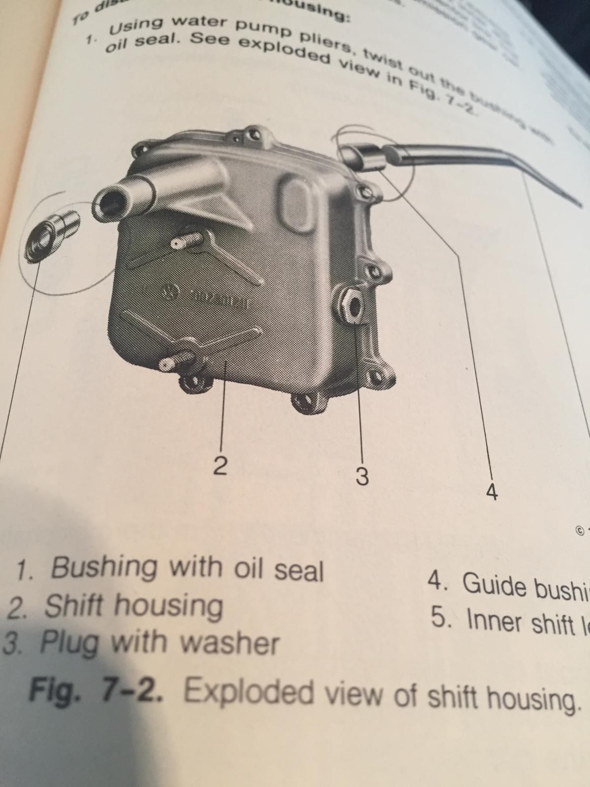

Per working on the tranny nose cone components,
Should I also replace the two bushings circled in the photo?
If so, can high quality parts be found. I read a lot about the poor quality of parts these days so wonder if it's better to stay with a better quality part or newer but of questionable quality?

I wouldn't go replacing bushings if the old ones are good, but the seals yes. Note that there are early and late nose cones that take different parts, so verify what you have before ordering. Never assume that engine and tranny parts for your model year are going to be correct, things get swap over the years.
You can get decent tranny parts from places like German Transaxle in Bend OR.

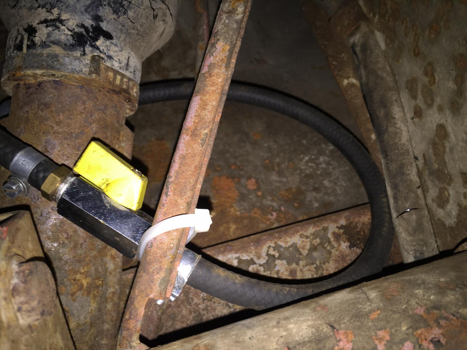

While in there, I would put shut off valves on the gas lines from/to the tank. Makes changing fuel filter easy
Shift bushings
Would you mind expanding on this method? Photos? Thanks.

Well- I'm not an expert but when I replaced my fuel lines and moved the fuel pump out of the engine bay, I read about how others suggested it be done here on the Samba. I assembled this valve from a gas valve and barbs found at a trades plumbing supply house. The hose originates from the spigot at the bottom of the tank, loops around to the valve, on to the fuel filter, the pump, and to the carb.
The two photos show the way this was plumed.
I've been running it this way for about 6 moths and it's been working reliably.
Hope this helps.

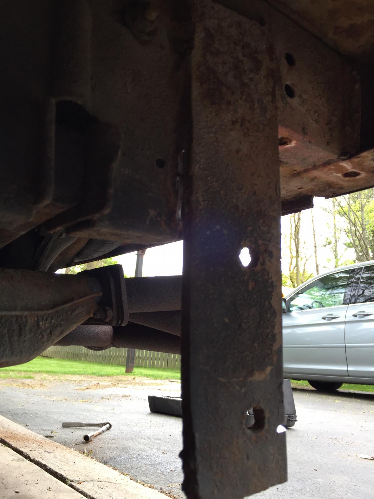

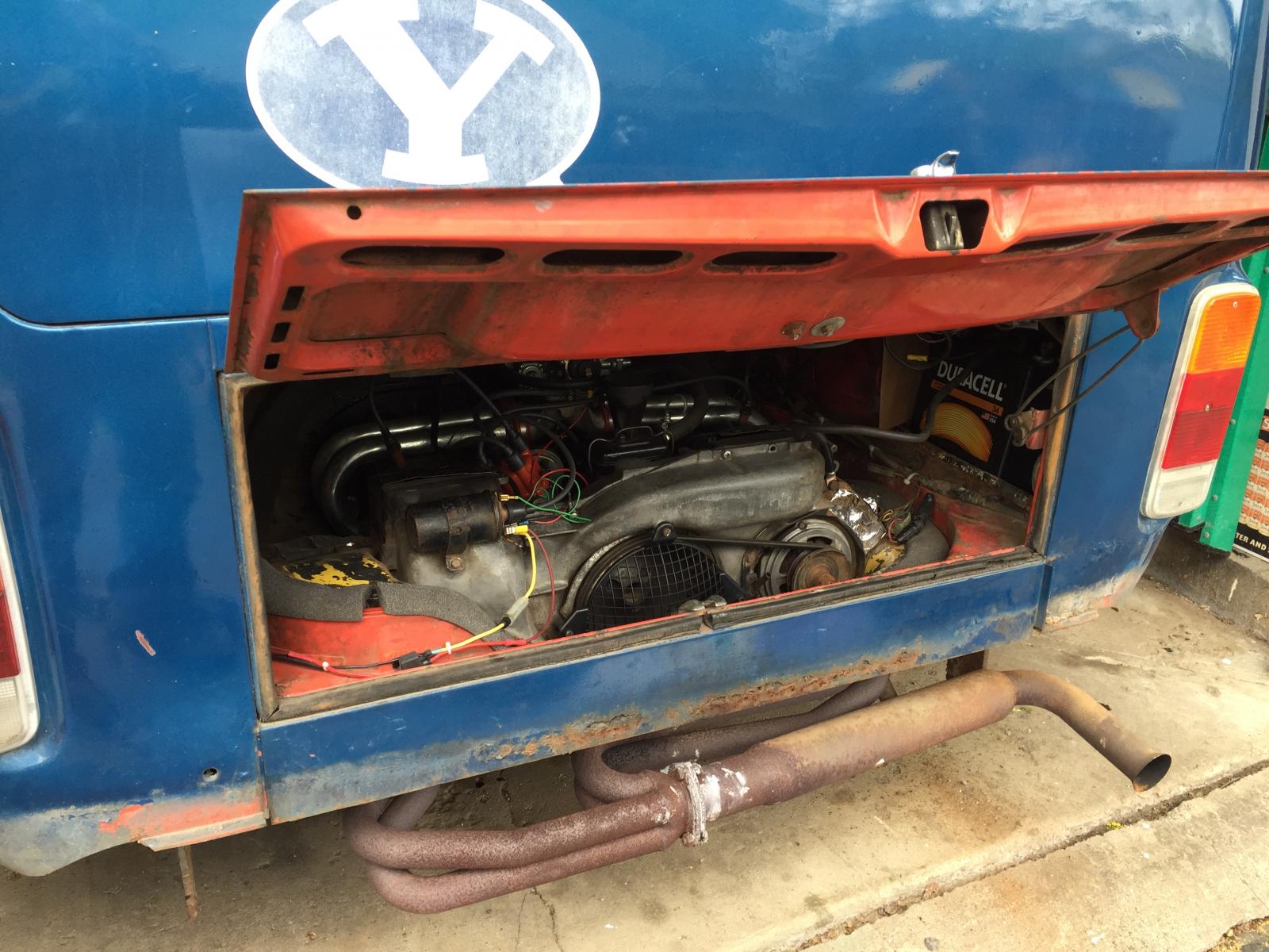

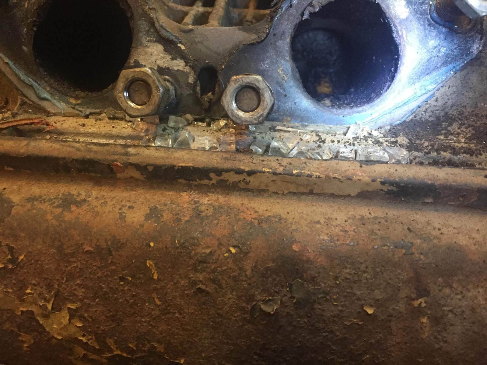

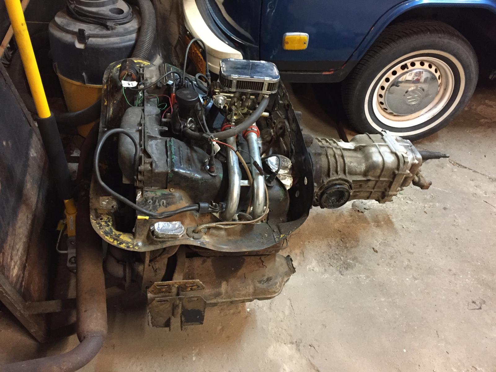

Ok....I did it. Thanks to great advice here and lots of studying, I dropped the engine and tranny tonight. Now to get to work on the jobs I've identified. I'm sure I'm going to need more help so I'll use this thread to ask questions, post pictures, etc.
This photo shows a PO homemade trailer hitch that was welded to the engine mounts. I had to grind off the weld to free up the mounts.
Removed the back bumper to reveal some rust issues I hadn't seen before.
The engine/tranny resting next to the bus. I'm surprised how much taller the back end is with out all that weight.
More to come.... thanks for all the great help received here.

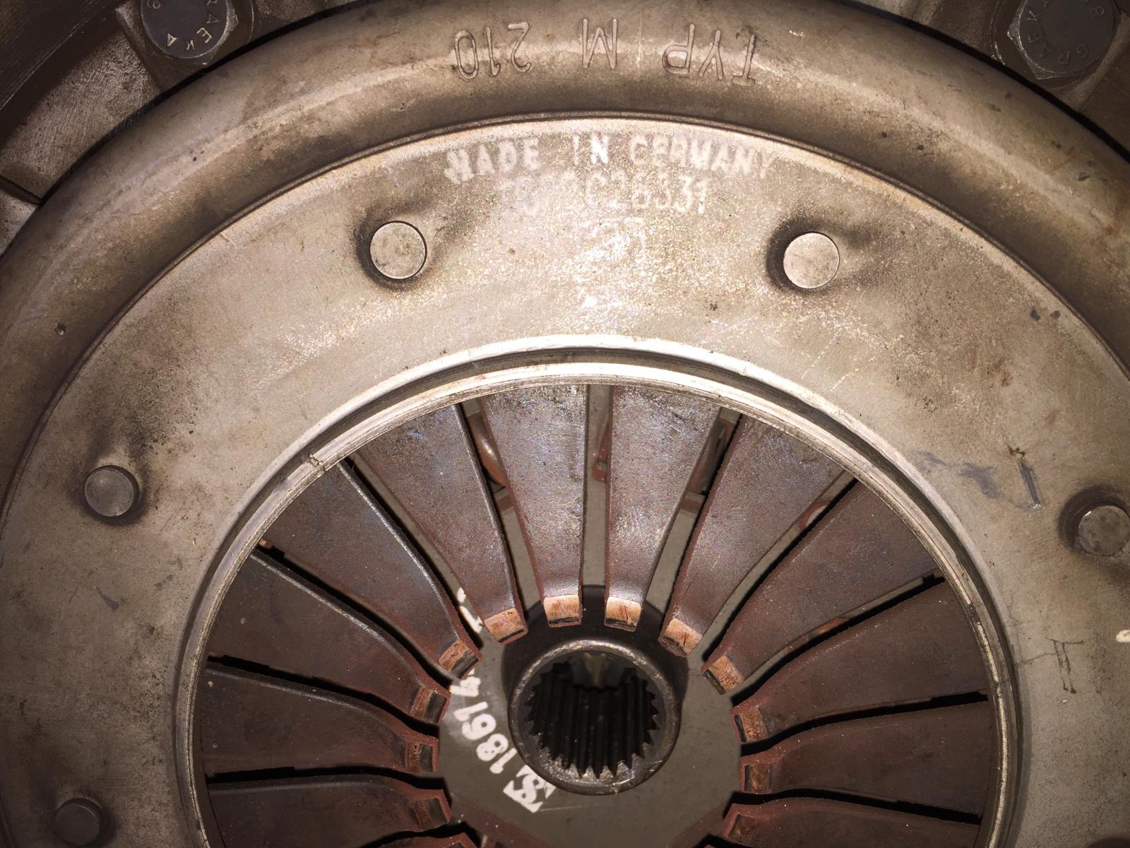

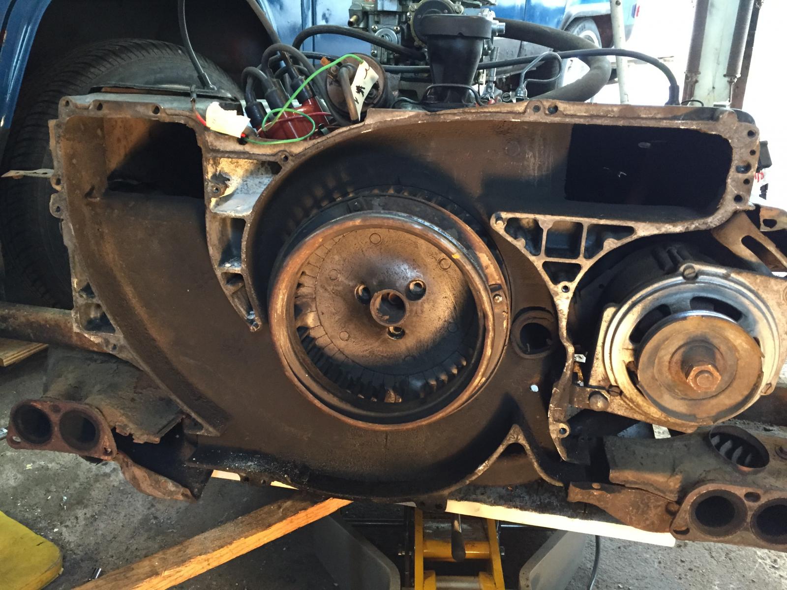

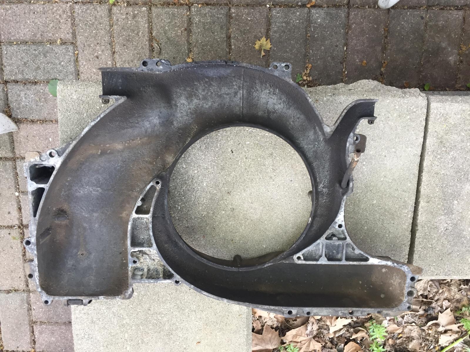

Here's an update. Was able to spend a great deal of time today. I separated the engine and tranny. Took a couple of photos of the clutch and bell housing. Found a small stray piece as seen in the bottom of the bell housing. Not sure what this is or where it came from.
Here's a couple shots of the clutch. What am I looking for to assess its condition. I think there is a date from 1987 stamped on the plate. Not sure if this is correct, only a guess.
I removed the carb, dizzy, coil, etc so I could remove the top engine tins. I'm sure this is typical but discovered a stash of hazel nuts on the 3/4 side. There is a lot of crap in the fins - I did my best to vacuum out all the junk.
Can I use an air compressor to clean out the jugs/fins?
Removed the front fan shroud and the three bolts for the cooling fan. So far, have not been able to remove the fan. I see a 13mil nut/bolt in the center of the fan, do I need to remove this before getting the fan out? Any advice as to how to remove the fan would be appreciated.
I sprayed the front fan shroud with Gunk/degreaser - it didn't do much. What else can I do to clean the shroud?
After removing the single carb, I could see into the engine - looks pretty dirty to me. Is this a ticking bomb? I have not planned to do a rebuild at this time but am planning this for my next engine drop after I can study/learn/prep.

First off you should wad up some paper towels or rags of some sort and block off the intake ports so you don't get all kinds of crap down in there.
The soot inside the shroud isn't going to hurt much, but something like carb cleaner should loosen it up a bit. If you want to increase flow then you need to smooth out all the casting marks with a rotary file and/or lots of elbow grease.
You need to remove the clutch cover from the flywheel to inspect the disc and the wear surfaces of the cover and flywheel. I would recommend that at a minimum you replace the pilot bearing and the clutch disc no matter how good either appears to be. Before removing the cover you can measure the clearance between the release fingers and the cover with a set of feeler gauges. When this clearance reaches zero the clutch is totally shot.
A small screwdriver and a wire brush will get most of the stuff out of the fins. A good blasting with compressed air will work as well.
Your intake ports are probably okay. Run something like Sea Foam in your gas from time to time to try to keep deposits down. Running synthetic oil will help as well.

Thanks Tcash. Right after I took the photos I stuffed paper towel wads in the intake.
So the plate on the outside with the 'fingers' that come to the center - is the the actual clutch plate? Is this what I should replace or is it an internal plate behind this one?
Also, any suggestions on how to remove the cooling fan?
