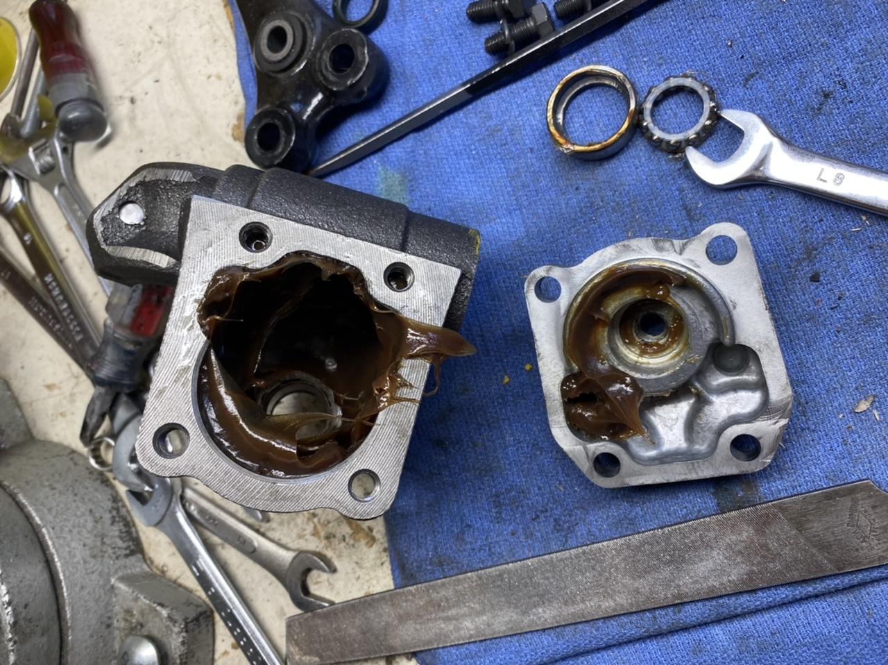

I did not do the Freeway as I want to bleed the brakes one more time. I also ordered a Dakota Digital CHT as what I have in there was not making me comfortable, didn't seem to be working. Dakota seems to be the only one that compensates for the cold junction so I ordered that.
Steering box was a little free but they all feel like that to me. I will try to tighten it up just a bit.
The steering wheel feels great to the touch but seems huge compared to the other cars I drive most of the time.

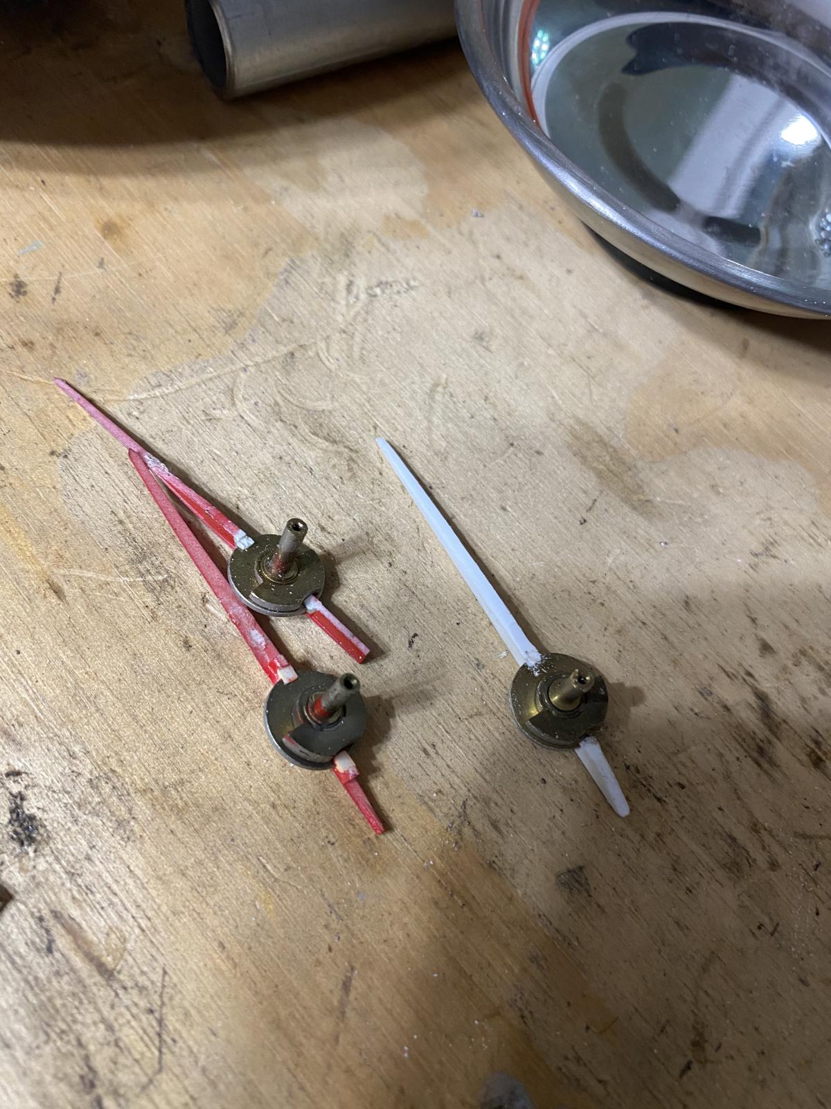

Hours to get the speedo out... Mad
Opened it up and it appears it had been taken completely apart in the past. Something tweaked inside spinning cup I couldn’t figure out how to fix. Luckily I had some cores that I could pick through, was able to put together what seems to be a working unit.
Needle broke so I am making another.

PostPosted: Thu Jan 21, 2021 11:37 pm    Post subject: Re: February 1963 with sunroof, actually just boxes of parts LOL Reply with quote
After reading about the steering boxes and the Corn head grease I figured I better open up the new TRW box. Trying to turn the worm shaft about ripped the skin off my hand. Opened it up and found this
Fairly thick grease was injected through one filler hole and filled about half the box. The worm gear adjuster had no grease under it. The roller shaft adjuster did have grease.
Cleaned everything put parts back in and filled it up with Corn Head.
Tomorrow I will paint the box then it will start going back together.
I checked the original roller shaft and it was in spec. Worm shaft looked good. Ball bearings measured 5mm but I don’t know what they should be. I could not find wear grooves on shaft. Picked up new seals at Wolfsburg West and I will put back together once I determine what to do about bearings, replace or not. I can get it adjusted as is without maxing the screw so I will probably put back together. Always learn how to do something a day late.
