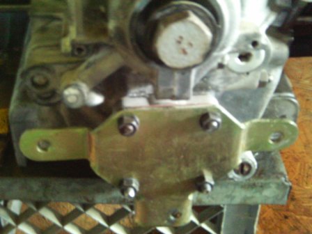

ZENVWDRIVER
i had to use this adapter when fitting a 1500 bug engine into my 1968 bay bus...
Engine Mount Adaptor
http://www.busdepot.com/0091480

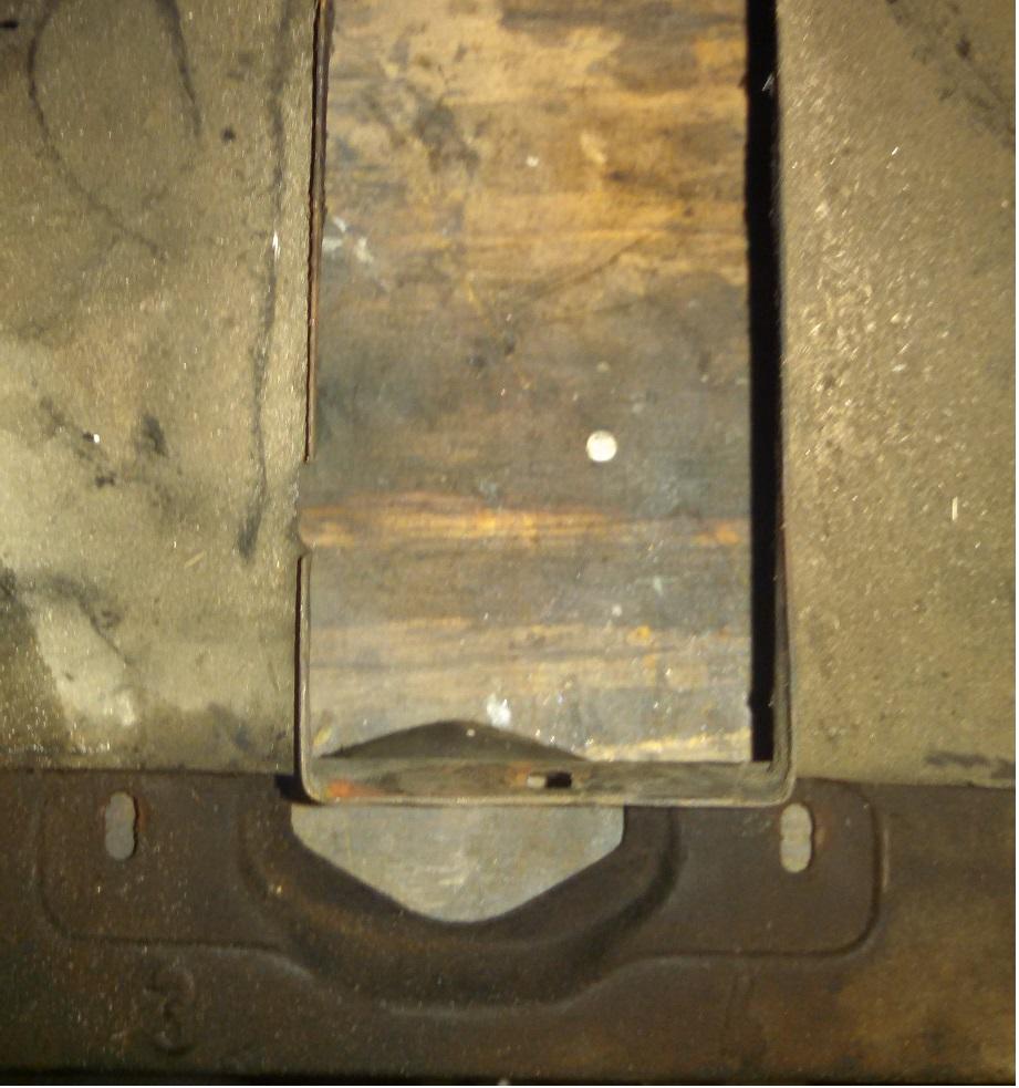

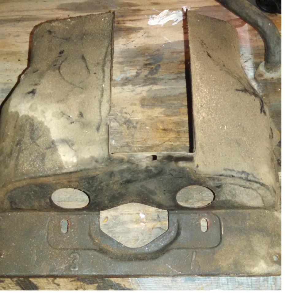

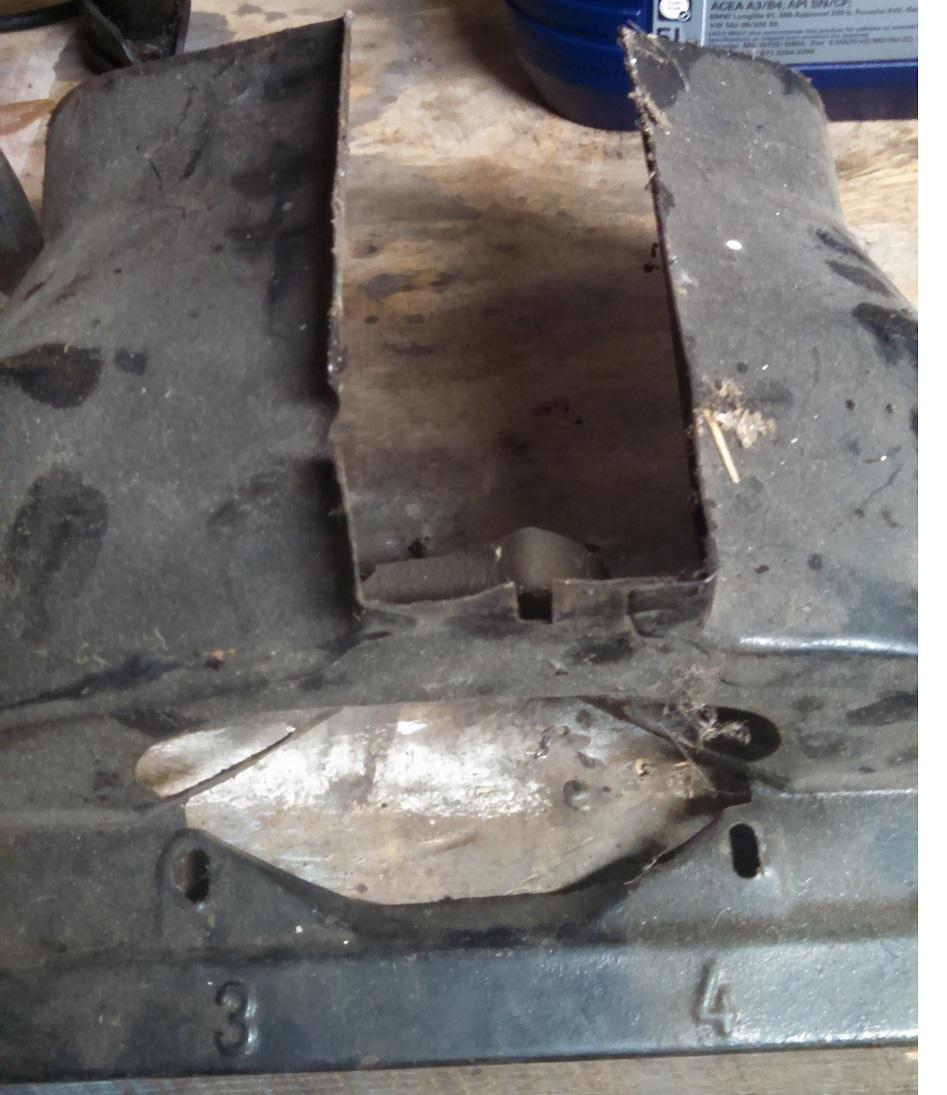

PostPosted: Sat Jul 29, 2017 9:33 am    Post subject: Re: Summer engine into 68 Westy - questions Reply with quote
It looks like you slid right down that slippery slope. Very Happy
FWIW, use the cylinder tin that matches the heads.. single port or dual port.
You can fit doghouse on non doghouse on either SP or DP. I have long been a fan of doghouse on a single port.
The bug front tin is shorter than the 68-71 front tin shown in the pic above.

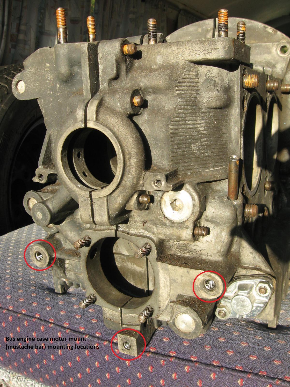

That adapter non-sense will leak shortly after install. There is a way to make it work, you need a thin nut between the adapter and the oil pump plate. Then the second nut as shown. It may require a longer stud

They don't call them adapt-a-leaks for nothing!

The case does have the bosses, just need tapped. I do have an adapt-a-leak plate, just in "case".

Well, you're gonna need the '68 thru '71 moustache bar to get your distances and/or spacing correct if you decide to drill and tap yourself. Ideally, I would install timesert's or keensert's in the 3 locations. You would just need to know the depth of the 3 holes.
I have the moustache bar that I will use in the bus so I should be OK there. I may just go ahead and use timserts there. That is a good idea.
