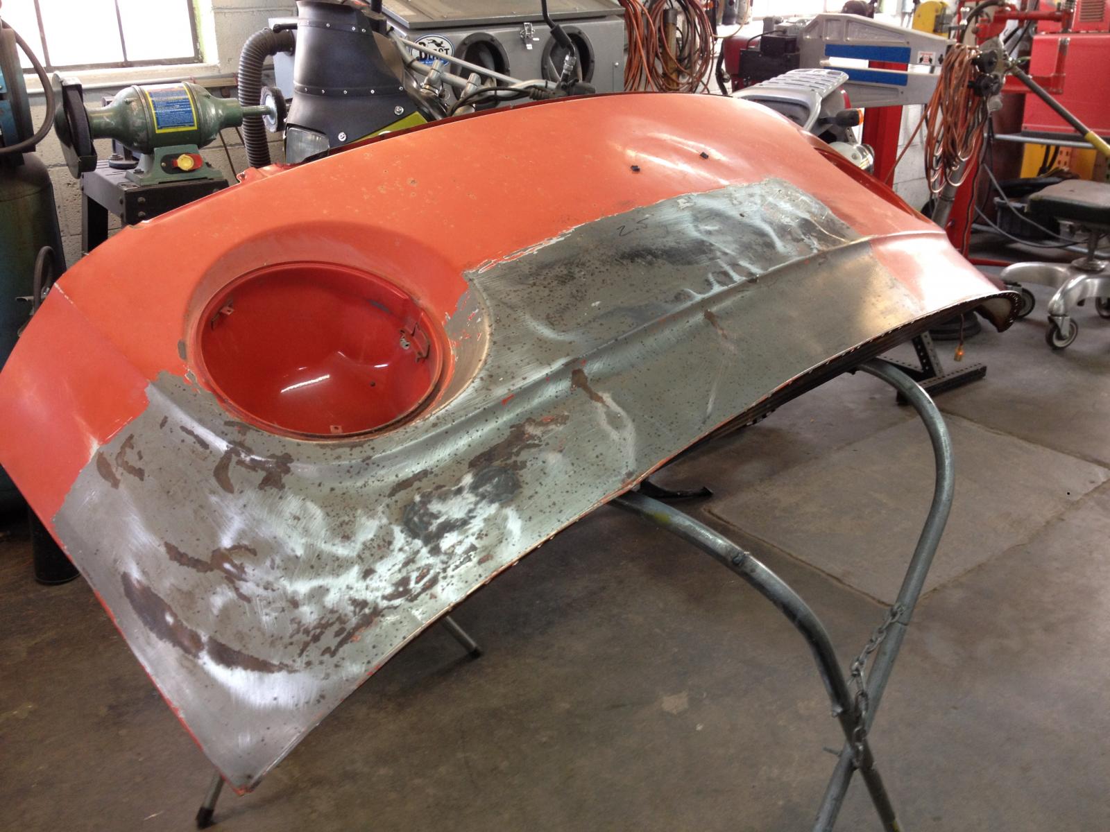

Hello all. I thought that some of you may have an interest in what goes on at my shop, Bulli Klinik. I'm a long-time Bus guy, having owned Buses since '86. I've had everything from a 58 Westy to an 87 Syncro Westy and have serviced and repaired them all. I opened my shop a little over five years ago specializing in sheet-metal repairs and fabrication as well as complete restorations.
The nose on this 74 is one of the final projects on this Bus prior to it going out for paint. I'll try to post information about doing this on your own as I know the substantial learning curve in this kind of work. Maybe it will aid some of you in doing your own restoration or maybe it will sway you bring your project by my shop! Smile
The nose on this Bus was damaged due to an accident. Though the Bus had a substantial amount of rust, the window channel is in decent shape with no rust-though. Metal finishing with the panel still attached is not an option due to lack of access. I decided the best course of action was to remove the lower skin.
The fastest way to remove paint is with a torch and a wire brush, though you have to be judicious with it's use. Clearly, you don't want to burn off paint in the middle of a flat, delicate panel. This is reserved for flanges and areas with enough crown to not allow the panel to warp. Run an oxygenated flame and brush it over the surface to burn the paint, then brush off. This also works GREAT for undercoating. Hold your breath or put on a respirator...
I prefer to use this style of drill. It has a split tip and works better than a spot weld drill. Use the smallest size drill which covers the entire spot-weld. A clean cut will prevent damage to the panel.
A sharp bit makes for quick work.
The upper cut was done with a 1mm cutoff wheel.

Here's what I'm working with.

I have a lot of hammers and dollies, but these are what I used for the majority of the panel.
There were a few stretched areas that needed some heat shrinking.
Though this obviously isn't the nose panel, his planishing hammer saves a lot of hand work and gives a very nice finish to the panel.

I got the majority of the panel smooth with the planishing hammer, but there is always some hand work to do in the detail areas. After hammering, filing and sanding:

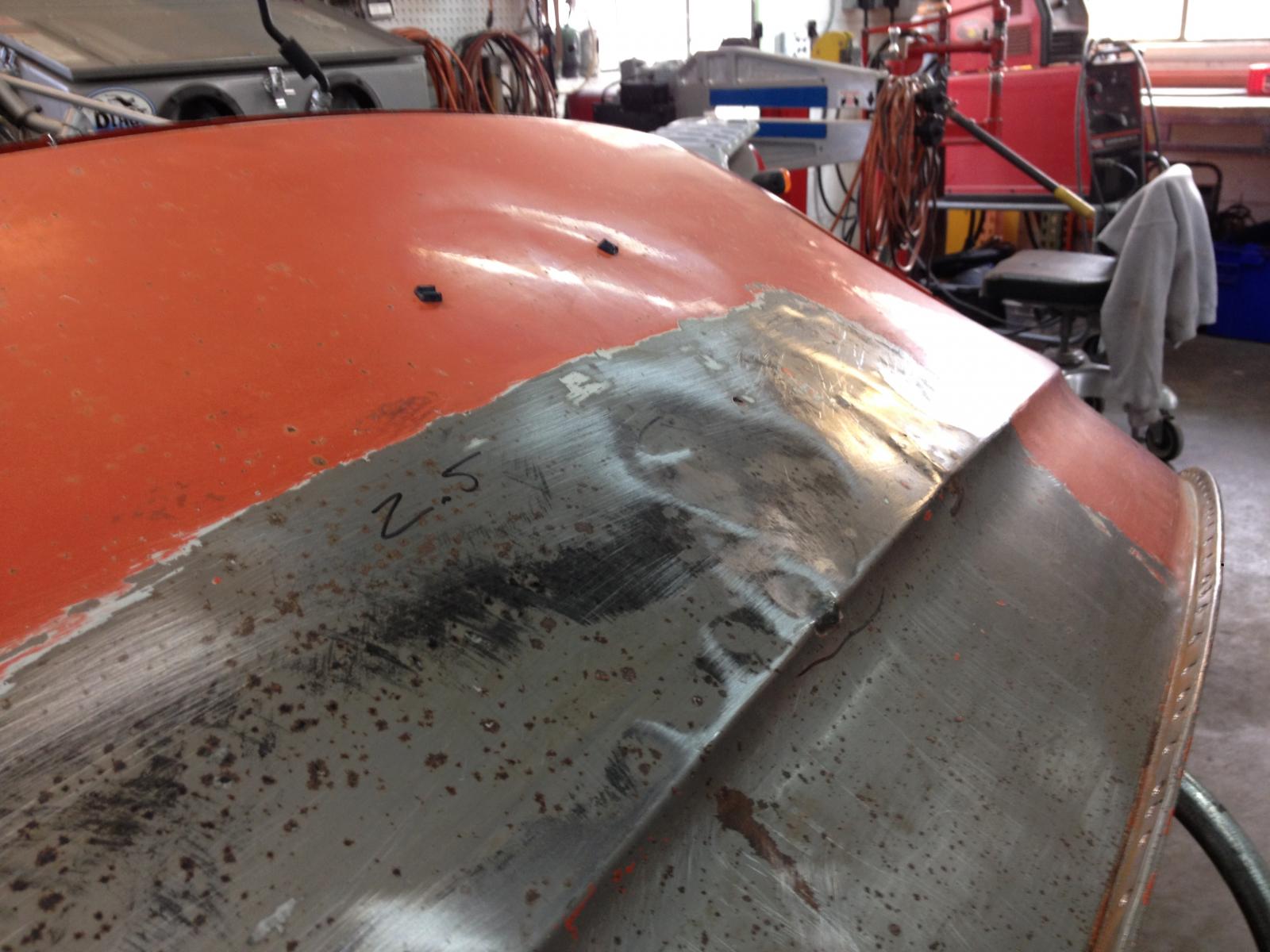

I prepped the lower flange by sanding any surface rust away and blasted the lower flange of the panel as well as any burned paint areas on the backside. that was followed by a phosphoric acid treatment and a coat of 3M Weld-thru.
The panel was put back in place, cleco'd and tacked in preparation for TIG welding.
That's all for now. Looking forward getting it welded and metal finished early next week.

Lil' Lulu wrote:
Love the mic stand torch holder. Thought I was the only one. Laughing
I did sound for a living for a few years and have about 40 mic stands left. I use them for all kindsa things. Especially good for light stands that stay where you put them.
They really come in handy! I really like the idea of mounting some lights on them. Could you post a photo of what you've done? One of my favorite uses is as a paint rack. I drill a hole at either end of a piece of conduit and place it on the top of two stands.
Is there some info out here somewhere on this "heat shrinking"?

Paint stripper is nasty stuff...methylene chloride, xylene, base other goodies. Lots of fresh air ventilation please.
Heat shrinking metal is taught in intermediate and advanced metal working class...3-4 years in at our local place
There are a few good YouTube vids on it.

Thanks for the kind words. I love Buses and metalwork and I hope that it shows in the work I do.
Heat shrinking is used when the metal has been stretched, causing an increase in surface area. Once dents are bumped out, often times the panel is too bulbous in the area that was stretched.
An area about the size of a dime is heated at the crown of the stretch until it is glowing red. This area is more "fluid" than the surrounding, cold steel and with the heat, the area will swell up a bit. The surrounding steel is upset with a few hammer blows near the heated area. The force of the surrounding cold steel as well as the blows of the hammer will force the metal molecules into the heated zone, thereby causing the area to increase in thickness and shrink once cooled. The area is again bumped with hammer and dolly, then filed and metal finished.
There are many ways to shrink metal, but this technique has been around for ages and it's what I use most of the time. If you can get a dolly behind the panel while it's still hot, you'll have a bit more control. Some use a wet rag to quench the panel. Others say not to. I use a wet rag most of the time because I don't have all day to wait for a panel to cool. A wet rag will also increase the amount of shrink, from my experience.
