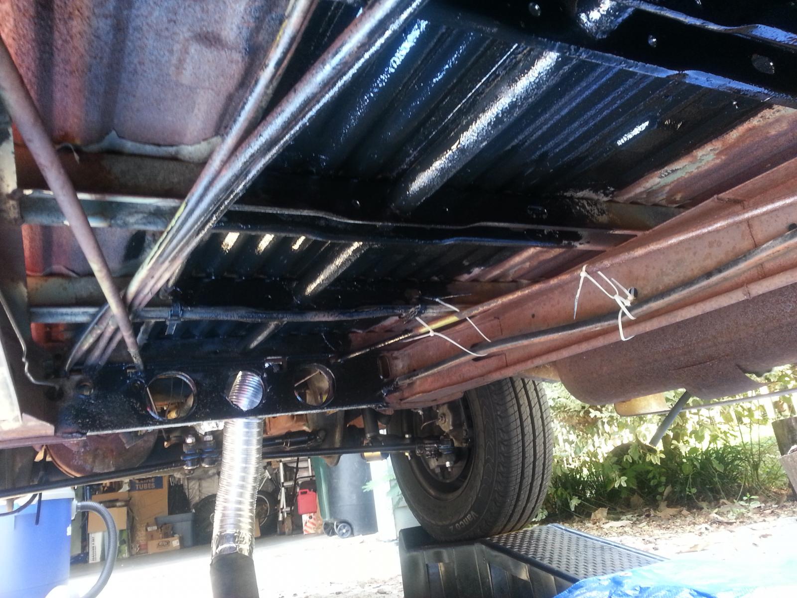

aerosurfer wrote:
Wanted to share my new heat tube version I did this week. The old diverter was completely gone, and the whole system was poorly rigged (incompletley at that too) from the P.O.
Cut out a like new diverter piece from a parts bus, and finally got around to crafting it all up.
from the Hardware store I used
Two 3"to 4" aluminum connectors
3" Piece of aluminum ducting, Came as a 5' section
4" flexible dryer tubing
3" flexible dryer tubing
Aluminum tape
Roll of Reflectix
First I only wanted to do this once (in theory) so I made sure to POR15 the underside of the floor and frame above where the tube will be
Then I welded the diverter back into position. The dryer tubing hanging down is the 3" tubing up over the beam to the heater tree in the cabin, partly wrapped in reflectix. The aluminum tape on the intake side of the diverter is to widen the opening as that will receive the 4" end of one of the connectors

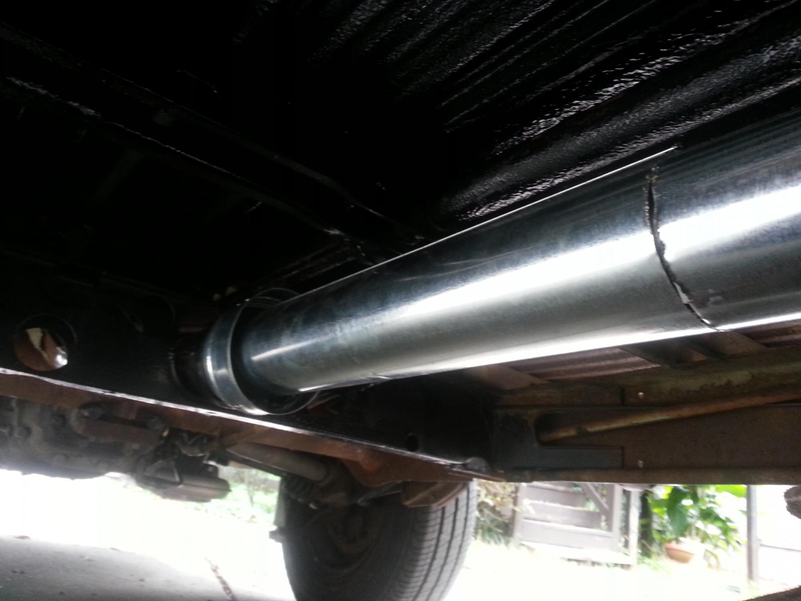

Now the 3" aluminum tube, cut in the middle to allow it to be snug in both ends

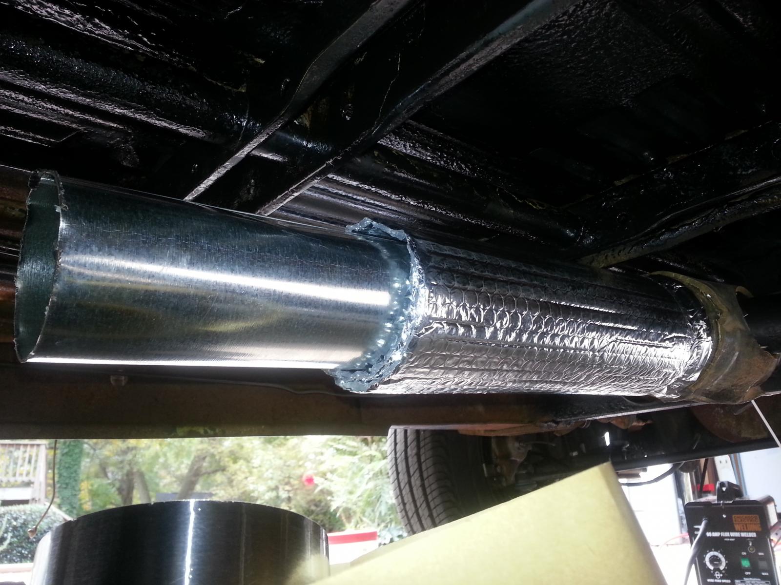

Started wrapping Reflectix in sections over the aluminum pipe

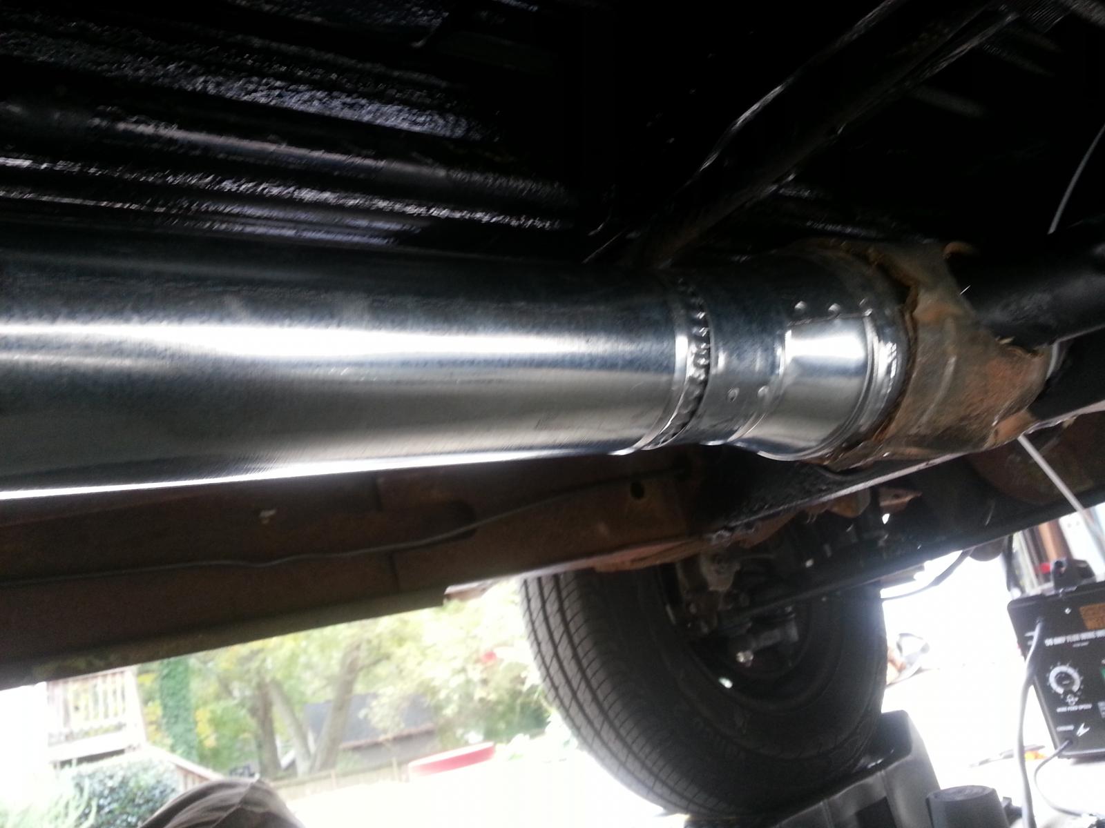

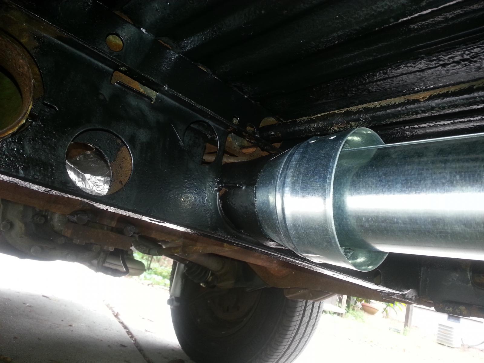

Off the the rear Y pipe I inserted the 3" end of the other connector into it. Once again with Speed tape on the outside diameter of 3" side of the connector to seal and snug it, then forced the other half of the 3" aluminum pipe into the 4" section
I was able to cut it so it was very snug in the gap. This I only used speed tape to seal the sections
On the rear part, the Reflectix slides snugly into the gap of the 4" connector around the 3" pipe. I didnt get a picture of it, but before I put on the other half of the pipe i slid the 4" dryer flex tube over the reflectix as additional insulation and protection. And all sealed up.
I still have some more reflectix to add the front hose, and I have to install and cover the other outlets in the diverter, but I can report the heat is very nice and pretty strong. Elsewhere in the system its sealed , but not perfect off the heater boxes and flappers. I had nothing to compare it to prior (in any bus), but it blows out of the defrost vent very well. I know some have said to delete the diverter junction all together, but it was such a perfect part and I was able to get the forward floor vent tube and a non broken cable for it. Still have to make something or use SCAT tubing for the vent under the rear bed
