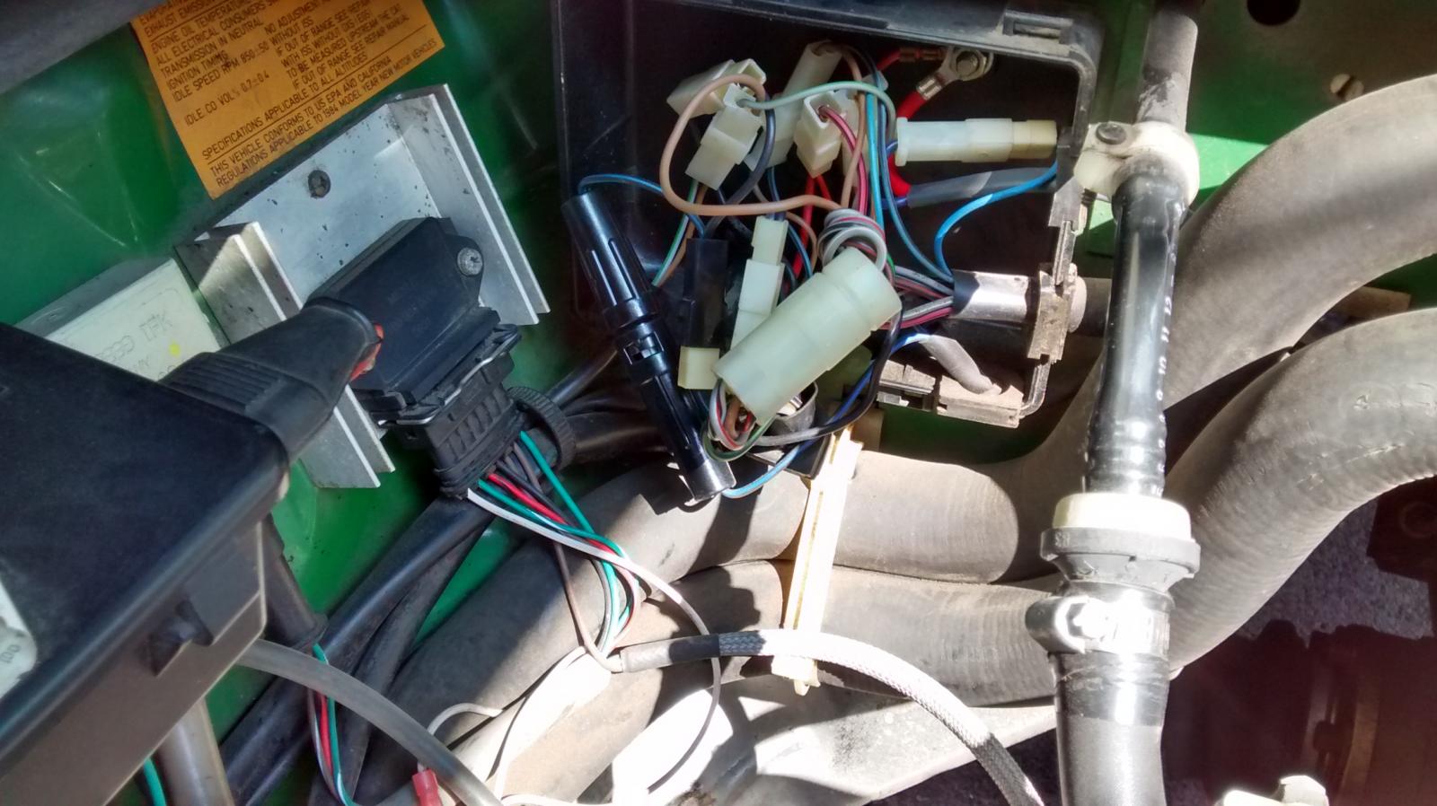

PostPosted: Sun Aug 23, 2020 6:48 am    Post subject: Re: 7-pin Trailer Wiring Reply with quote

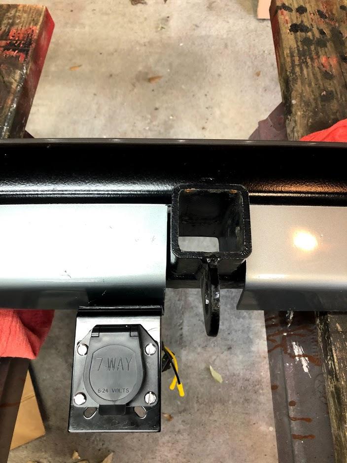

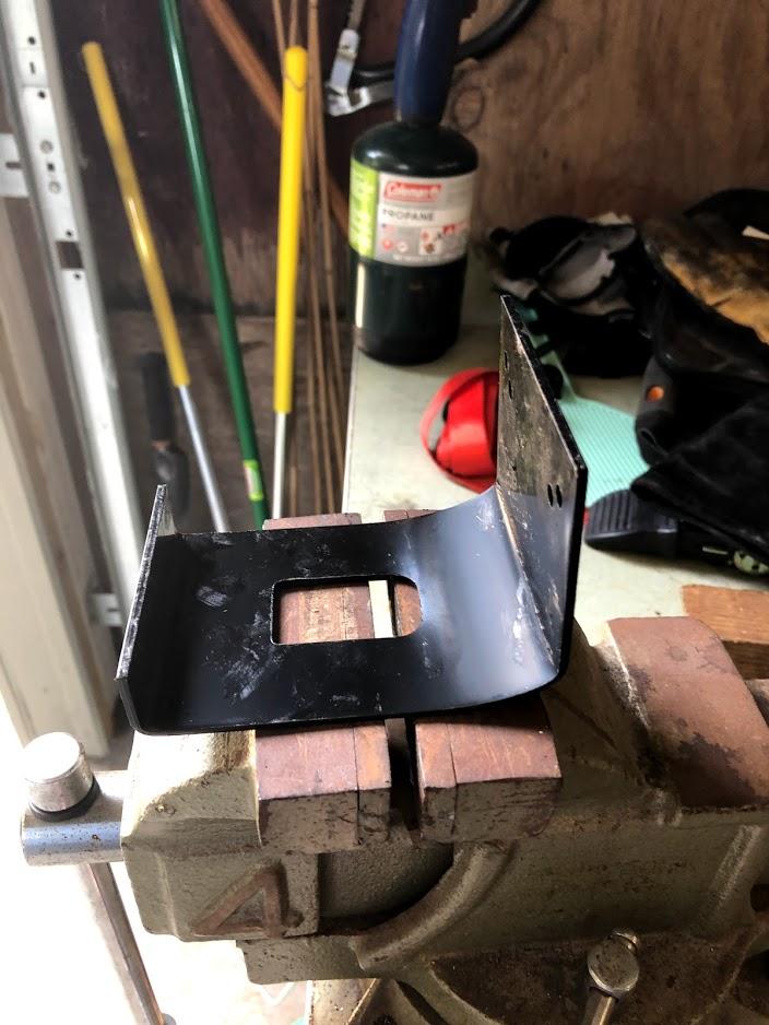

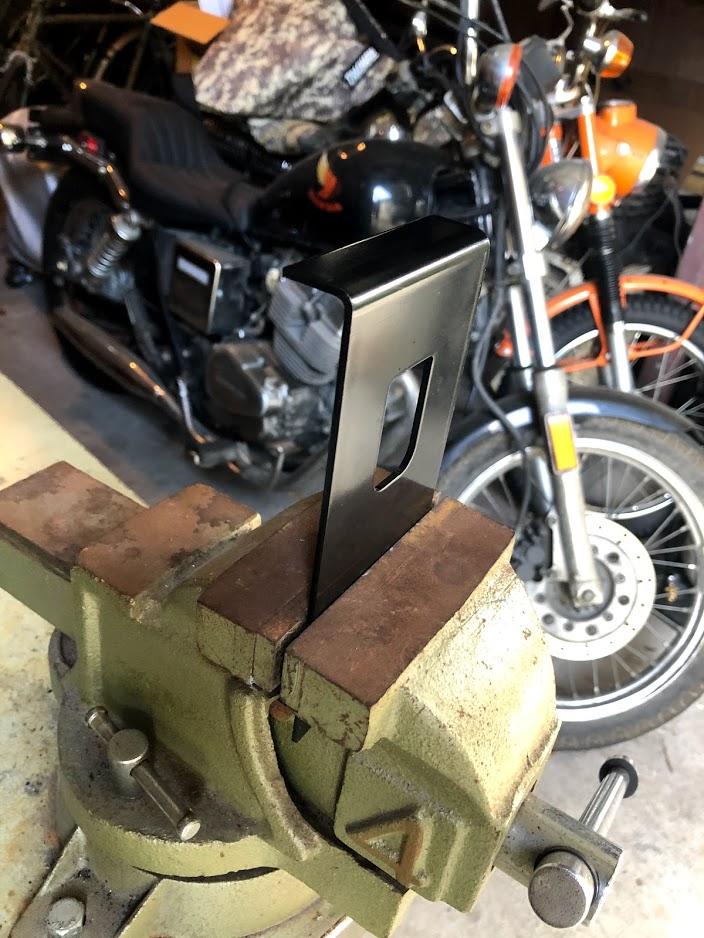

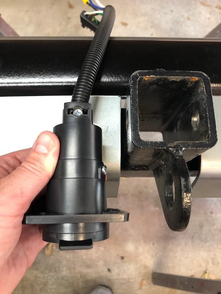

Well the bracket I hoped would work did not due to the size of the 7-pin plug and the odd chain hook on the RWM hitch.
I ordered some other ones to try and came up with an idea of how to attach it. The steel was thicker than I expected so it went into the vice and heated it up with a propane torch to add the needed bend.
With the plug mount attached, you see the final shape.
Some pics of how I attached it to the hitch, no new holes needed.
And here it is in action.
I also installed the relay kit off the alternator to charge the battery, was super simple. And thanks to Jay for providing an excellent plug and play product.
Ready to hit the road tomorrow and do some camping.

PostPosted: Sun Aug 23, 2020 10:32 am    Post subject: Re: 7-pin Trailer Wiring Reply with quote
Wiring for trailer lights is an easy task. That also includes taking the time to plan and do it with care.
Some of the Vanagons I have restored or worked on have had trailer lighting added in. All were completed by slicing into the wiring harness at the taillight. None were done with anything beyond cut and splice with PVC coated butt joints… oh, and electrical tape that is peeling off. Not very elegant.
So, to keep the connections WITHIN the OEM junction box takes some forethought. There is not a wealth of room in there for butt connectors and electrical tape! Here is what I did on my own vehicle:
Open the junction box.

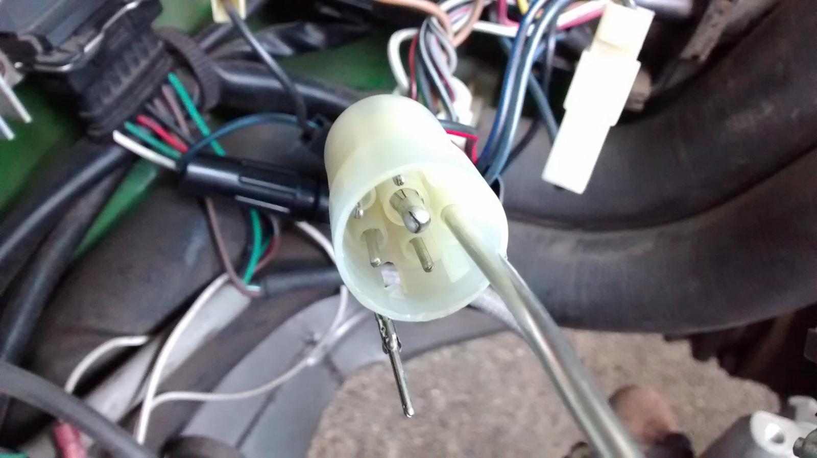

Pull out the connectors and focus on the round 7-pin connector for the taillights. To open the connector carefully squeeze and tug or pry the edge over the locking tab. If you break it, they are available but that makes for even more work. I am lazy, so not for me.
7-pin connector pin removal.
On the MALE side (goes to the taillights) the pins need to be slipped out of their sockets. Lisle makes a nifty tool for this, but it does not protrude deep enough, therefore an alternate route is needed. I procured 1/8” aluminum tubing to do it. K&S Precision Metals #5073 is available at most hobby and Ace hardware stores (if you can get a couple sticks of the 1/8” aluminum tubing it gives you grace for when they bend or break). Poke the tubing into the connector so that it goes over the male pin, then EASILY and with a twisting action (easy now…aluminum tubing WANTS to bend and break) press it deep into the socket until the wire and 1.6mm pin are released. The 1/8” tubing unlocks the spurs holding the pin in the socket. Either mark the socket as to what wire went into that hole or leave the tubing in place to denote ‘home’.
Splicing the wires.
With care, take the wire that has the Molex pin and remove about ¼” of the case to reveal the copper wiring. Be careful to not cut or over stress the wires. With the bare spot in the wire, take a mechanics pick to gently find and create an opening in the wire braids. An eyelet of sorts. Now take the proper lead from the trailer wire harness and WEAVE it into the eyelet. You will then create a loop and wrap with the wires. Like a braid or hair extension : )
Once the wires are meshed nice, slip a section of heat shrink tubing over the Molex pin and cover the spice area. Apply heat with care. The splice is now complete.
7-pin connector insert.
The newly spliced wire can go back into the 7-pin connector. But first take care to be certain the locking spurs on the 1.6mm pin are open. Press back into the connector until you hear the click of ‘home’.
Do this for all wires as per the harness. Then tuck everything back into the junction box where the connections are dry and unseen. That’s about all folks.
TO SEE EVERY STEP OF THIS, GO TO MY PHOTOS
