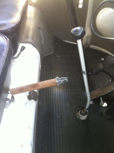

Use a bungee cord as long as possible. Then cut a 2x4 the exact length with a “V” slot cut in each end. Wedge between the heater duct and shifter.

I used a bungee cord to hold mine in 4th gear for quite a while.... 1x cross country trip from FL to CA and back.... and several trips from FL to NC and back.... some transmissions let you use a bungee... others will not stay in gear no matter what. The transmission never gave out all the way.... I just finally replaced it because I was tired of dealing with the bungee after 5-6 years.

My '67 Westy original transmission popped out of 4th accelerating. Put a bungee on it. It was like that for a long time. Just became natural to hook the bungee after shifting into 4th.
What has most likely happened is the pressed on hub that the 3-4 slider cogs with has come loose. People weld the 3-4 hubs to prevent this. I'd say try the bungee and see how hard you can treat it around town.
Physically what the bungee does is uses the dogleg shift lever to hold the steel shift forks onto the groove that they ride in to select the gear.
Last thing I can say is a VW transaxle can go all day long in any gear without adverse effects as all the shafts are bearing held. Unlike a Laygear or Clustergear tranny that needs to go "straight through" for final drive.
I feel your anxiety and reticense but you will still have 3rd gear.
