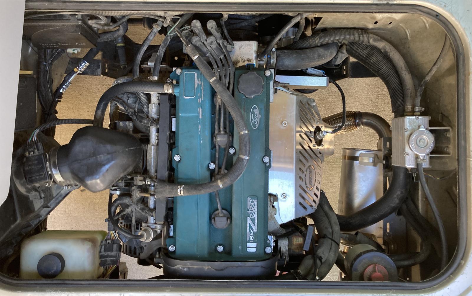

Mine seems to burp at higher rpm’s and then all out puke when the revs drop.
Maybe it’s the smaller aluminum tank on the Bostig (on the right below) that’s vexing me. Anyway, the no spill funnel has helped immensely by containing the burps.
