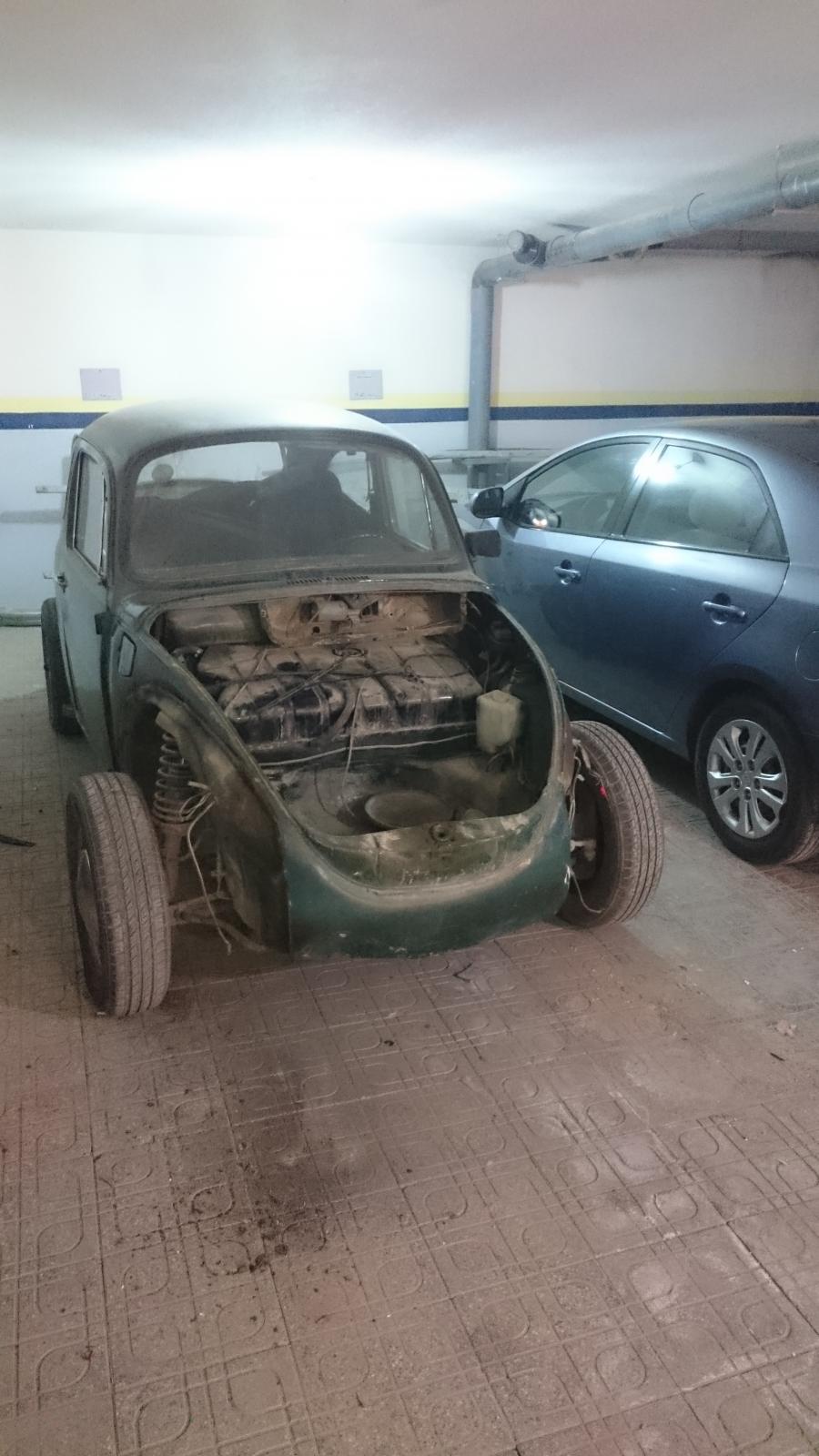

I started off by removing the motor, then all the fenders and running boards, bumpers, hood and motor lid. A few broken, extracted, and grinded bolts later:

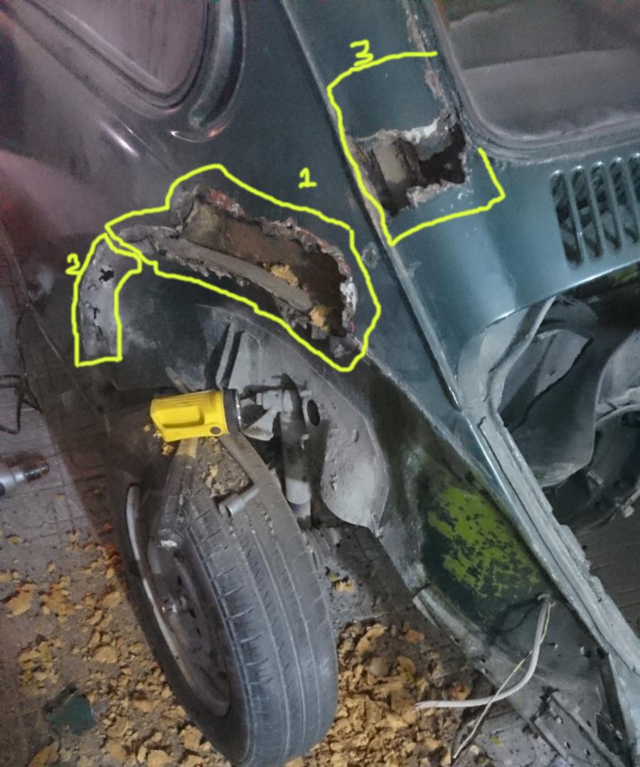

I moved on to clean the rusted out quarter panel behind the moon vent, turned out a lot worse than I initially thought, and It took me a lot of time and effort to get rid of the stubborn foam. I am not even sure I will be able to find or fab a patch... this spot is the main threat to this project.. I can weld well with a mig welder but I have never done bodywork and metal fab.
initial look (poked through with screwdriver):
all the bad metal fell off and left 2 big holes and tons o foam inside which i removed:
the bright green color you see on the tail is the OG paint!:
all the foam taken out:
Next Im planning on sanding the rust inside the hole and treating it with ospho then spray it with DTM primer as far as i can reach, hope it prevents the rust from ever coming back.
there are other rusty spots that need patching, I appreciate any tips, comments or advice, thanks guys.

Zaid, at first I thought the original green color was Lime Green metallic which was prevalent in the USA, but Lofoten green seems to be a closer match per Alex's comment. Here's a '75 German Beetle brochure showing both colors. Lime Green metallic is listed as Viperngruen (Engl.- viper green) which was the actual name of the same color that Porsche used at the time.
Rust: if there is another Standard or Super Beetle in your local wrecking yards, consider cutting out a larger section of the roof FORWARD of the rear window. The factory-injected foam only went up/ as far forward in the roof channel as the top/front edge of the rear window. From what I've seen on rusty roof pillars, the foam usually did not even go up that far. If you cut a 2-foot section out from beyond that area, and also cut into the roof farther than the outer edge of the rear window, I'm sure you'd end up with unrusted metal that you could cut and patch in to your rusty area. You'd just need to cut it back to match the edge of the rear window side flange.

Alex, you are right, I think the color could be confused with lime green because I take pictures using flash, but from looking at the car in daytime I can say that it seems to be lofoten green, I think the interior used to be the "yellowstone" mesh from Rome's chart.
If i go with the original color I think ill go with light beige interior.
Rome, thank you for sharing the chart and advice on rust, should I cut further up the roof than the foam was to get to better metal? I was going to use a converter because there is considerable rust on the inner panels but no rust holes and its a big job replacing those too and would be nice if I can avoid it.
can I get away with cutting the rust out like the picture below or do I need to replace all the metal in the area?

Yes, my thought was to start your cut farther forward/frontwards than the top edge of the rear window. Start at the rain channel and come in maybe 8", then cut straight forward parallel to the rain channel for maybe 20". That should get you into solid metal because the foam did not come up that far. When you set the patch piece back to your rusty area next to the rear window, cut it back to the edge of the rear window channel. Make straight cuts along the original body to get the rusty areas out, so that you can easily trace the cut outline onto your patch and weld it in using butt welds.
If you find another Beetle in a junkyard and want to cut out the entire rear window metal based on the above suggestion because of all the rust on yours, realize that VW made the rear window size larger for the 1972 models- the width is the same, but the front edge of the window comes up about 2" higher along the roof. The increased rear window size applied to both Standard as well as Super Beetles.

So ill try to find a donor car and bare in mind that the rear window size is different if its a 72.
Excuse my noobishness but is this closer to what your suggesting? Sorry lines drawn by finger on smart phone hehe.
Until I figure this out ill tackle the other side vent from the inside as dwayne kindly suggested, remove all foam and assess the damage.

No, go up higher on the roof, such as above the side window. And cut in twice as far inward into the roof so that the patch section is wider than the distance you need (from the left side of the rear window to the rain channel). But the length would be sufficient. The curvature might be slightly flatter from the removed patch area, but you can bend to fit as you weld the patch into the original location.
