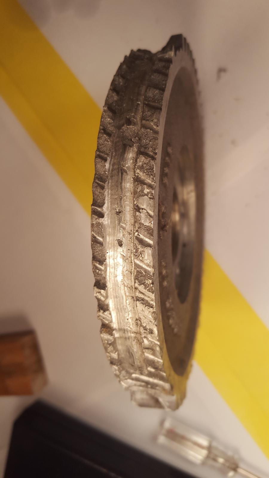

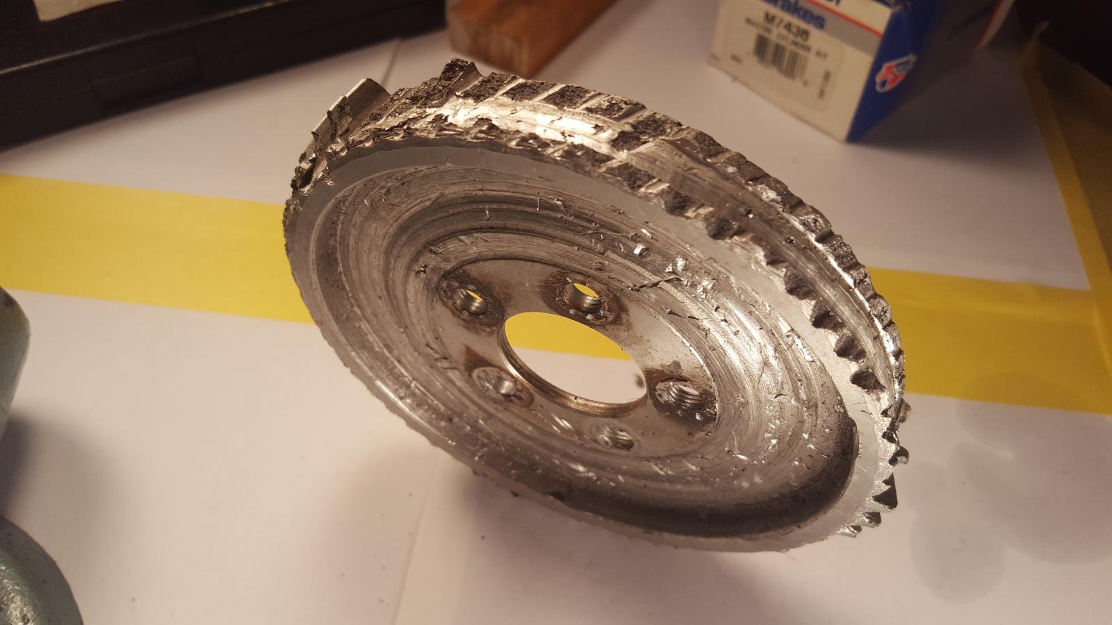

This one took a whole day and in the process of trouble shooting the issue….wiped out a pair of thrust bearings (mainly because of excessive handling and tweaking).

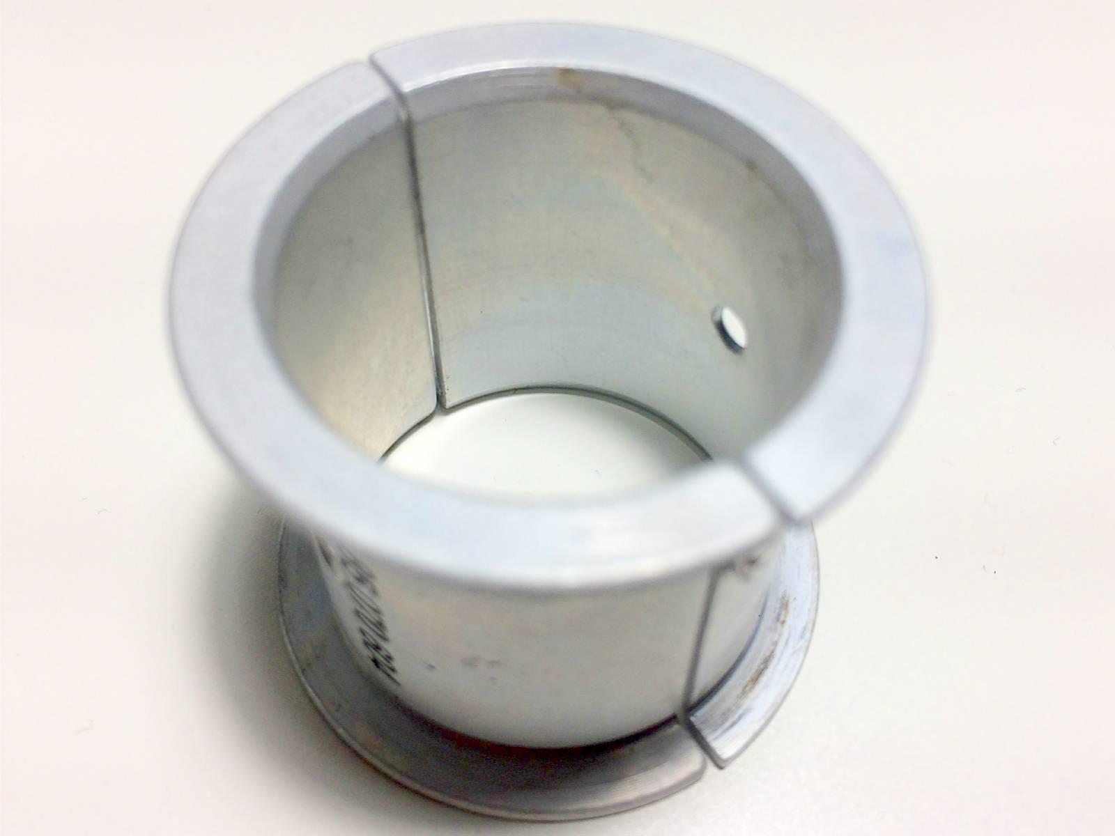

Engine Case: EA series type 4 1.8L from a 412.
Camshaft: Web #73

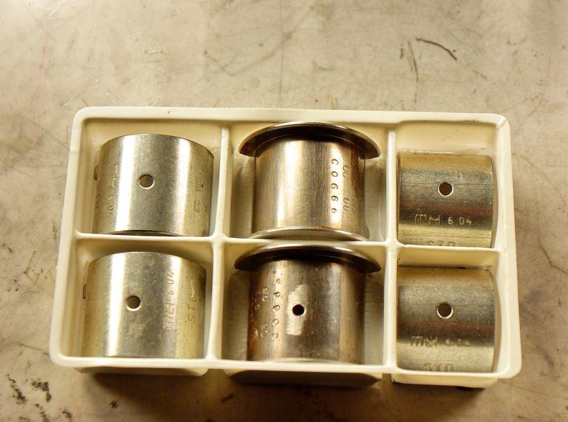

Bearings: Two sets of Mahle 021 198 541 BR. The bearing manufacture date is May 24, 2010
NOTE: I also had four sets on my parts shelf of the same part # made September 9, 2000. These came in handy.

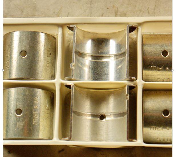

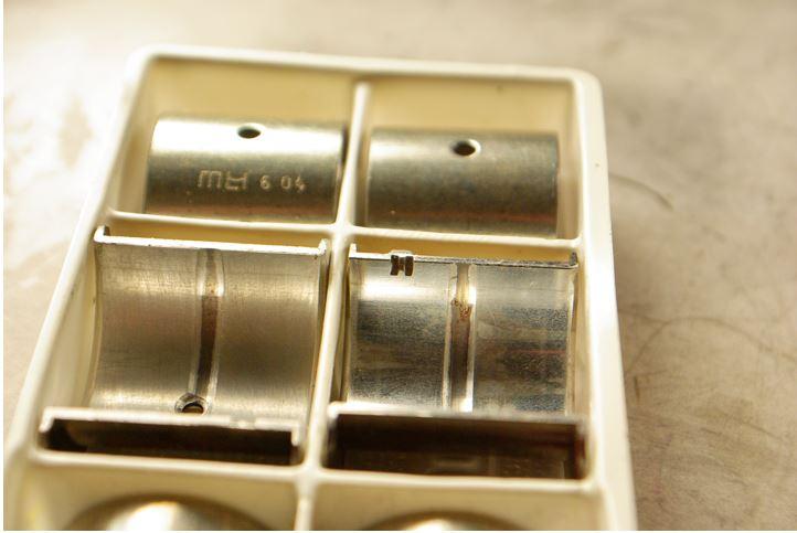

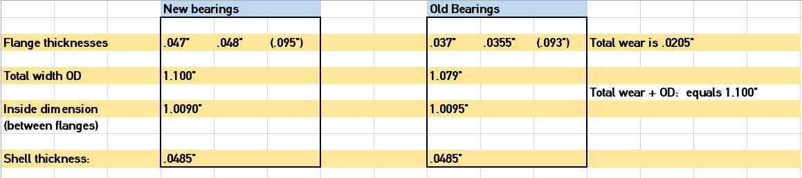

The bearings: we have heard a lot of opinions regarding main and rod bearing quality these days and even some complaints about cam bearing quality and about issues with Mahle and other manufacturers. Of course most of that is recent build parts.
The bearing sets provided to me for this build are 7+ years old. I compared them and measured them to some of my 2000 build bearings and they look and measure identically and appear to be excellent quality.
NOTE: I will have a small dissection/post mortem of the bearings at the end of this with some measurements and pictures. There are very small some difference in the bearing dimensions from year to year. But…with the right prep…these differences are not a problem.

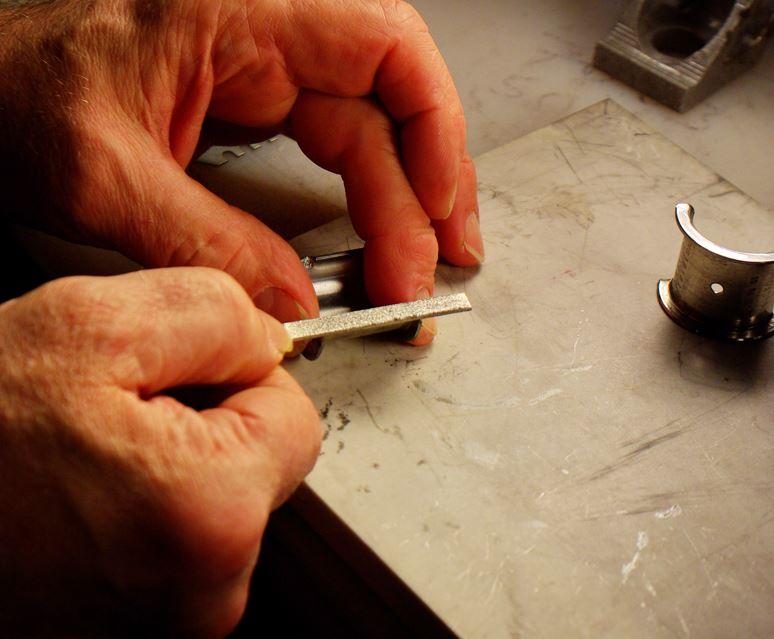

The camshaft lobes and the edges of the thrust flanges were fully deburred and the thrust faces on the cam were lapped carefully with 2000 grit and then the whole cam was carefully re-cleaned chemically. (See my 1.8L build thread in the 411/412 forum for the deburring process)

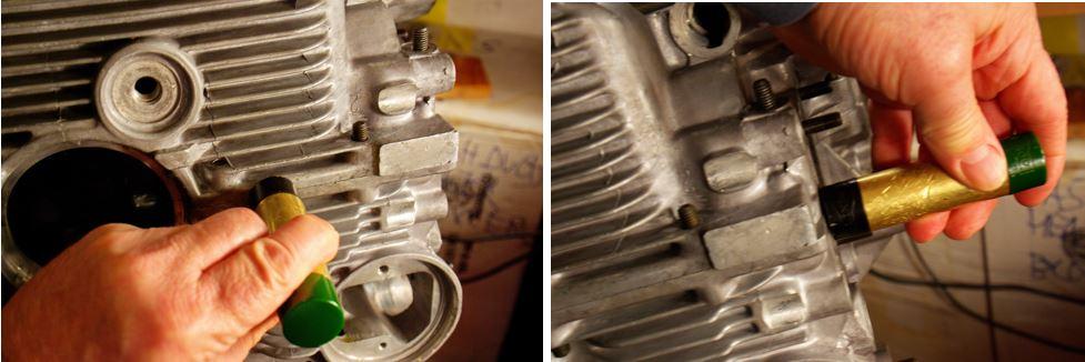

With my finger on the center of the camshaft the shaft was tapped forward about five taps and then rearward. The cam now spins in these bearing halves like glass.

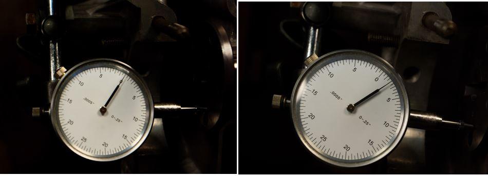

The dial indicator was set up and zero’d.
The end play on this bearing shell set was measured to be .002”. Excellent.

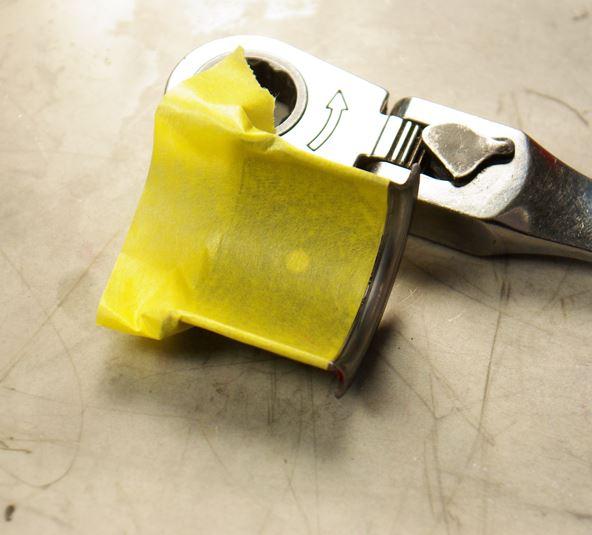

The new thrust shell is marked with a scribe for the tang location so I can line up the punch easier.
The thrust bearing from the second bearing set was installed, a clamp washer installed so the bearing does not rotate in the case when the tang/notch is being punched. A narrow blunt punch was used to “dish in the tang.
This was after the first strike. It took two strikes. Better too soft and needing 2-3 strikes than too hard and warp the bearing.
The new locating notch/tang.
Work gently here.
It will almost always create a slight burr on the journal side. This is not a problem. You can use a diamond needle file (best) or standard needle file to “square up” or sharpen up the back side.

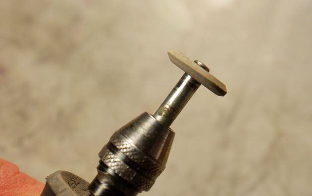

I use a Dremel 360 grit rubber Emory wheel that has been dressed to a point to clean up the front notch and make sure any burrs are below journal level.
NOTE: in regard to the worry about using abrasives near these bearings…it’s not a worry if you know how to clean them PROPERLY. I will get to that later. If you are worried about abrasive dust use a Dremel diamond disc wheel that has been lightly broken in on a soft ferrous metal part. It sheds no abrasives. More on this at the end.
NOTE: If you do not trust yourself with a punch….another good way to make this dent is with an old pair of diagonal cutters with the cutting edge blunted. I made the first one this way and the second one with a punch.
The nice thing about this method is that you can control the pressure and depth very well.

The dial indicator was set up and the end play on this bearing shell set was just under .002”…probably .0018”… Excellent.

Repeat the forward and back tap…lightly. The cam loosened up to normal again and rolled smoothly.

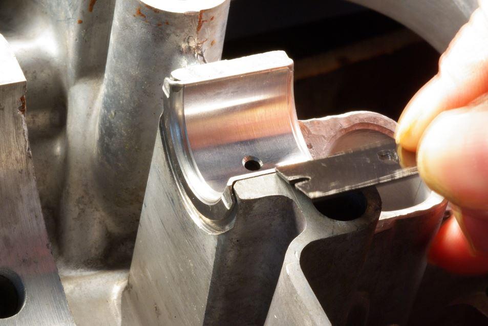

Remove bolts, remove left hand case half, remove camshaft. Install both thrust bearing halves and reassemble case without the camshaft.

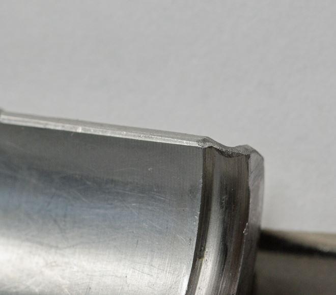

CAREFUL Inspection through the oil pump hole shows two important things:
1. The deburring/clearance work required to make clearance between the bottom ends of the thrust bearings is not correct. The bearings will and should make “crush” contact along the top and bottom edge along the length of the journal bore on the bearing looking fore and aft….but the flange tips….which have a very slight buckle to them where they turn from the straight barrel of the bearing into the flange….should NOT touch…..in the curved chamfer area between the flange face and the barrel of the bearing.
Notice the wider Vee gap at the top….and where the arrow tips are pointing.
This is the first set I have had that needed clearancing in this area that I can remember.

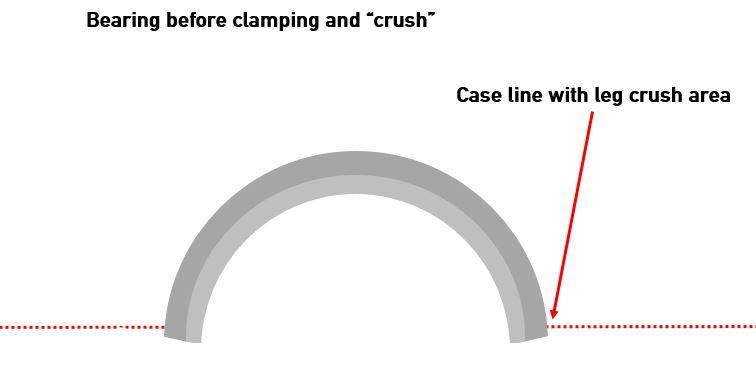

Why is this an issue?

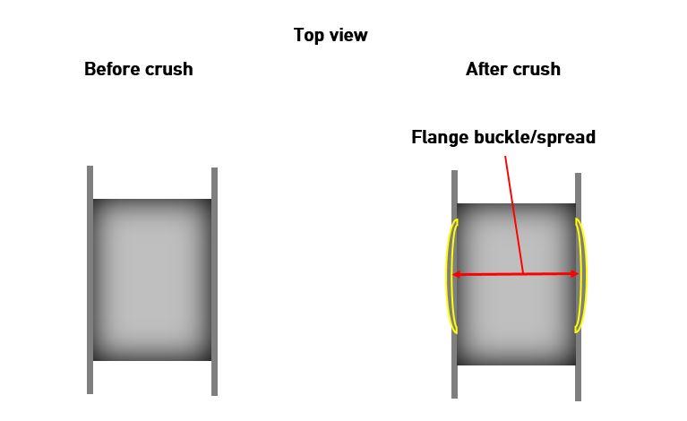

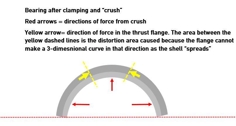

This is the thrust flange bearing shell from the side before clamping the case and loading the bearing
This is the direction of forces as the bearing is crushed in the case. With a non-flange bearing…these forces just warp the bearing shell harder and more completely into the case bore. BUT…..the flanges being vertical in relation to the thrust compared to the barrel of the bearing shell…CANNOT flex very far in that axis. If something is making contact that causes excessive pressure….the flanges WARP…..OUTWARD toward the thrust faces.
As the bearing shell deforms….the flanges spread OUTWARD toward the thrust surfaces.
This is pure force geometry. This is part of what the “fore and aft” tap corrects. BUT…if the ends of the flanges touch and crush against each other…the flange BUCKLES in TWO directions.
To be more precise…in this top view…you can see that the flanges really only warp outward in the center close to the apex of the arc.
You can see the long term result of this effect looking at the wear pattern on this thrust bearing which has about 90k miles on it. The solver flecks on the thrust face are aluminum…and are from the fact that this engine died violently. This bearing is about 25 years old.

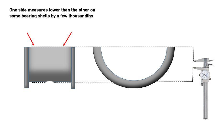

This clearance at the flange ends is a little inadequate…..I am assuming….because these bearing sets were not set up for two flanged bearings to be used together.
Really you only need to reduce the height between the two arrows to keep the two thrust faces from contacting during bearing crush…on that little elbow bend. A little more angle back helps as well.

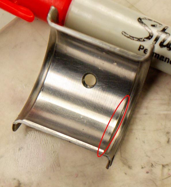

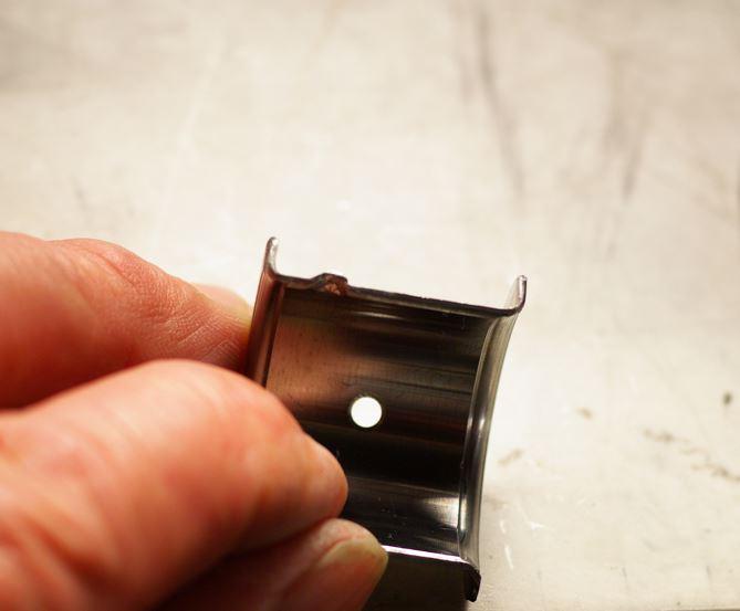

2. THIS WAS ALSO A BIG TELLTALE that something was wrong: note in this very poor picture how the right side bearing appears to be lifting.
And…the location of this lifted corner….lines up perfectly with the burnished/deformed mark on this thrust bearing shell.
I at first thought I may have deformed the bearing shell during the making of the locating tang.
So….….I pulled out a brand new bearing set…and proceed to fit a new identical bearing (measured within .0001” in flange width and with about .00025” in depth)…and when fitting it to the right hand case half to see if it fit the same as the deformed one………..I SAW THE DAMN LIGHT!

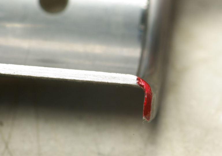

Really…I had to get my brighter lights on it to see it clearly….but I saw something that I had never had a PROBLEM with on any of the other cases I installed double thrust bearings in.

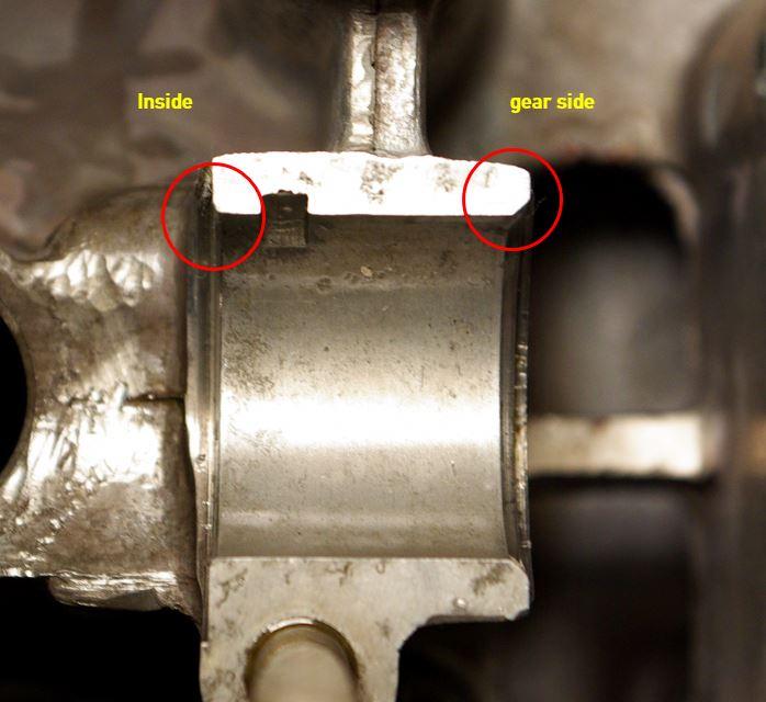

The inside case chamfer on the thrust bearing bore….was VERY SMALL. You can see in these pictures what it does. It does not allow enough room for the radius of the inside of the flange. So when the case is tightened…it deforms the bearing …permanently…and burnishes the surface.
Close in inspection of the left side of the case…..where the thrust flange bearing normally resides shows that its chamfer was slightly better…but also barely adequate. There was a very small burnish mark starting on that bearing too.
I suspect…..that the original German bearings had sharper and more distinct stamping than the Brazilian made Mahle bearings….so this barely adequate chamfer was not an issue during the factory build.
Inspecting two of my other cases found better chamfer on these. The chamfer on my other two cases were easily 0.5mm to 0.7mm wider…..not much….but enough that it was visibly a better chamfer to the naked eye.
The difference in the thrust flange chamfer is very apparent in this picture
So…two spare sets of bearings will come off the parts shelf to steal the thrust bearings from. I got them very cheap on sale years ago…maybe $10 a set…so it no biggie. As I say…collect parts when you can!

1. I removed the other bearings and…. I increased both case half chamfers by about 50%. With a steady hand, a Dremel and a fine sanding drum, then deburred with a sharp bade at 45 ° and yes they had to go back downstairs to the sink for washing and drying.
2. The two new thrust bearings both had the lower corners of the flanges deburred so they do not touch when the case crushes. These pictures are the old ones I used for practice….but you can see the difference.

Torque case to 24 ft. lbs. Peen around case, tap forward and back. Cam rolls smooth as glass. Endplay is checked and It is unchanged….right at .0022”

Meanwhile…you CAN buy double thrust cam bearing sets….but whoever is selling them to you …put those sets together from two sets.
You can buy double thrust type 1 cam bearings from Aircooled.net. I “think” at one time they also sold type 4 double thrust sets.
You can also buy them at the type 4 store for type 4 engines. I have a set of them I got from the type4 store that came in my deluxe cam kit. They will be going into my engine later this year.
Just to compare I pulled them out of the box to look at them.
You know…back in the day…a lot of people gave Jake Raby a ton of shit for his parts prices. But I must say….this double thrust cam bearing set was a freaking bargain at $49.95.
The clearance deburring to the ends was done, the punch mark was done in a special jig (I remember the on-line discussion about this)….and the thrust bearings had an oil groove added in a special machine jig. The measurements were spot on.
Just for reference….on the left the type 4 double thrust set I bought from Jake Raby in my cam kit. $49.95 was a steal! The provided bearings for this build circa 2009 and the back up sets from 2000-ish on my shelf.
Some pictures of what’s in Jake Raby’s double thrust sets. Nice work!
I have no idea how much John puts into his double thrust sets...or if the type 4 store still puts this much into their current stock sets….but if it’s the same it’s a bargain.
At a current price tag for a single thrust set from AC.net…$29.95…and two sets being required…..bringing it to $59.95 a set for parts…..any added deburring etc….would be worth another $30-40 of labor. Bringing the price upwards to about $99…its right in the same neighborhood with the type 4 store current price of $112.
You get what you pay for. My double thrust work is pretty damn good…but for the time versus money perspective (not an issue with me) but for many people…. the risk of having to destroy possibly a bearing set from something like a punch slip during fitting the second shell while doing this yourself….it would be a bargain to buy the set from the type 4 store or AC.net.

Bearing measurements:
As I noted...I think these are about as good of a bearing quality as I was getting 25-30 years ago in the same brand....and teh measurements were very close. There was just a little bit of difference in the sharpness of radius and fold in the cam bearing flange but these are pretty damn close.

The radius issue will not cause the same level of a problem on a single thrust bearing install.....because you do nlt have the added distortion of two bearing shells making contact on the thrust flanges....
But it does cause part of the "sticky" cam problem. As I noted.....very fine misalignments of the non-thrust bearings with relationship to the bores they lay in.....as the tension increases during bearing crush as the cases come together.....are responsible for "some" of that sticky cam syndrome that requires giving the cam a fore and aft tap or two.
But.....the outward flex/distortion of the thrust bearing flange....even on a single thrust install......causes most of the cam drag....and most of what requires the mallet tap.
Some flex/distortion of the flange is normal....and is caused by the geometry of the bearing. But...if the inner chamfer is a little too small.....it makes this much worse. Ray

This is why I noted.....I will not 2nd guess the engineers.....and why I compared it to and measured.....a known 30 year old bearing that worked for 90k miles.....and still looked excellent (engine died for non cam related reasons).
Overall.....the crush length ....and all other measurements. of the new bearing.......were the same as the old proven bearing.
The only differences I could find.....were that the bend radius on the flanges of the thrust bearing.....in the new bearing sets......were a tiny bit "less sharp" radius.
This makes that tiny 90° corner.....where it goes from the straight shaft portion of the bearing rurns into the flange......protrude a little.
So to to sum up.....your bearing crush length should be just fine. Its just on the little angled corner that I noted in the photograph.....that could stand to be polished down by just a few thousandths so it does not touch the other shell. Leave everything else alone. Ray

Yes...pluses and minus's with every product and brand.
The barrel edge chamfer is one detail I did not get into in this thread...that I did address. Thank you for reminding me!
I found a couple of odd things. Not huge...but it is part of the issue with needing to "de-stress" the bearings with the mallet "whack".
Its not so much an edge contact point chamfer I believe the bearings need but I think it helps.....but they need to be set STRAIGHT on these edges.
Let me explain....think of this....
About half of the bearing shells when carefully measured across the arch from back to front...checking side to side along the length of the bearing...I find them to be off by a few thousandths.
This commonly happens....when the edge is taken down with a FILE after it comes out of the stamping mold. Wink
As you know if you have done a lot of work with a file....typically the lead edge of the workpiece closest to you gets cut down at a faster rate as angle and pressure change during the file stroke.
Think of what happens...when one or both of the arches of these bearings...has one side a few thousandths longer than the other....as the case halves close on them. One bearing will contact the other early....at a single POINT...instead of along the whole edge.
This causes the bearing shell to be PUSHED...and it will try to rotate in the bore. Then the rest of the edges make contact....and to square itself up under that kind of crush pressure....the bearing shell TWISTS minutely..and now has a new shape of stress riser in it.
I did a little work on these to not only put a very fine chamfer on the edge but also to make them as even as possible from side to side on the edge contact faces.
A little more on the corner stress riser from the flange.
Overall...all of your clearance work should be done only in the red marked areas.
To be really precise...this little spot is where the stress riser is. The Mahle bearings have had the corner knocked off by a file so most of teh stress riser is gone...but this little elbow corner should not touch the opposite elbow corner at all...because even though they knocked it back with a grinder or file....because its a "bend"...its double stressed.
So you can see in this angle....I really just recessed that elbow point slightly below flush with the edge so it cannot make contact with the other bearing.
I did that "recess" with the rubber 360 grit grinding wheel that I knife tapered on the edge against a dressing stone.
I mask off the bearing areas with Frog tape when I do any grinding. Although I am not greatly afraid of abrasive....because I know how to clean it up....I'm not a savage! Laughing
The only crush surface contact points I want...is along the linear edge just like the other two bearing sets.....on the edge with the yellow dotted line. Its the most uniform. I do not clearancing on this edge...only the chamfer I mentioned above...and try to get it straight while removing as little as possible.
Think of this and try this....find a piece of card stock or plastic.....the same thickness as these bearing shells or close...just under .050". Now...lay a ruler across it and put a nice sharp crease in it.
Pick it up and look at the edge of the sheet. See how you have a little "bump" where the cardboard or plastic bunched up? They knock that bump back with a file or grinder on these bearings.
Now....Take that sheet with the part you bent standing up like a fin...and warp it into a curve....and watch how the sheet buckles along the fin. That whole crease point will be under stress from end to end. Pushing on it from its corner bump causes stress in several directions at once.
After measuring the shells I took them down slightly and made them even and chamfered all at the same time.
I marked the edge with Sharpie.
Then used a diamond needle file. I actually found much better control by standing them up on their edge so that the edges were at 6 and 12 o'clock and worked the needle file while standing on its edge...but I forgot to photograph that.

I have posted these pictures numerous times....but....for your benefit
THIS WAS CAUSED BY THE FAILURE OF A SINGLE THRUST CAM BEARING....THAT EVENTUALLY ALLOWED BOTH THE INNER AND OUTER THRUST FLANGES TO THEN BE WORN AWAY OR CRACK OFF....WHICH THEN ALLOWED CAM BOLT CONTACT WITH THE OIL PUMP BOSS.
So yeah....its a not problem.....overkill....in your well researched and all knowing words..... Rolling Eyes Rolling Eyes Rolling Eyes Rolling Eyes Rolling Eyes Rolling Eyes Rolling Eyes
Sounds like bullshit to me....sorry...i call em like I see em.
If I had had a double sided thrust bearing...it could have driven on long enough for me to find the thrust flange bits in my next oil change...tear it down...and prevent the TOTAL LOSS...yes...TOTAL...crank, steel crank gear, cam and gear, four pistons, 8 valves....and the rods too.
That could have been prevented by a double thrust cam bearing...which would have cost me the equivalent of maybe 15 cups of industrial coffee from 7-11....or two really good six packs. Thats a fair trade I think.
