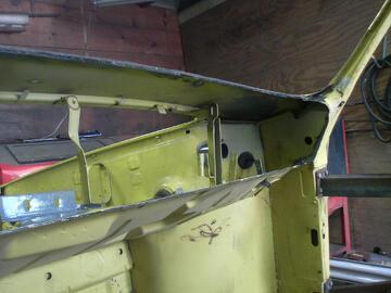

Can you post pictures of your dash from the front and from the trunk side?
It would be easier for people to give you correct advice. Replacing the dash is doable. My car is a 71. The previous owner removed the original dash and installed a 62 dash.
Here's what you have when the dash is removed.
Maybe your 74 still has it's original dash but with modifications? If so, you might be able to return it to original as far as the opening for the glove box. Then close up any holes used for pad installation and paint it to give it the older look.
