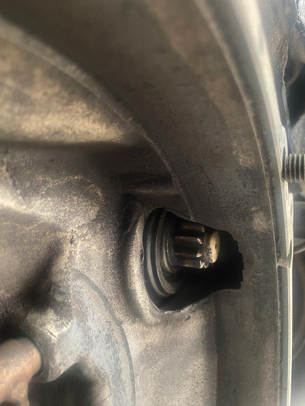

PostPosted: Mon Jan 16, 2023 2:37 pm    Post subject: Re: my fly wheel Reply with quote
Here is my starter gear.....am I correct..no bushing needed.
Matthew E D'Azzo
volksbugusa
https://www.facebook.com/groups/506947294919060
toxicavenger70
Joined: July 28, 2019
Posts: 882
Location: CO
toxicavenger70 is offline
PostPosted: Mon Jan 16, 2023 2:38 pm    Post subject: Re: my fly wheel Reply with quote
volksbugusa wrote:
toxicavenger70 thanks for getting back to me.....will replace the flywheel yes...looking at my starter there is only the gear and no nose shaft....so i don't need to replace the bushing..am i correct? Thanks Matt
Looks like you have a self supporting starter. So you should be good to go.

PostPosted: Tue Jan 17, 2023 3:29 pm    Post subject: Re: my fly wheel Reply with quote
it looks like the starter teeth are too shallow. Is that the original style starter, or did someone swap it for one that doesn't require the bushing.
volksbugusa
Joined: May 19, 2003
Posts: 382
Location: BUNNELL , FLORIDA. 32110.
volksbugusa is offline
PostPosted: Tue Jan 17, 2023 3:50 pm    Post subject: Re: my fly wheel Reply with quote
SGKENT..Yes sir correct
