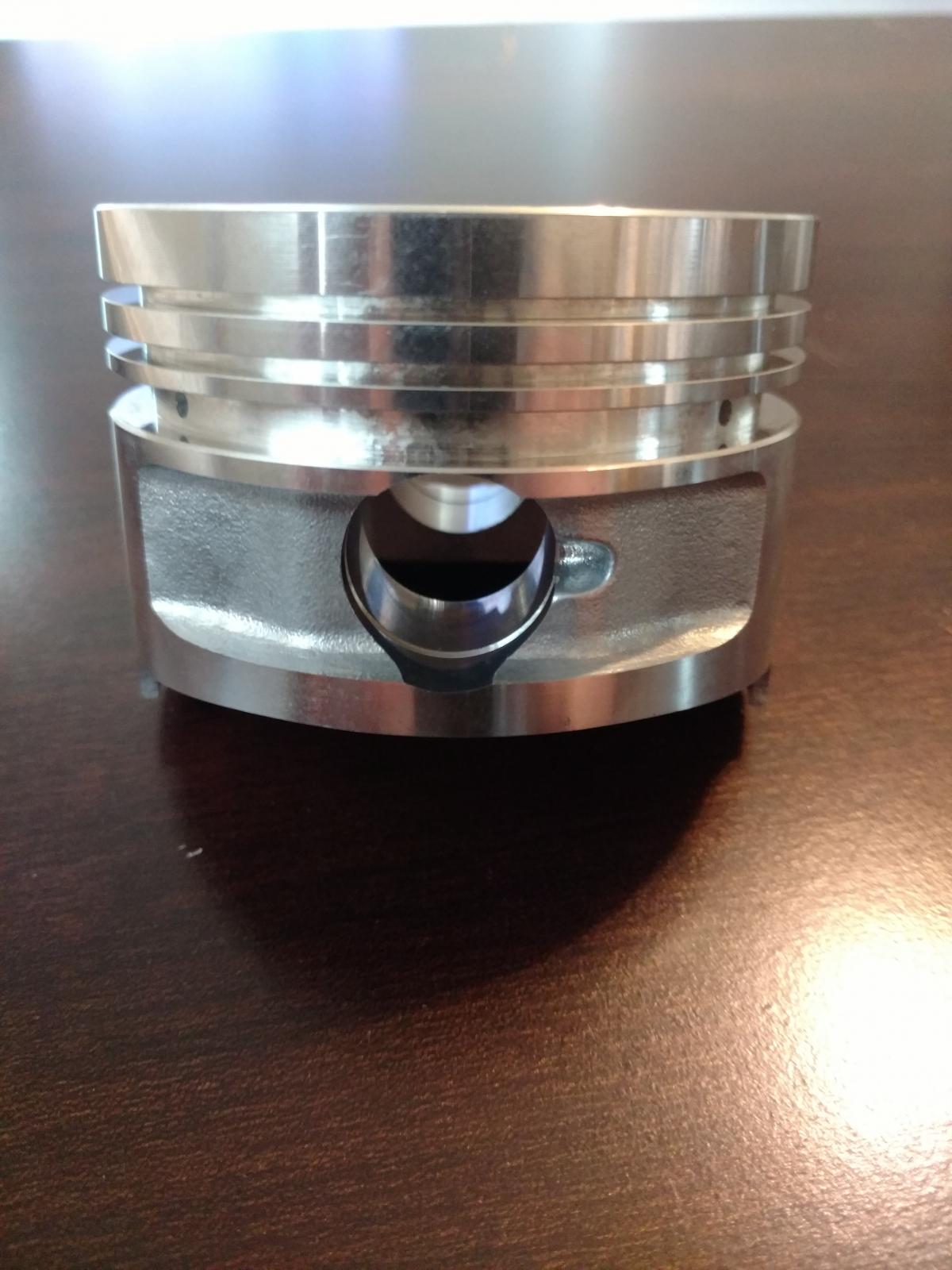

OP, any pics of the piston skirts?

PostPosted: Sat Mar 10, 2018 10:27 am    Post subject: Re: 85.5 B piston measurements Reply with quote
Yes I was comparing to stock pistons. These are definitely smaller at the crown. It just looked off when I fit one in the cylinder. But not having a steel insert could be another reason (along with more rock) to make the tops a bit smaller.
I'll post some pictures here in a bit.

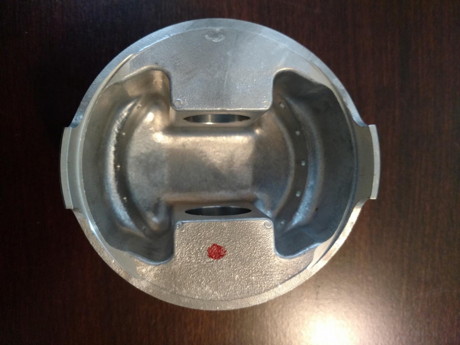

Anyone know if these need to be installed a certain way? Is the red dot indicate up? There is no directional arrow on the piston to indicate.

PostPosted: Sat Mar 10, 2018 3:55 pm    Post subject: Re: 85.5 B piston measurements Reply with quote
I expect the pin is centered so it does not matter.
Check if the pin is centered
