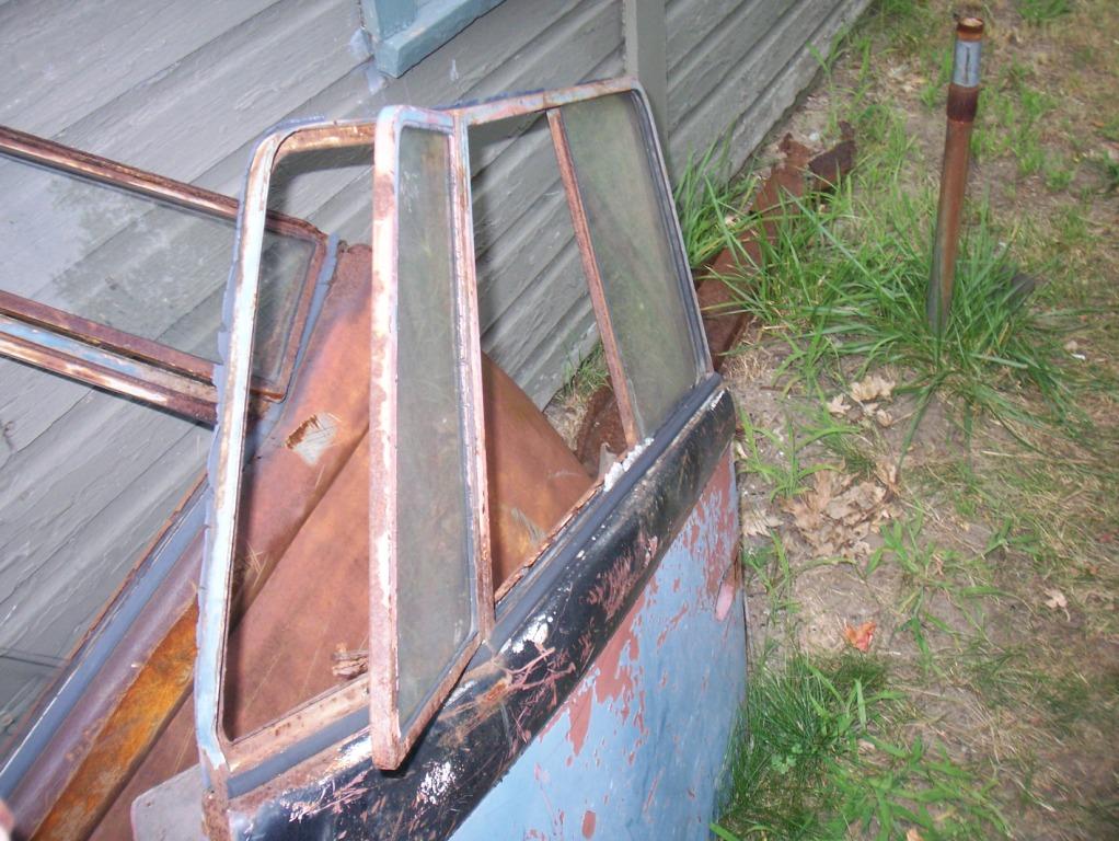

Notice though that there are two different types.
1. Where just the hinge has been swapped but the catch point Remains in the same location as a non-suicide quarterlight. This results in the window opening much wider then usual.
2. The hinge has been swapped but the catch point is also different. Spaced from the hinge as it is for non-suicide quarterlights ensuring they window only opens to the same degree as a normal one would.
Standard quarter on an early microbus with a fully edited deluxe suicide Quarter pictured below.

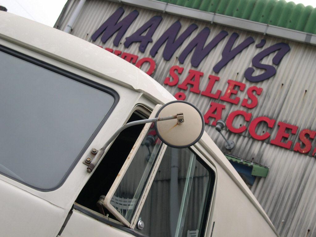

PostPosted: Fri Oct 11, 2019 11:55 am    Post subject: Re: Suicide piano hinge quarterlights. Reply with quote
another point. Does anyone else think there could be a connection between the early style high mounted outside rearview mirror and the (optional) suicide style quarterlights?
I believe that the later ('53up) lower mirror could have gotten in the way of the suicide vent wings both visible and physical.

PostPosted: Fri Oct 11, 2019 1:55 pm    Post subject: Re: Suicide piano hinge quarterlights. Reply with quote
The quarterlight changed to the swivel type before the mirror dropped down. Dec 52s have swivel quarters and upward mirrors.
