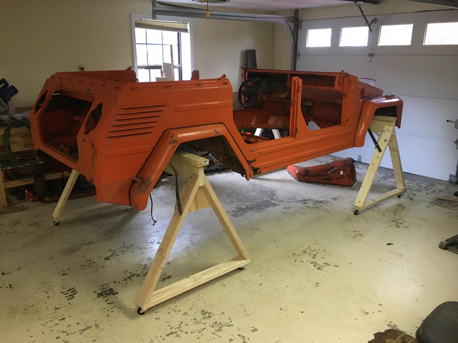

PostPosted: Wed Feb 03, 2021 4:20 pm    Post subject: Kubel 2021 Reply with quote
1973 Model. Spent about 15 yrs in a barn before a few sitting out in the elements.

PostPosted: Wed Feb 03, 2021 4:23 pm    Post subject: Re: Kubel 2021 Reply with quote
It needs everything to be touched with my magic fingers. 😂
Pans are gone.

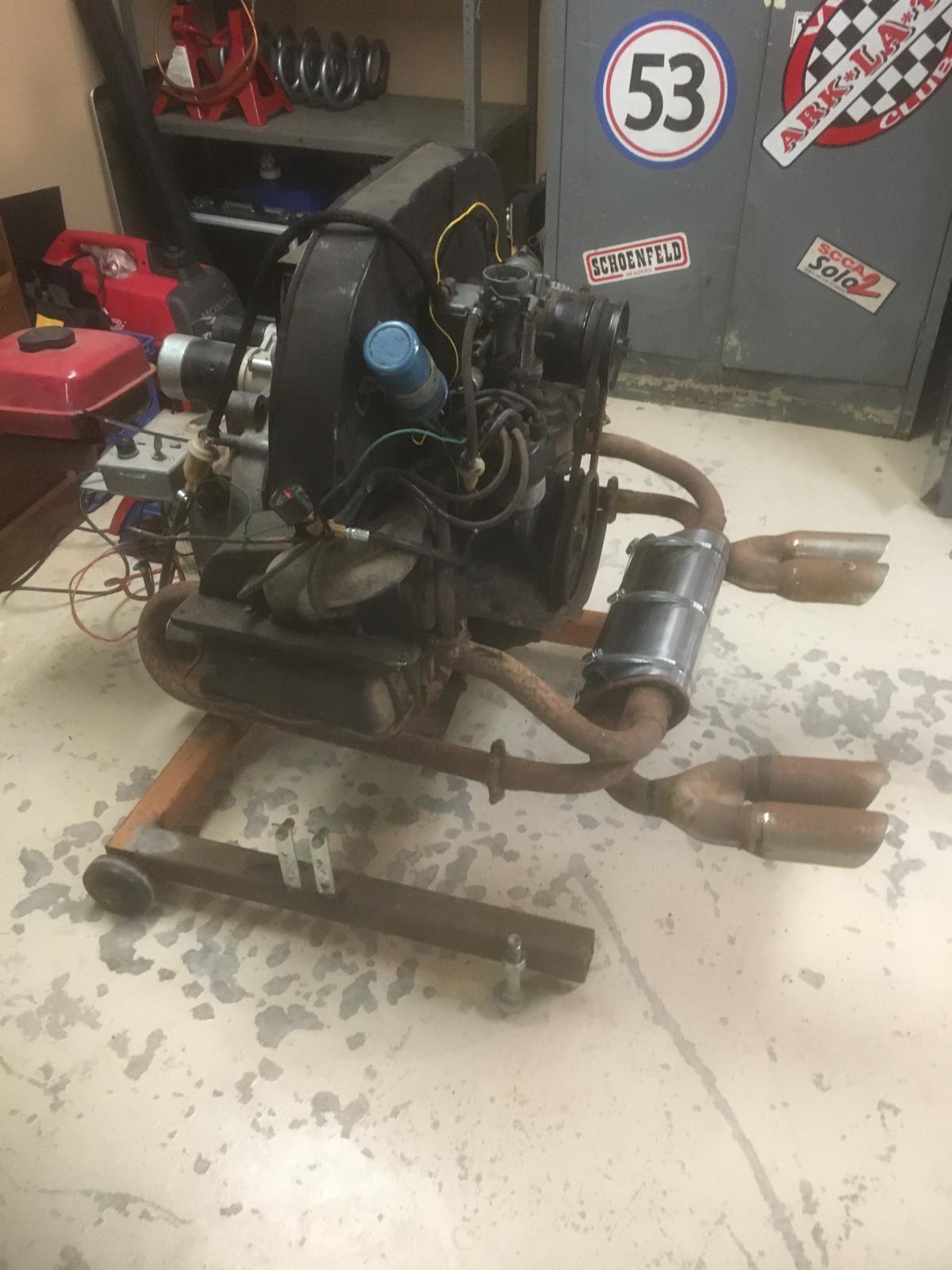

PostPosted: Wed Feb 03, 2021 4:32 pm    Post subject: Re: Kubel 2021 Reply with quote
Engine runs. Checked it over. Fresh lube, plugs points and carb.
Muffler was toast

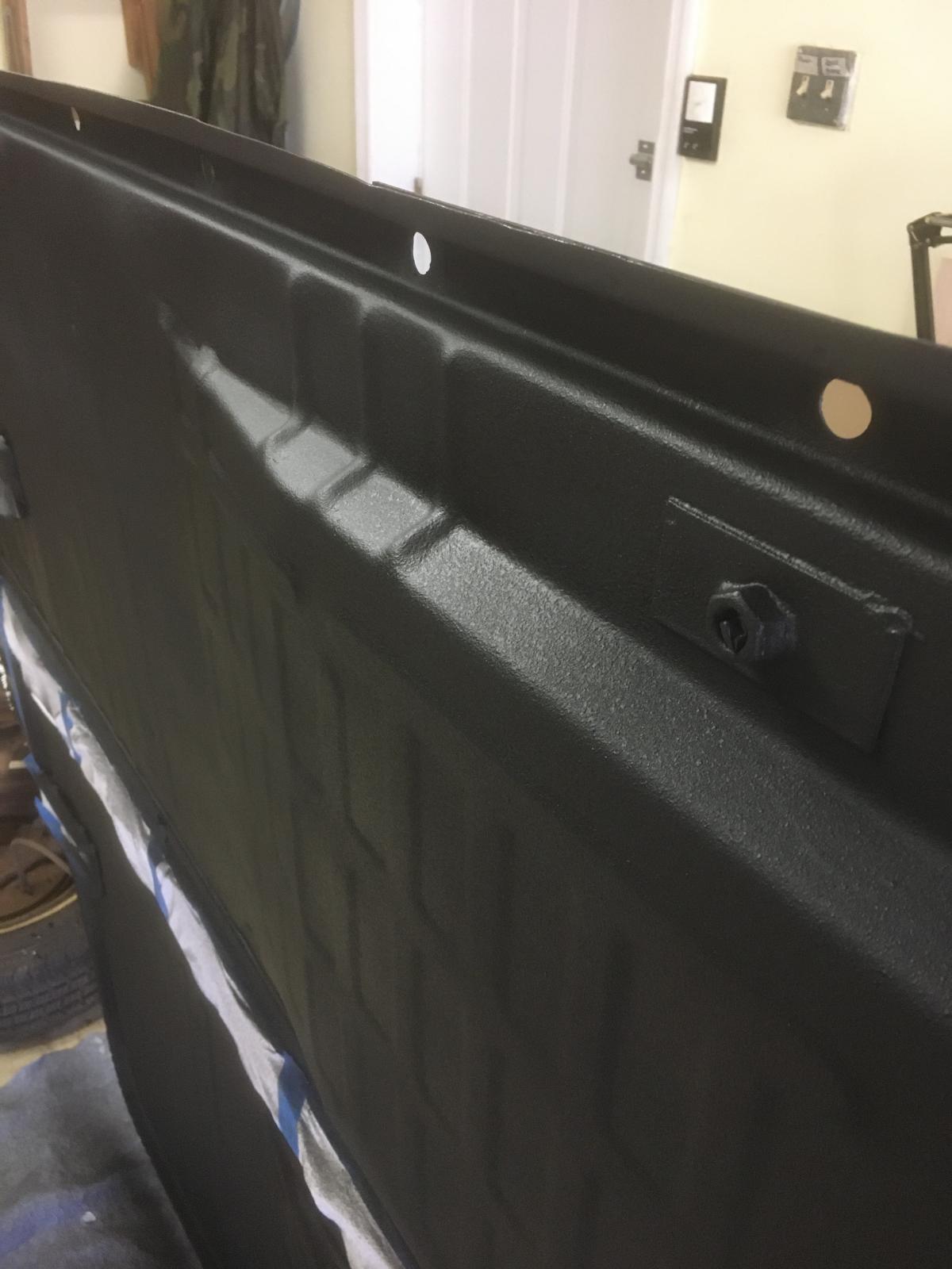

PostPosted: Wed Feb 03, 2021 4:42 pm    Post subject: Re: Kubel 2021 Reply with quote
Refurbished chassis with new pans. rustproofing inside and out with Master Series silver/ chassis black then undercoated underside. Rebuilt front and rear suspension with new everything including disc brake upgrade. 21mm master cylinder.

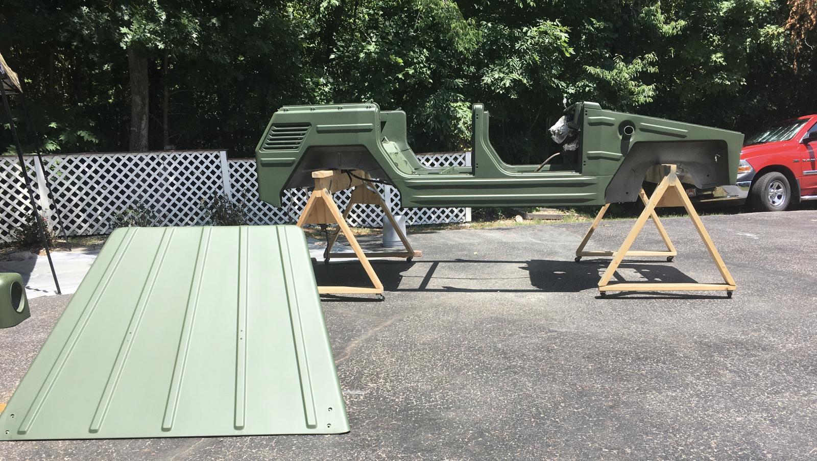

PostPosted: Fri Jun 24, 2022 11:33 am    Post subject: Re: Kubel 2021 Reply with quote
Fresh paint today !😎

fastmc25
Joined: January 01, 2004
Posts: 1224
Location: East Tennessee
fastmc25 is offline
PostPosted: Fri Jun 24, 2022 11:38 am    Post subject: Re: Kubel 2021 Reply with quote
Have come a long way since my older posts

PostPosted: Sun Jul 10, 2022 3:38 am    Post subject: Re: Kubel 2021 Reply with quote
Nice job. How did you go about applying Master Series to the pans? I have done my whole chassis and more or less every other part of the with mixed results. It seems like the flatter the surface, the worse it looks, for example the rear acces cover plate came out like shit so matter what I did. Parts like the control arms/spindles came out great. I also had this weird problem where for some reason the black (I used AG111, not the chassis black) went on with a dull finish instead of the nice gloss. Did you thin the paint, spray, etc…? I sandblasted (pans I will scuff with sandpaper, I’m done with blasting) and applied paint with foam brushes. Two coats silver, and then 2 coats of black. I’m hesitant to do the pans because I’m worried they’re going to look awful.
- 1977 CEI Sunroof Bus 2.0L F.I. Hydraulic Lifters
- 1973 Thing
"It’s so easy to laugh, it’s so easy to hate, it takes strength to be gentle and kind."
fastmc25
Posts: 1224
fastmc25 is offline
PostPosted: Sun Jul 10, 2022 4:27 am    Post subject: Re: Kubel 2021 Reply with quote
I used a 3” fine bristle brush on the pan. Put it on a little heavy and it flows out better. You’re never gonna get rid of the brush marks totally unless you spray. Foam brushes just disintegrate so I never use them
If you decide to spray get a cheap gun that you’re not worried about so you don’t mess up a good one. As master series if it sets up in the gun very long it is gonna be a pain in the butt to get completely clean
. I usually undercoat the underside of the pan so it comes out really nice. On the suspension parts I use VHT epoxy for chassis and suspension. Comes out a nice semi gloss black and it’s very hard.
Hope this helps.
