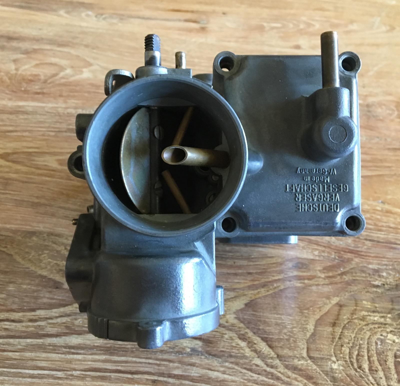

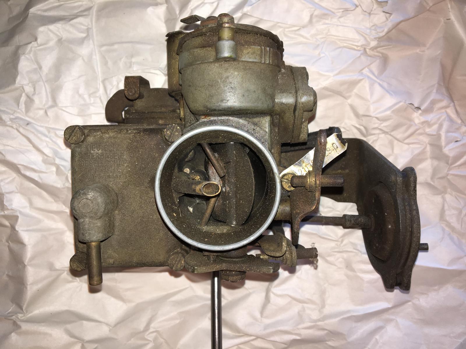

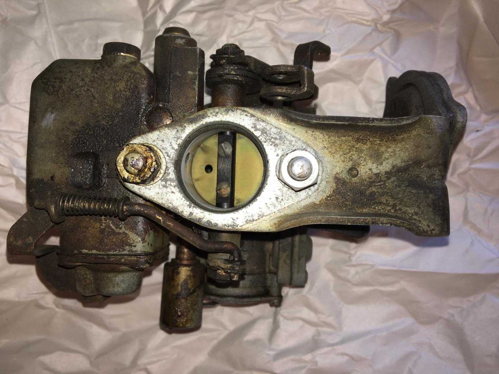

I'm not sure whether there is going to be a point to this thread, but I thought it might be useful to some people to see the steps involved in servicing/refurbishing a stock carburetor.
What might be interesting is that the carb in question is in pretty dirty condition, grime outside and inside. From the condition of the screw heads it doesn't seem to have been opened up many times, if at all. It's obviously well used and might end up needing the throttle shafts rebushed, as there is a bit of side to side play in it.
The reason I'm doing it is that I searched for a long time for the stock carb for our USA spec 1970 Ghia, with the twin arms for the throttle and the throttle positioner. Hens' teeth doesn't begin to describe them, but I eventually found this one on EBay. I'd like to bring it back to stock condition, so I'm prepared to have a go, however bad the carb looks!
The good:
Correct carb 30 PICT-3, will replace the H30/31 I have at the moment
Parts and jets all seem to be present, except the throttle positioner has lost one of the connection tubes
The bad:
The grime has stuck everything solid, so at the moment I can't get the top off, the choke off or the choke diaphragm. I've left it to soak in penetrating oil.
Possible rusty looking deposits coming out of the main jet access hole.
Some play in the throttle shaft. Might need rebushing, we'll see!
Starting pics just now, and I'll post up progress as I go (which might be sporadic!)

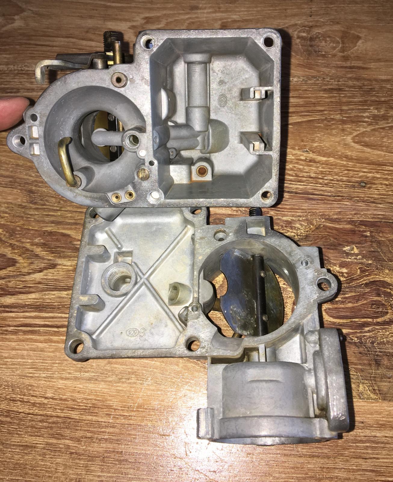

Thanks guys, that’s the plan, split it, soda blast and then zinc plate the steel parts.
I loosened everything up last night but it was still stuck together. Before I get out the BFH I’ll try soda blasting the crud off and leaving a bit of penetrating oil to loosen things up.

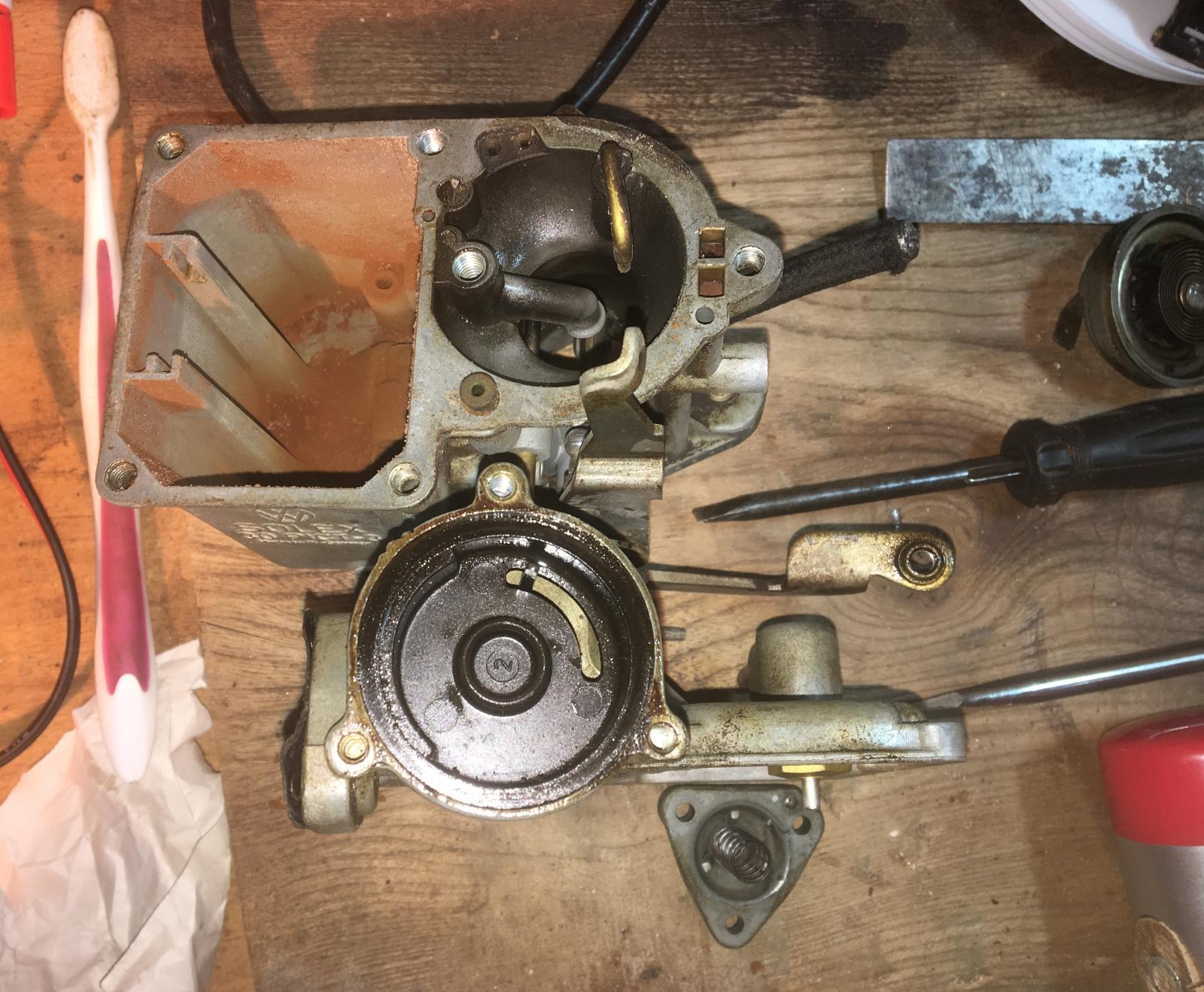

PostPosted: Sat Jun 23, 2018 9:43 am    Post subject: Re: 30 PICT-3 carb rebuild, from a poor start! Reply with quote

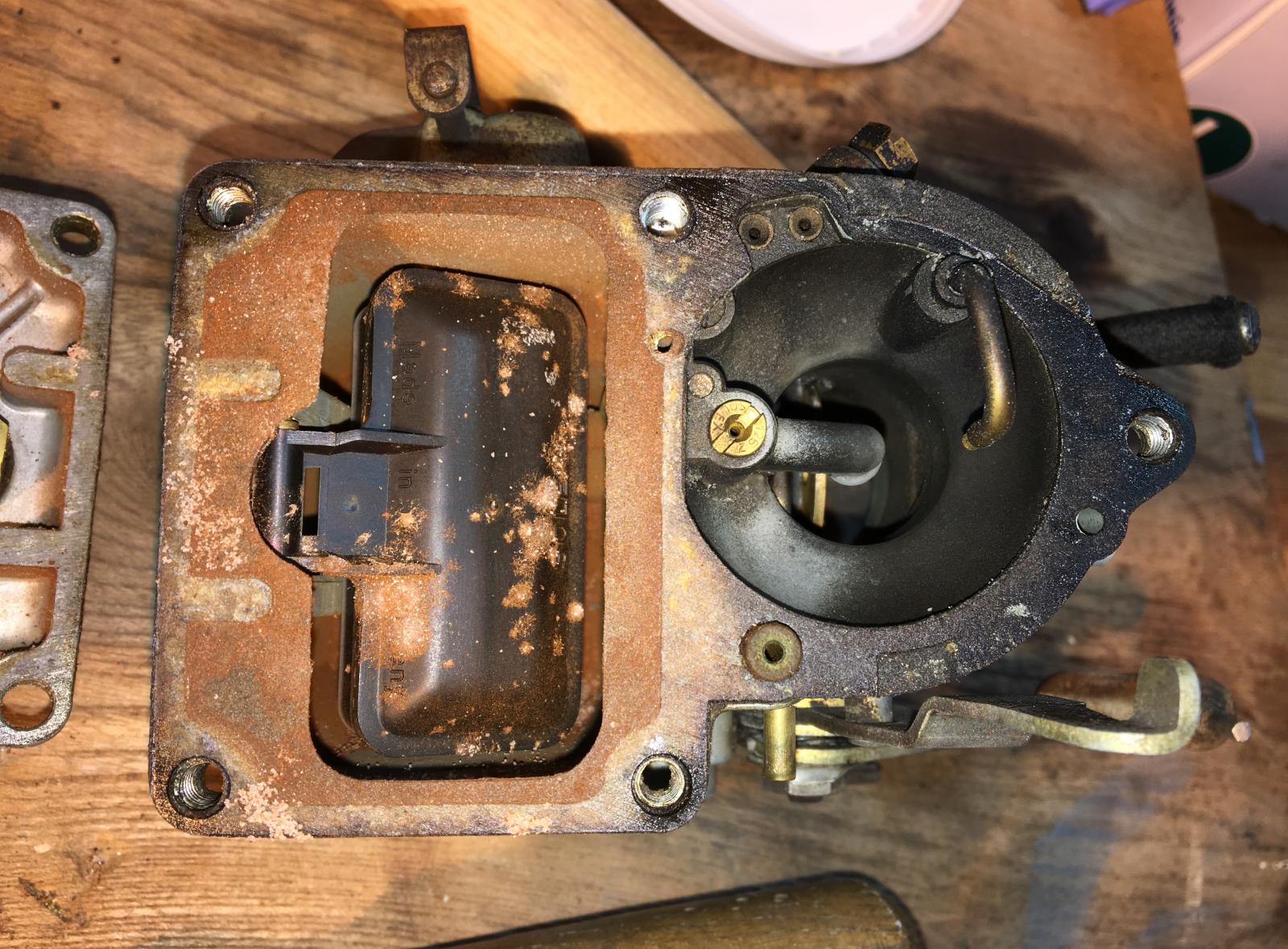

Still looking good. I gave the whole thing a quick blast of soda and the oil on the joints has freed things up.
Once the top is off, I can see that the float reservoir has a layer of rust coloured dust, but actually doesn't look too bad.
The main gasket is very cleanly indented, which suggests again that the carb has not been taken apart multiple times. The choke assembly and its diaphragm had been stuck, but the penetrating oil meant they could be knocked off with a soft faced hammer. Everything else disassembled fairly easily, the float valve fibre washer was stuck, and spilt on removal. I think the (German) rebuild kit has a metal washer as a replacement.
Does anyone know if this carb would have two check balls, or one?

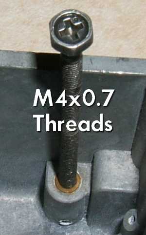

2 check balls like below. Not a 30 PICT 3 but the same check balls.
glutamodo wrote:
There are two check balls:
The inlet one in the bowl - you'll need a long M4 screw to which you can clamp a wrench to and tap on that to pop the retainer plug out:
The outlet side is here: (this is an H30/31PICT example but it's the same place on the 34PICT-3: You have to remove the dump tube/jet to get this ball out.

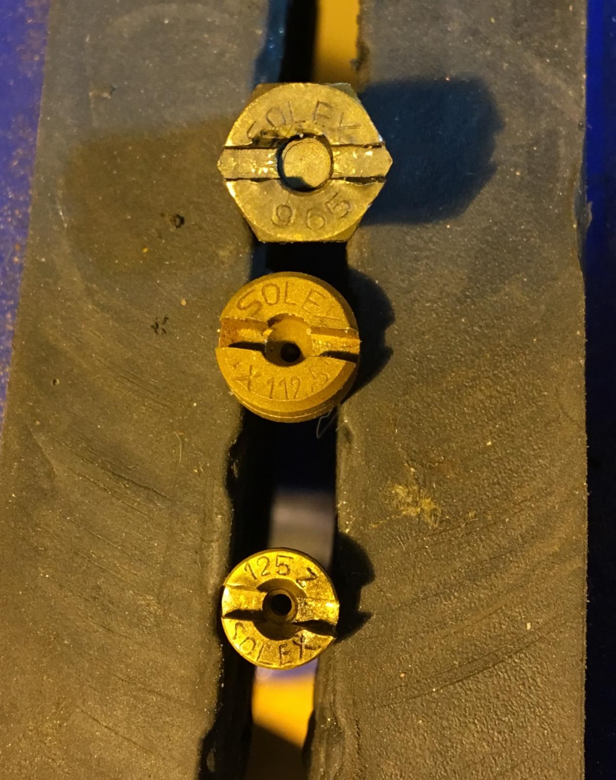

I don't know if this is answerable, but I'm not clear on what the difference is between, for instance:
A 112.5 and a x112.5 jet
65 and g65
And, is there a 140 and a 140z air jet
I think I've mostly disregarded the additional letters in the past, but maybe there is a significant difference?

They are the same size jets. When I rebuild carbs, I take them fully apart. They then are dunked in an ultrasonic parts cleaner with hot water and degreaser. It vibrates all the old fuel and junk out of the small passages in the carb.

PostPosted: Wed Jun 27, 2018 4:07 am    Post subject: Re: 30 PICT-3 carb rebuild, from a poor start! Reply with quote
Despite having the part number and the code for the bus, the carb has the same jets as Bill posted for a Ghia. I'll fine tune with a wideband when I install, but these jets should get me going!
I've managed to find time to continue with the cleaning, so the body has been soda blasted and lightly polished, and the small parts and levers etc will hopefully be plated this afternoon.
I struggled to get the throttle positioner arm off the throttle shaft. It looks as though it should pull more or less straight off, but it wasn't keen to move, so I left it in situ. Any tips?
