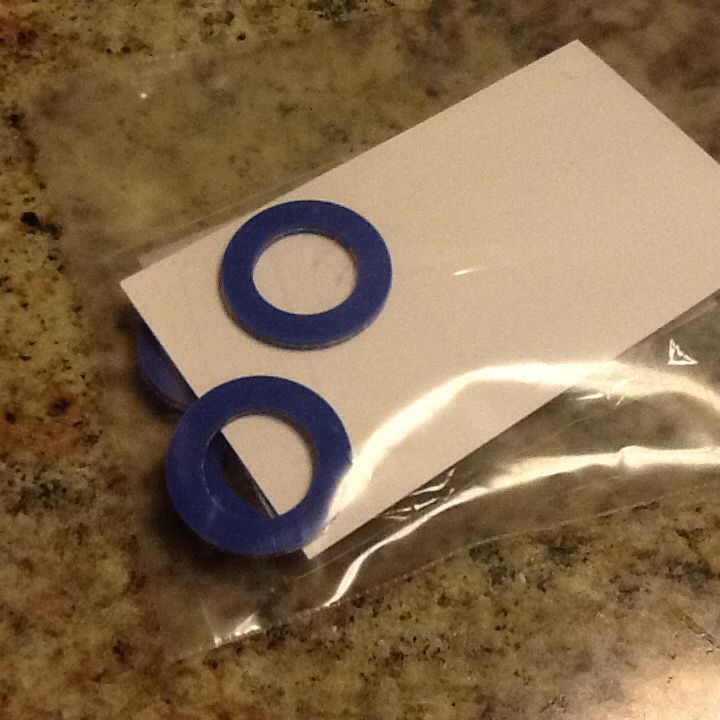

Was surprised to see that I commented on this thread ages ago - needed the boot and completely forgot this was here. Surprisingly, just bought the GeeBee set too and when I unpacked today there were a few blue rubber "rings" in the bag too.
Does anyone know what these are for?

Interesting. None of the parts I bought from him came with those. I got mine a couple of years ago though.

Maybe product samples for his other lines? Like how Worksberg includes a piece if his ABS plastic in his packages.
Did you email him directly?

Nope. I'll have to though! Lol

I bought one of everything he makes for the late bay.
Will put it on this weekend.
Found out, the blue rings are garden hose seals!
He said that he doesn't like to waste material.
How awesome!
