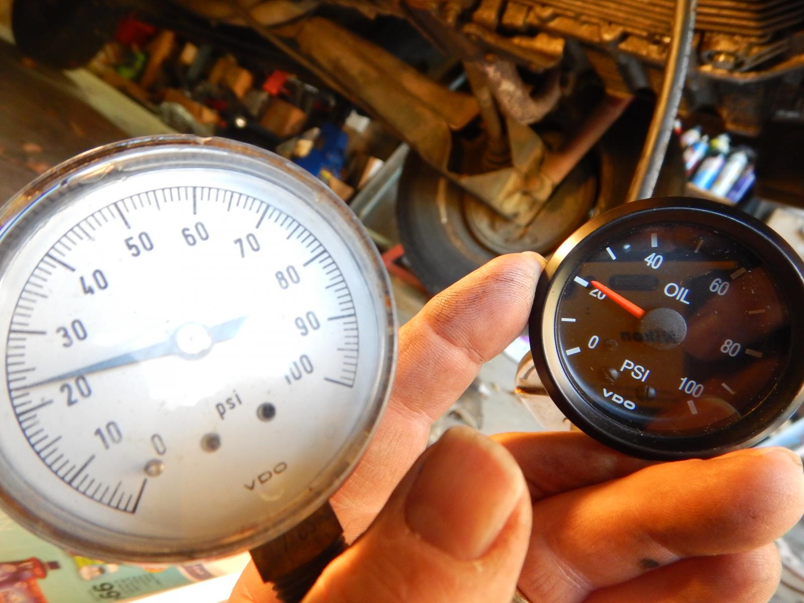

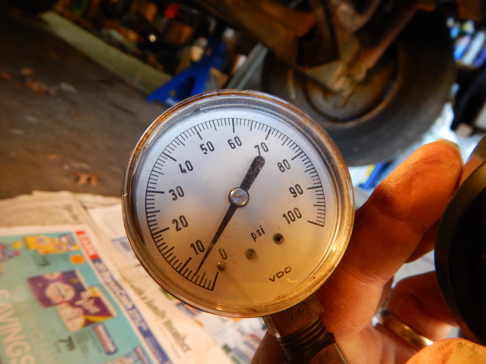

Anyway, as you suggested and what I had planned to do anyway, I did do oil pressure tests.
Here are the results (comments above photos)
Below is a pressure reading with cold engine with ambient temp at 70f. This is a made in USA VDO gauge with 1 psi increments.
Below is a pressure reading using a different gauge. The engine had only idled for about 3 minutes (brand new old stock VDO gauge)
Below is a pressure reading with both gauges after the engine was fully warmed-up and rad fan cycled one time, this is at 2300 RPMs
Below is a pressure reading about 30 seconds after the 2300 RPM run.
Below is a pressure reading about 40 seconds after the 2300 RPM run comparing the two gauges

What is your oil pressure at 3000 rpm and 2000 rpm?
Glad to see you do have the gauges! These oil threads can go for pages while the guessing at the problem without definitely knowing what the oil pressure is.
If I remember correctly at 2000rpm - 176°F you should be getting 2 bar or 28psi of oil pressure.
It's in there in the Bentley what the pressure should be at 2000 or 3000 rpm.
I haven't got the manual in front of me to give you the exact pressure.
If you do not have what the bible says then you might have a problem in the making.
I'd rather see at least 9psi at idle myself, but it does drop down low after a coming off the gas when it's hot.
Since you have the VDO in your hand I would run a new wire from the sensor to the gauge and see if the reading improves. resistance in old wiring can slow the speed of the smoke down as it travels through the wires from the sensor to the gauge.

I'll dig into the Bentley and study-up on Oil pressure. However, I'm leaning heavily on the culprit being an electrical issue as I stated previously.
When the engine is cold, the pressure is very high at idle (above 50 psi as can been seen in the first pic). So, when cold at 2000 RPMs, the buzzer and light go off.... no way is that associated with low pressure.

To be clear, both of the VDO oil pressure gauges are mechanical and screwed into a T that was connected to the engine between the push rod tubes.
Okay, I've read-up on the Dynamic Oil Pressure System. I found a pretty good write-up on the topic. I also dusted off my Bentley and followed the circuits from the switches to the cluster. They both go to the Engine Oil Pressure Control Unit (J114) inside the cluster. J114 also has a circuit to it from the Tachometer. Thus, the J114 uses data from all three that determines if we see a flashing light and hear a buzzer if pressure is below a set threshold/limit.
You could say the systems function on pressure and RPMs. I could not find any connection or association with engine temperature.
So, as can be seen in the first pic above, the oil pressure was above 50 PSI when the engine was first started (cold engine). But, when I revved the cold engine above the magic 2000 RPM, the flashing light come on and the buzzer sounded based on those pre-set pressures and RPMs as set forth in a previous post in this thread.
So, what's the problem?
1. Bad switch, even though it is new and made in Germany
2. Circuit issue of some sort
3. Engine Oil Pressure Control Unit malfunctioning
Keep in mind, the Van had never done this previously. It has a fairly fresh oil change (10w-40). It has 162k original miles (I'm 3rd owner). Lastly, when the issue appeared, the engine had not been started in about 10 or more days...
Lastly, as I stated previously, the oil light quit coming ON several months ago when the ignition is first turned on. Now, with the two new switches, the light comes on for less than a second. This would seem to indicate there is something going on other than oil pressures..
Hopefully, I can get back to it and run some ohm tests on circuits from the back to the front, check connectors, check the big cluster connector, etc.

Well, I get it as to why there is a dynamic oil pressure sensing system and how it works. No problem there. But, considering that both the light and buzzer can be prompted to go off at 2000 RPMS with a cold engine having a known oil pressure in excess of 50 PSI at idle tells me there is something else amiss.
I did check the two sensor wires up to that first connector. They are both in good order.
Not a daily driver by any means. That's why it had been sitting and not started in over 10 days.
I'll report back after more investigating...
