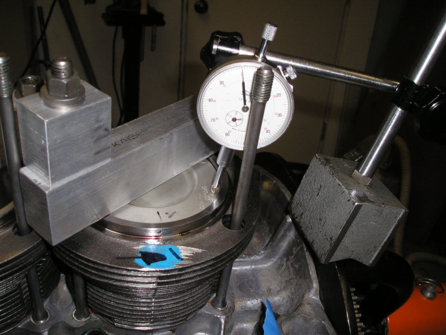

-Following Rays' advice I measured deck height of each piston without rings on each cylinder with no shims under the cylinders and got a very small reading of .002 deck height at top dead center.

Is that .002 INCH or MM?
.002" is almost flat with the top and is low.
The measurement is taken with the cylinders torqued down because that will change the measurement, and also taken at the wrist pin to avoid rocking the piston.
Here is how I hold mine down when I take that measurement. The aluminum blocks came from a metal surplus store, and this dial indicator is only to be sure I am at TDC. Th e first time I tried it with some sockets etc but could not get a stable reading - also didn't want to break a fin so I made these blocks. you can stack feeler gauge blades together to get close to what the deck is. There is not one measurement that is perfect. A slight difference isn't going to get you into trouble. If you think it is say .080" and it is actually .078" you won't feel the difference nor will the engine. What ever shim you decide on will end up being used on all the cylinders. Sounds like one head has been flycut a little more than the other. 47 CC is way below average which I think is around 53 to 54 CC.
