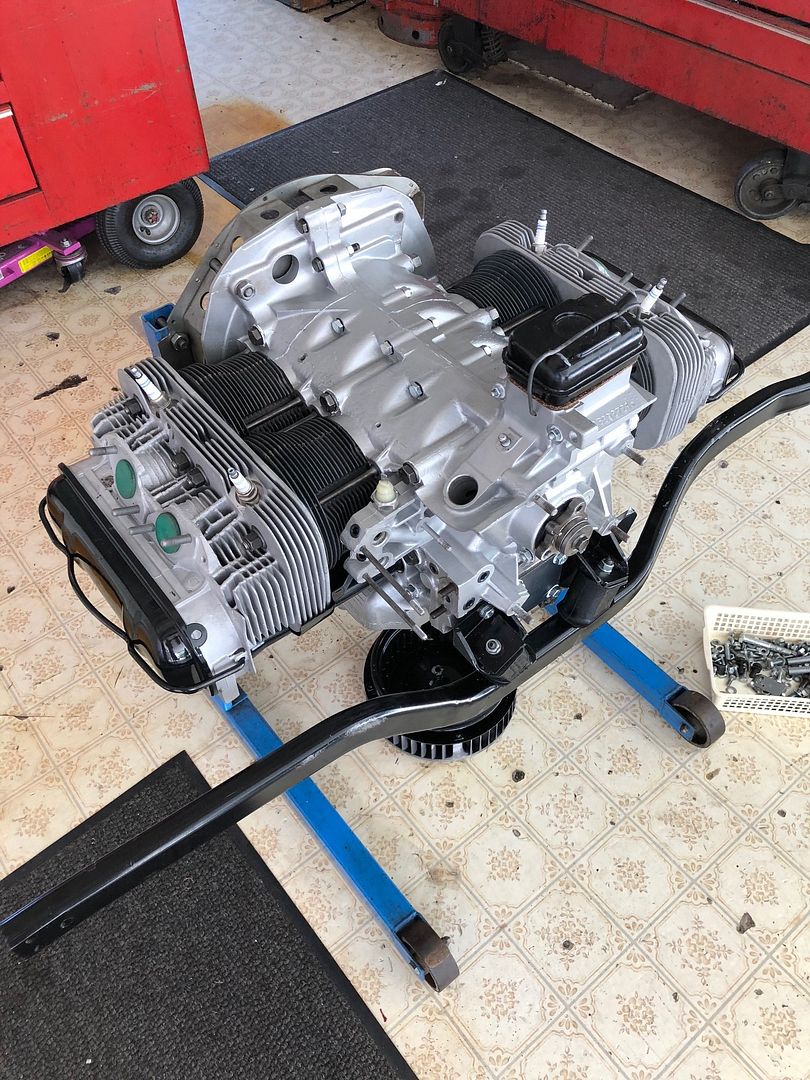

It's been a few weeks but I finally got my 72 1700 type 4 engine back together.
I had found low compression all around so I decided to do the piston rings. My engine originally used sealing rings at the top and bottom of the cylinders but I ditched the ones on top and lapped the cylinders to the heads. Before ever starting the engine I did a quick compression check and all cylinders were at least 90 (I know compression cannot accurately be measured this way but I wanted to ensure I didn't have any huge mistakes).
Today I got the chance to start it up, however it developed a knocking sound that increases and decreases with rpm. During my rebuild I only did the rings and never split the case which is why I'm hesitant to think its crank-related. The engine also ran and sounded great before the rebuild. Also removing the top sealing ring would raise the compression ratio but I was running 91 octane so this shouldn't be a problem. I've also gone back and checked all the valves. I'm far from an expert mechanic so please feel free to suggest anything.
