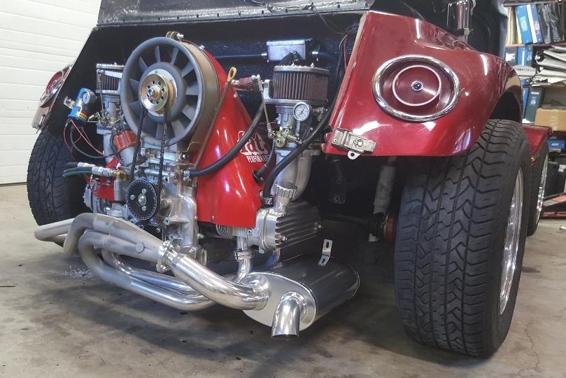

PostPosted: Tue Jul 31, 2018 4:06 pm    Post subject: Re: How much HP do is really need for a Non Race bug and be happy Reply with quote
I guess it all depends on your comfort level. I also am running a 2.0L 914 Porsche. Bored and stroked to 2650cc. 187HP 200 ft/lbs torque 8.5:1 compresion. You want to feel something pull this is your car.
1400Lbs buggy with a heck of a lot shorter wheel base. The car demands respect as things can go south fast.
To date I've had it up to 200Kph (124 mph) still pulling.
So, is it enough you ask? Hell no!!!

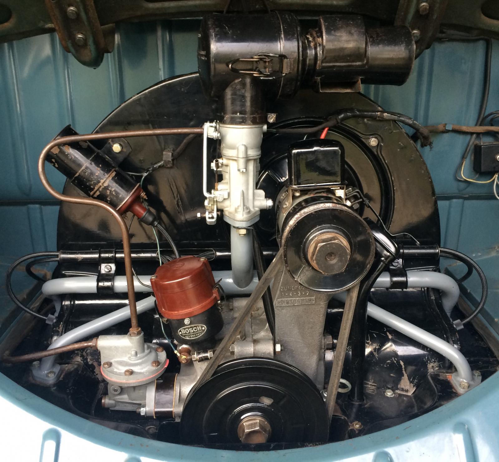

PostPosted: Tue Jul 31, 2018 7:53 pm    Post subject: Re: How much HP do is really need for a Non Race bug and be happy Reply with quote
A split window Bug with a 25 horse engine can do 65 MPH. 90 HP is plenty for any public roads here in the USA. A Berg 5 speed like Glen has really changes the drivability a lot more than increasing the HP.

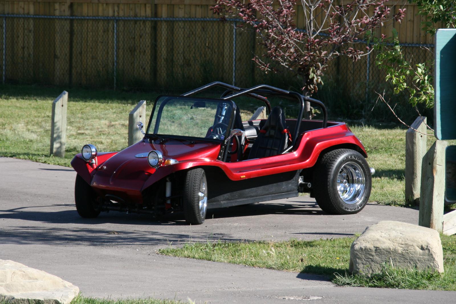

PostPosted: Tue Jul 31, 2018 8:26 pm    Post subject: Re: How much HP do is really need for a Non Race bug and be happy Reply with quote
I have about 110hp at the wheels (mild to medium built 2084) in 1400 pound fiberglass buggy...
Its been up to any challenge...
THis was my auto-x car... Honest 120HP at the wheels (per chassis dyno) with 2180 and car weighed in at 1360 pounds...
It all comes down horse power to weight ratio, and how many $$$$ you have to spend....
