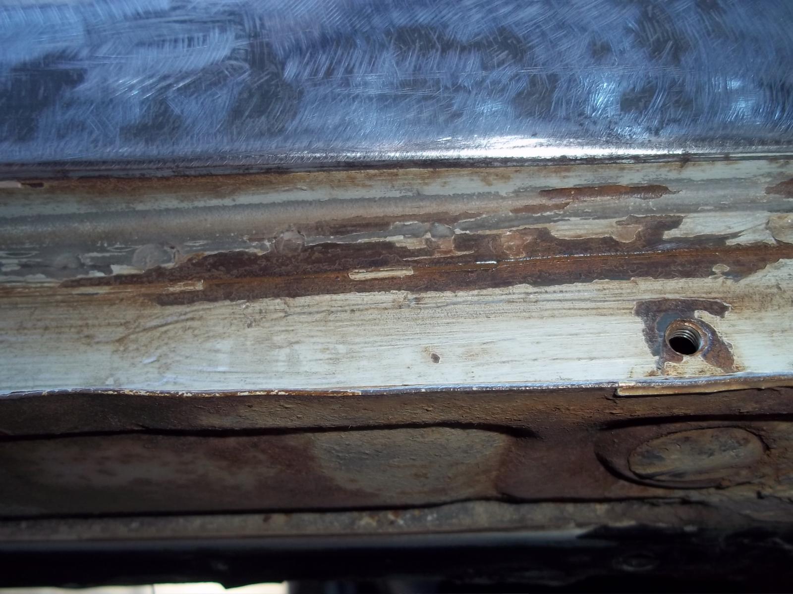

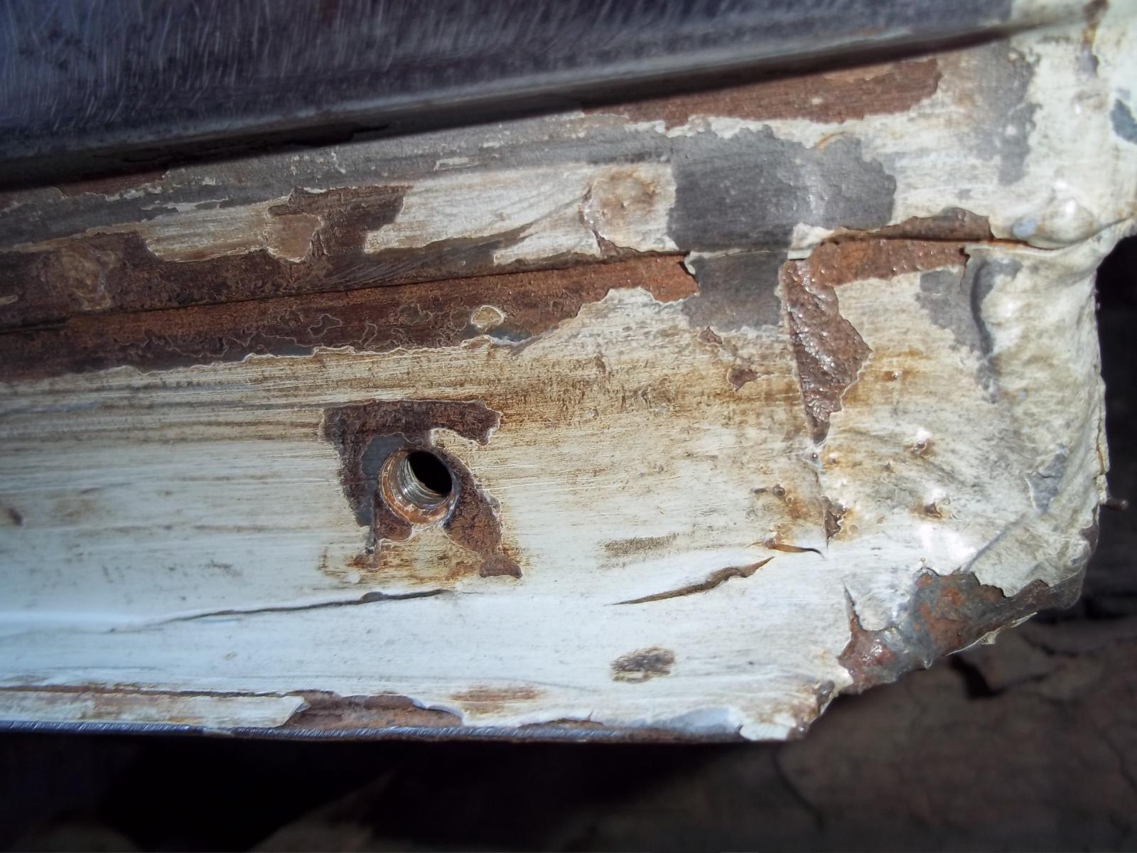

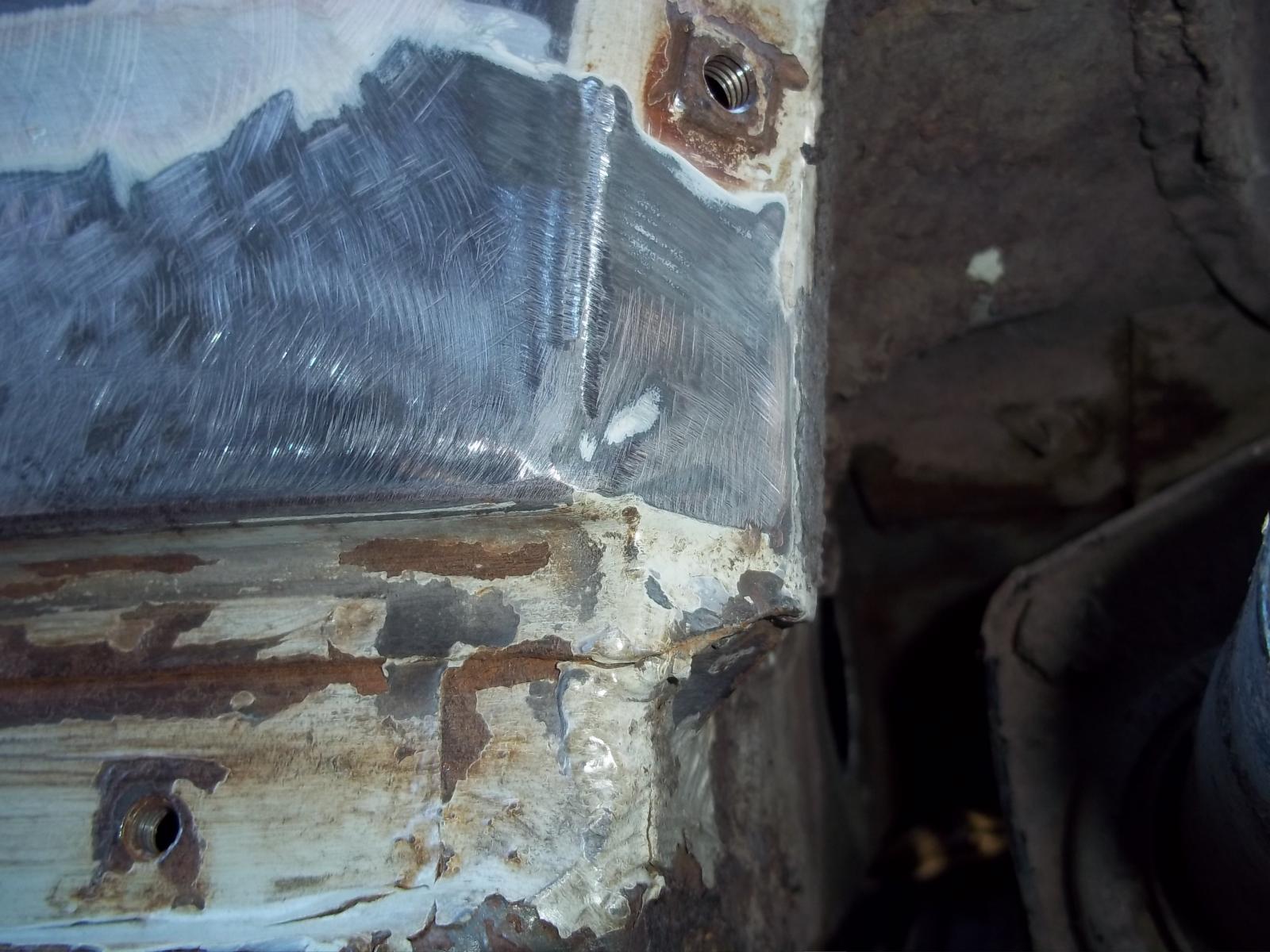

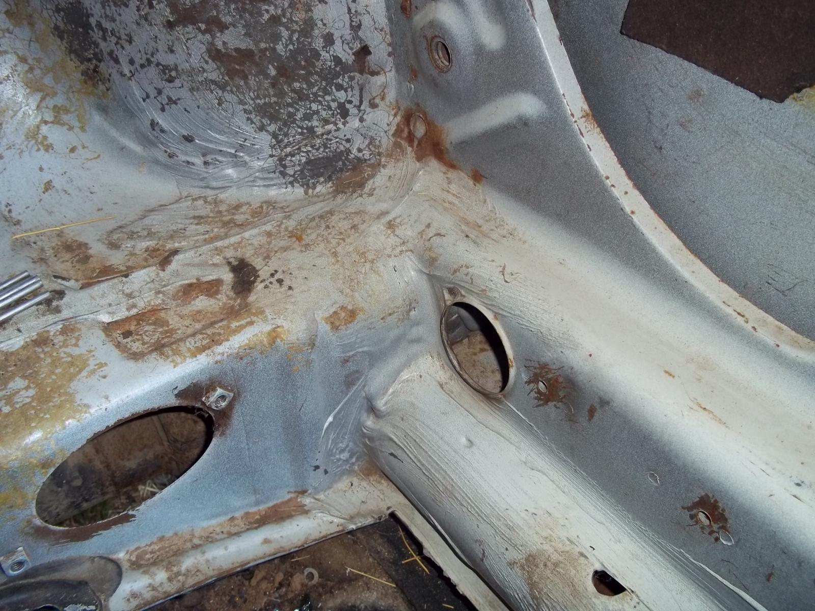

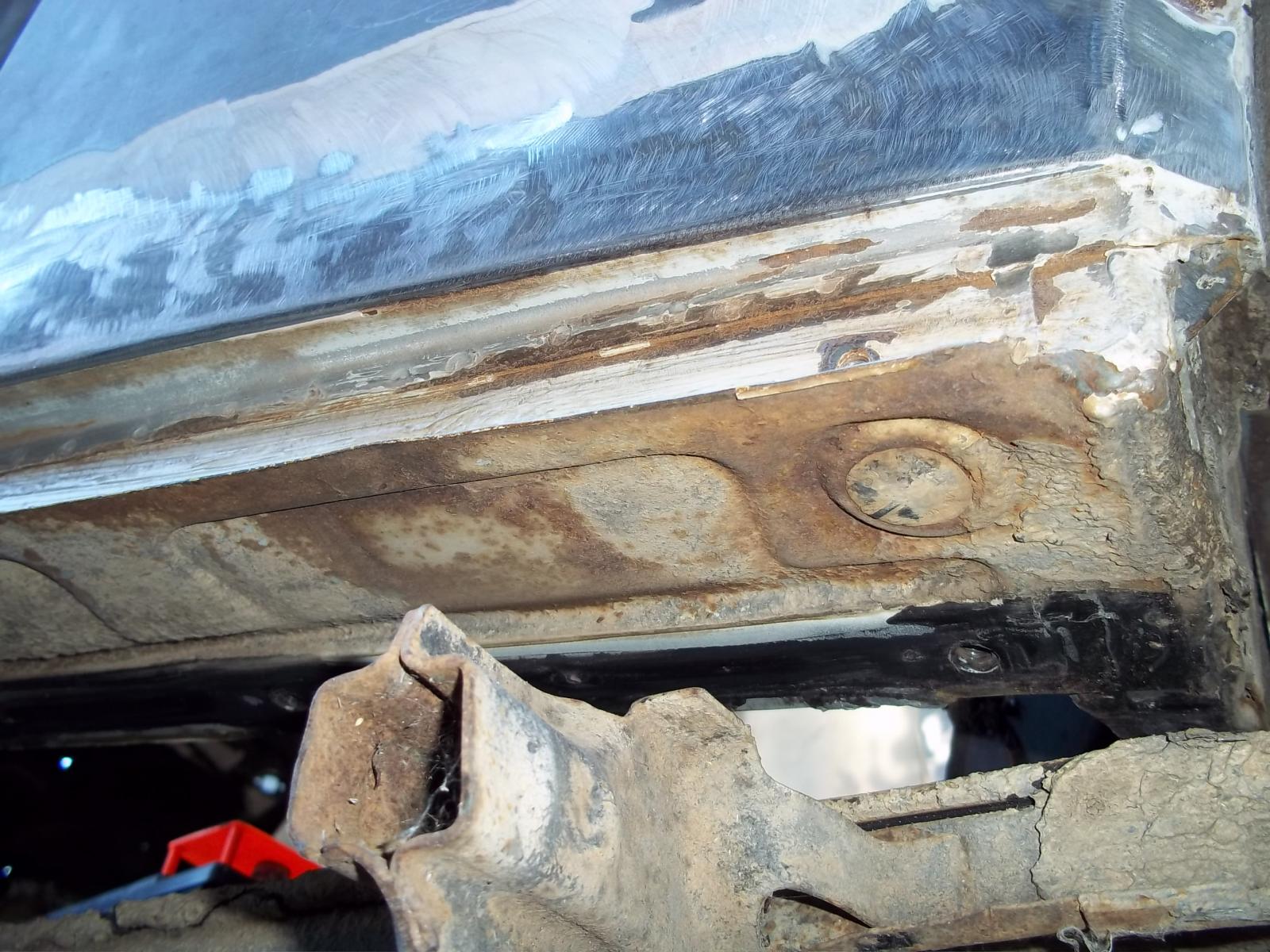

hoping you can hold this up to a mirror because these photos are of the left side . . . hope it will help ya . . . I'm guessing the last one is what yer asking for . . .

BTW . . . FYI . . . your repair panel is a one-size-fits-all kinda deal . . . It has an extra fender bolt hole . . . the bottom hole is for early models (like on my '62) . . . your 1969 lower-most fender bolt (should) go through the second hole from the bottom . . .
