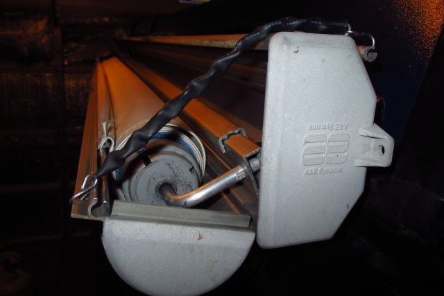

I had the same issue. The case just barely rubbed on the top of the sliding door. I had a couple of short cam lock tie down straps that I used as extra insurance to keep the case from popping open on the highway. 1 near the front and 1 near the back. I didn't trust those stock closure clamps to stay shut.
I wish I had a picture, but when I deployed the awning, I would put the straps back on, and tighten them just enough to pull the case up slightly towards the closed position. This kept it from touching the door. I guess I probably could have solved the issue by adding washers to the mounting brackets as mentioned previously, but since I had the straps there anyway, and it took 10 seconds to do, it never bothered me.
Mine, at the aforementioned link:
Replaced with:
But I also still use the cam straps, like you, for double-security duty for the case when the awning is not deployed.
Were there supposed to be straps on these units form the factory like you show ? Good Lord, I don't have naything like that, I've just been opening the shell and using it as is with the awning tension pulling on it.

metropoj wrote:
Were there supposed to be straps on these units form the factory like you show?
No.
The second owners used their own method, drilling small holes at each end of the tray and running small ropes from the tray to the plastic tabs at each end of the case. The ropes dry-rotted and at the same time, I had a clip pop loose while driving (turned out it was bent out of shape & since repaired), so I killed two birds by using the cam straps. After a few years, the straps became too worn to hold the tray, so I made chains. Next iteration will be a semi-permanent chain inside the case at each end... or perhaps swap the whole thing out for an ARB.😂 (Update 2019: Next iteration was installing Fiamma awning mounting brackets from RMW: https://www.thesamba.com/vw/forum/viewtopic.php?p=9150588#9150588 Very Happy )
The straps/chains are utilised simply because the tray rubs when open. If your tray doesn't rub on the sliding door when you deploy the awning, you're all set.
