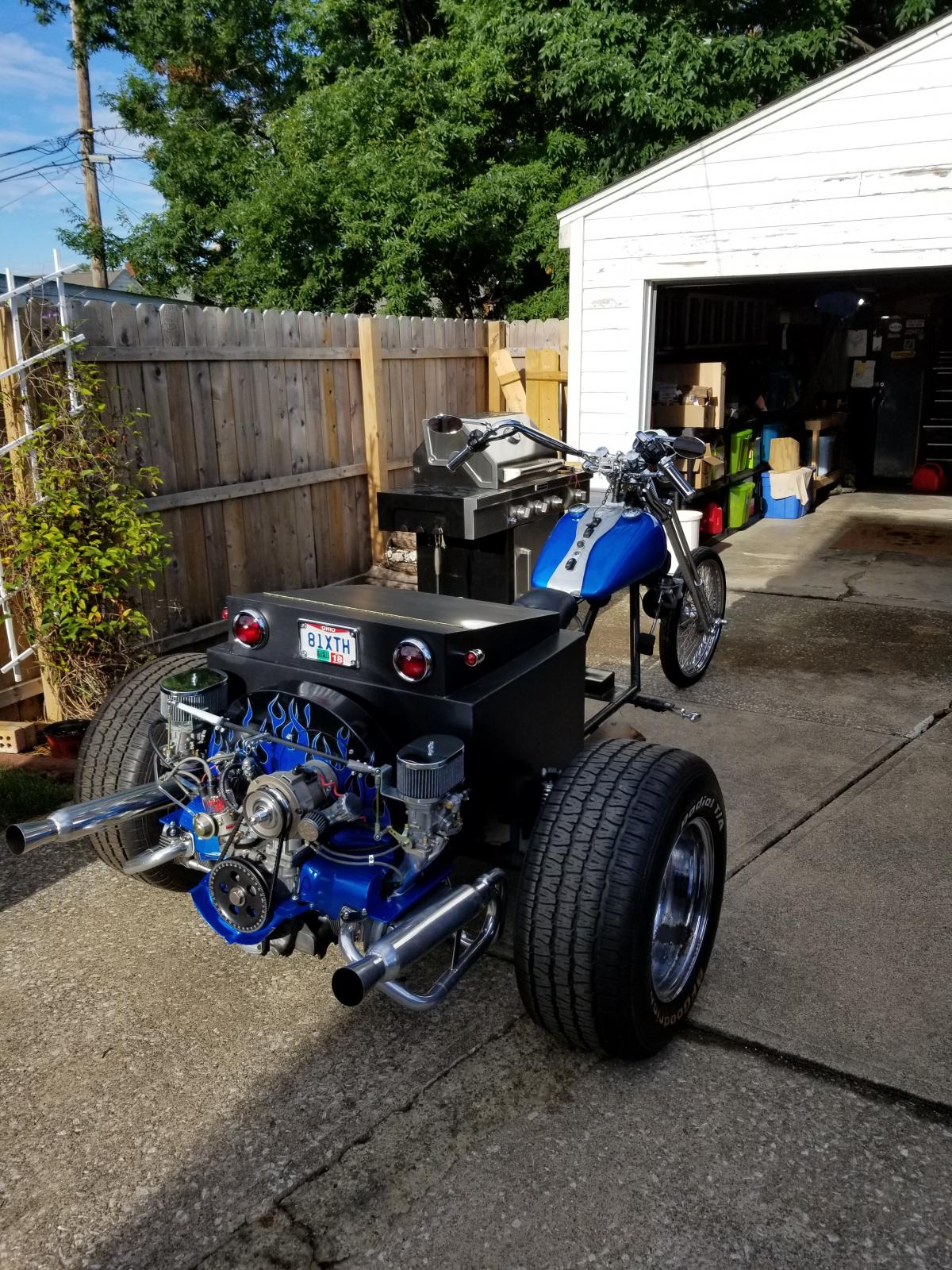

Trike Ike
Joined: March 29, 2018
Posts: 23
Location: OH
Trike Ike is offline
PostPosted: Sun Oct 07, 2018 12:26 pm    Post subject: Re: VW trike engine size Reply with quote
Hello, just as a 2 cents reply my well balanced trike had a single port stock 1300cc for years and it was so much fun. Able to u-turn on a two lane road and corner faster than some autos. It wouldn't tip, I tried. It was a frame built in 1975. Very well balanced and had enough power for the roads. I've recently rebuilt it.
