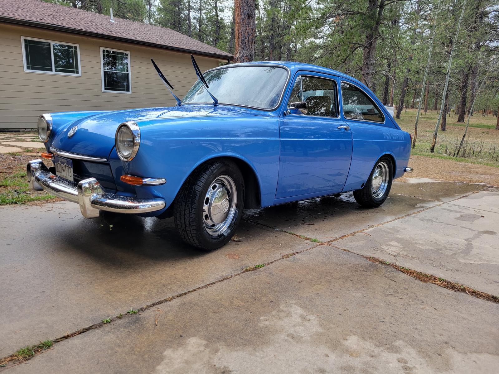

Hi,
I've been on/off samba for almost 20 years, but been turning wrenches more on my fastback and instead of taking over the What did you do for your Type 3 today? thread I figured I would start a clean thread with just updates and pictures on this car.
A little bit of background on the car, back in Feb 2008 I bought what was mostly original a 1970 diamond blue fastback. Except for maybe carpet replacement and few missing bits appeared to be mostly original example of a fastback. It was a clean car, with original paint, few dents and dings, but nothing that was altered in a major way. Still had a fully functional FI and most of the original AC except for missing compressor and part of the dash unit.
My plan was to maintain, and fix bits and pieces that were either missing or needed attention. Later on I had quite a journey with FI and a multi-year hunting of the FI issues 70 FI will not stay running. Long story short on FI was the need for new wiring harness and trigger points for the injectors. It was thanks to the Type 3 community here that I was able to get that resolved.
Over the last decade fastback took a back burner seat with buying and rebuilding a home, starting a family. About a year ago, I finally built a garage and was able to get a bit more time into VWs, not a whole lot, but an hour here and few there. I figured let's get this back into shape and keep it a rolling project, maybe turning into an occasional commuter.
To tally up recent things
1) replacement of transmission end-drive seals. A while back I had transmission lightly rebuilt, a few syncros and end drive housing had to be replaced as it didn't hold the bearing. Apparently the seals for the axles were the thin kind and leaked like crazy. When I got to them, gear oil was pretty low and it was an oily mess.
2) getting dent out of the hood
2) front trunk cardboard replacement. I started to redo the front, but this will need to pause as I need to clean up and close up all the holes from the
A/C system. I will post pictures on this a bit later.
3) door regulators. Passenger door window would not roll down. I ended up taking it apart, getting new clips for the regulators and door cards. The main pitfall was due to the window channels hardening up.
4) replacing a horn. This one was wild as I had dual horns and they no longer worked which turned out that one of them in certain position would make both not sound.
5) replacement of FPR, I've been getting annoyed with having to either bump the key like 6 times to get the fuel pressure up or having to start it twice after sitting for a few hours, so on with a new fuel pressure regulator only to arrive at the same point. Need to check if injectors or coldstart valve are leaking, or maybe new FPR does not hold.
this is how we hold the FPR while tightening the nut on the front side of it...
So the plans are to get all the holes from A/C welded up, I've already made a good progress on this this week. Get interior freshened up, tighten up small bits and then get new 1776 built for it as a stand in while original engine is rebuilt. (it's a bit low on compression and needs exhaust valve addressed).
Stay tuned!
