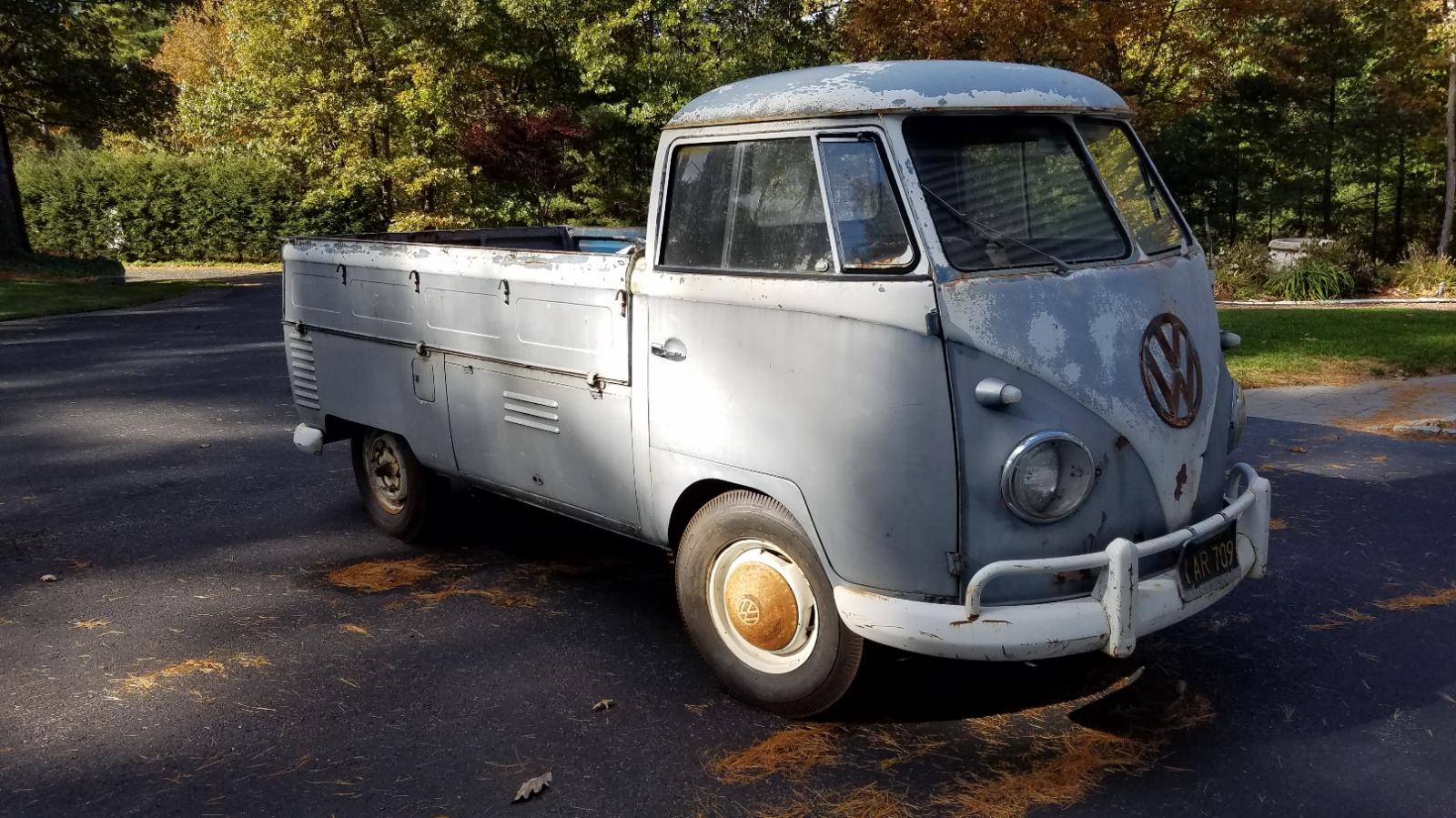

This will be the “build thread” for my ’56 Single Cab truck that I bought last month. Although, I’m not exactly building it, I am “Preserving” it. Back in 2010, guy from the UK who’s samba name is “Last Triumph” found an Oval Beetle in a barn and did something that I found to be inspiring and groundbreaking. He completely disassembled the car, cleaned and “preserved” everything. Replaced seals and made things 100% mechanically perfect. But if I remember correctly, he painted nothing. The 76 page thread is here:
And I am not really into naming my cars BTW, but a friend in California gave it the nickname “Lori” (a la UK “Lorrie”) and it kind of stuck.
I am adopting a “Paint nothing” mantra with this single cab as well. Well mostly, read on. My plan is to go over the truck entirely and preserve everything. It has its original engine which is one of the things that attracted me to it. And patina everywhere. And it is very well used and dented and bent in a lot of places. But I am not going to allow myself to straighten anything either, unless it is needed to restore function. As I’ve started to go over this truck I am realizing that this damage is part of its history and character.
I will replace all seals and will probably paint the treasure chest floor with some kind of rust inhibitor. It is pretty solid and I want it to stay that way. I will also use an epoxy trick to close up the few small holes in the cargo bed as I don’t want any water to leak through, and then clearcoat it. I will pull the engine in a few weeks and start a rebuild. Yes, I know the bumpers are not correct, I am looking for some nice patina’ed original ones (Anyone? Anyone??)
And I will be driving it next spring.
So lots of pics and details coming, and lots of questions too! I have owned Beetles for the past 38 years, but this is my first type 2. Really cool truck, and I love the simplicity of it.

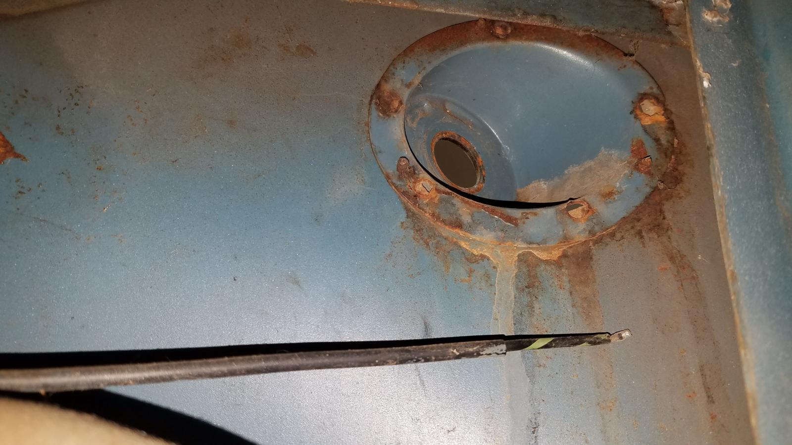

Ok, here is the first question/mystery. Aren't the bullet mount "hats" supposed to welded into the nose skin? Mine aren't, but held in place by some very small, low profile head, slotted sheet metal screws. No sign that I can see that the nose skin was replaced (tell me where to look to tell???) and the metal around the lights on the backside is perfectly straight.
And there are other big holes in the flange on the mounts that you can see on the backside, maybe from spot welds being drilled out?
Any ideas??
Any ideas??
Man if I were you, I’d start diggin on them pillars for some buried semaphore treasures. Lol

PostPosted: Mon Nov 05, 2018 10:12 pm    Post subject: Re: The Preservation of Lori Reply with quote
Interesting you mention that because it is missing the brown bakelite box flasher that was used in '55-'57 Beetles that had the first bullets/flashing turn signals, I presume that buses of those years used them to? I restore those so I am familiar with them, and why they need to be so complex. OTOH, lots of people gave up on trying to get them to work and cobbled in some kind of auto parts store tin can flasher, which is what this SC has now...

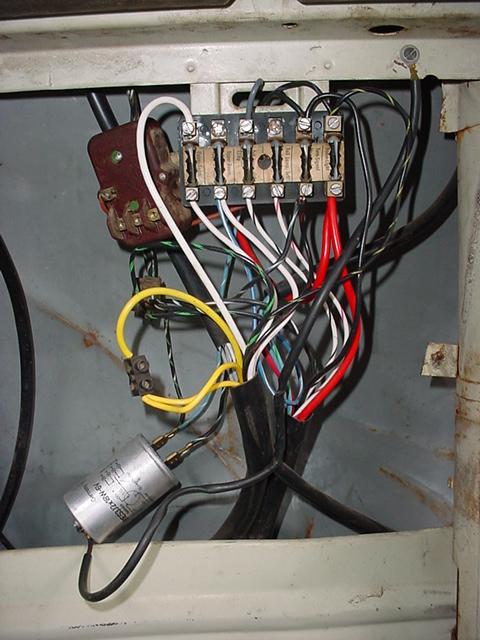

Here ya go John, I stole this photo from another esteemed John also known as "hazetguy" who just posted it in another thread on wiring. You can clearly see your brown bakelite flasher unit in place. The photo address is below, not sure how to make the photo post up here though...
Bill Bowman
Thanks, at least I can see how it is mounted. Typical in that pic though, they have unwired it, and cobbled in a "can" flasher.

johnshenry wrote:
Bill Bowman
That's exactly how the flasher was mounted in my '56 (built Aug/Sept '55). Wish I could find a pic of it. I didn't know what to think when I first saw it...this cool-looking box hanging obliquely off the side of the fuse panel...at first I thought the previous owner had wired in some aftermarket thingamajig...
