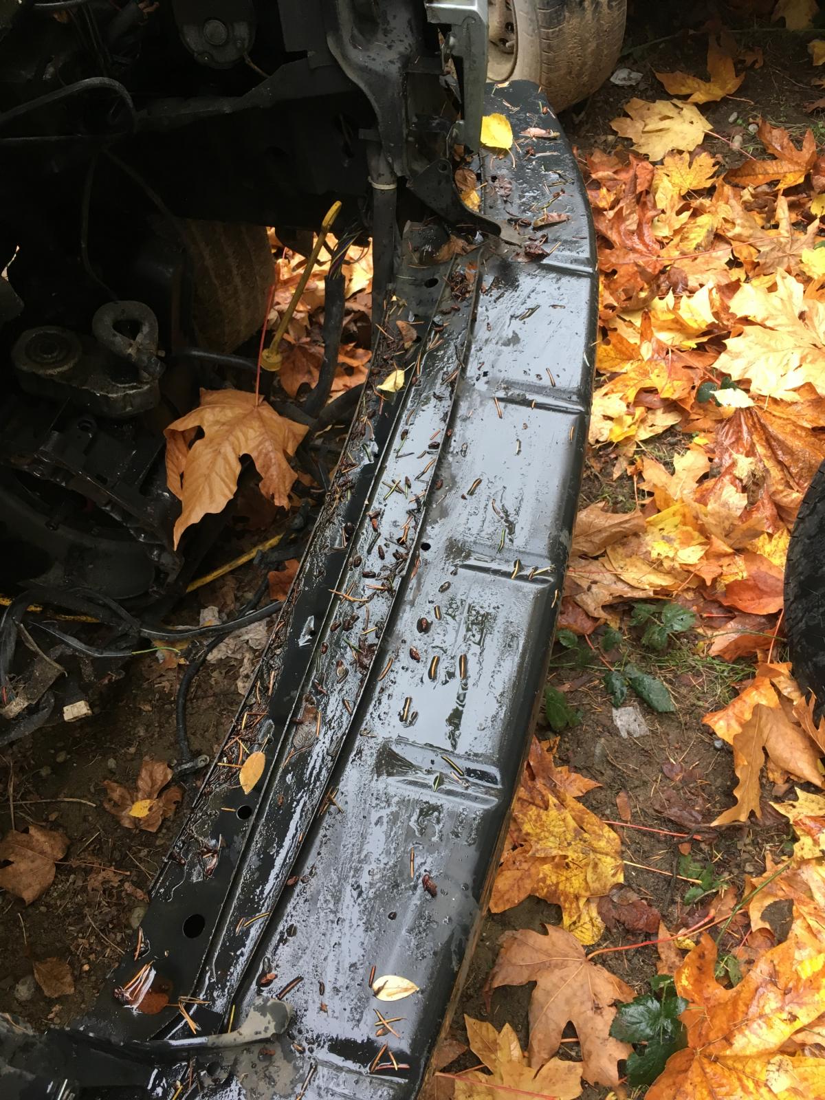

Here's the extra metal on the end of the bumper from both angles, from a parts van. The first time I pulled off an early bumper I noticed that the tow loop, that is visible out the front of the bumper, was bolted through the orignal tow loop that is welded to the bumper. That's my van by the way. I'd love the shorter bumper, but I just coated mine.

Thanks Josh, pictures always help! Nice van.
