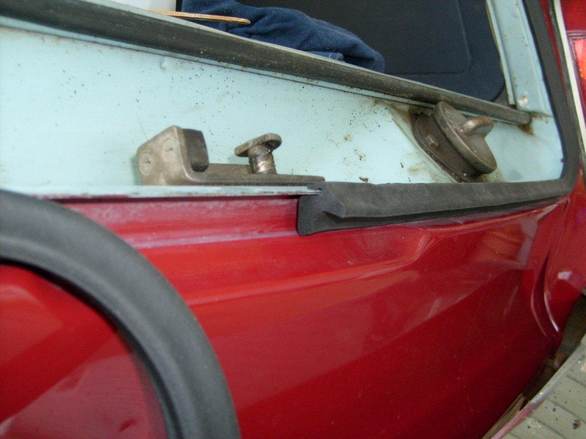

what type of adhesive should i use to glue a tailgate seal in with.
when my resto was done they put the seal in with contact adhesive
(the yellow stuff thats used on laminate for benchtops in kitchens).
and they put the seal on with the wrong side facing out so it leaked.
so want to do it the right way round with the correct glue......

PostPosted: Thu Nov 15, 2018 11:48 am    Post subject: Re: Cip1 vs ISPwest door seal kit Reply with quote

PostPosted: Thu Nov 15, 2018 11:54 am    Post subject: Re: Cip1 vs ISPwest door seal kit Reply with quote
We've always used this:
https://www.vwispwest.com/MMM-08001.html
There is a black available as well but I've never used it.
Make sure you install your new seal like this:
