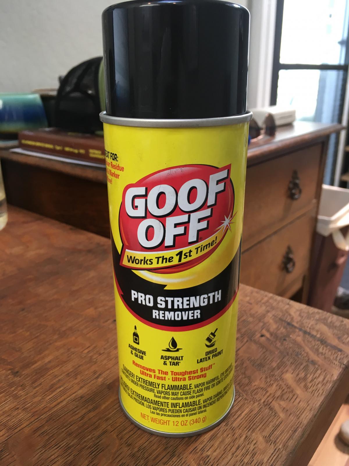

I've tried acetone (dangerous I know), Goof-Off w/ scotch brite pad, hand sanitizer, and simple green. Nobody ever sits back there so I'd rather not drop the money on new covers. I'm already many thousands over budget on this car plus, the covers are in great shape with no rips or holes. Thanks for any ideas.

Goof Off in the aerosol can worked the best if you scrub right after applying it but it wont be 100% removed. All the nooks and crannies of the basketweave are too much. I've got some SEM vinyl paint in the mail. Oh well. Thanks for all the advice.
